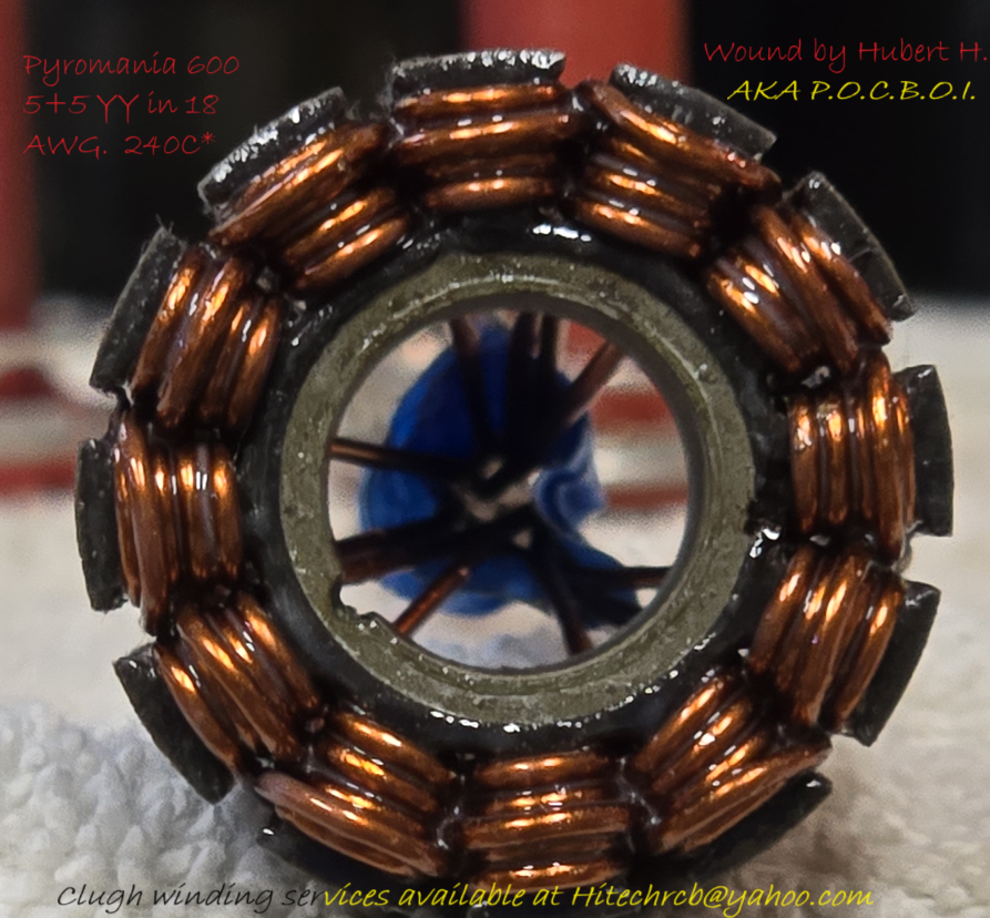

do you see here where you stole and used my wye bundles to open air idea here? Its intellectual borrowing at best and stealing at worst especially since you tell everyone I'm nothing but a pure theorist. Here is a bad implementation of my idea as the wires in the middle get hotter than the two at the end. Twisting is better because it ensures all the wires get equal access to cooling air. before you steal you should ask the inventor how to implement it the right way. If you wanted to lay them flat for aesthetics Learn to braid. It is a POC thing.... If you want square you need to learn to box braid u need more than 3 strands. I dont think a German can truly teach you this African art that existed 2000 years before Christ walked the earth but I can😶 .... passed down from generation to generation Just like you Litz hardly invented the art !

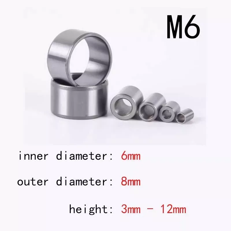

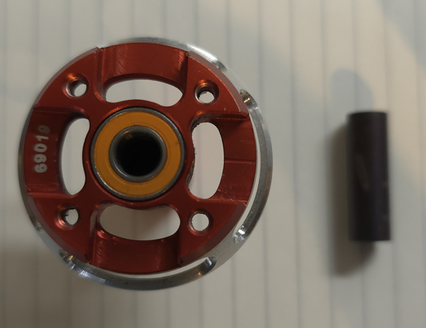

I have some brand new 6 x 8 x 500 micron shims on order and changed up things a bit. Some of the original master build 3 bearing setups for the Brenner contra drives have hardened sleeves that are in SAE sizes which works but I went ahead and purchased stainless metric 6mmid 8mm od bearing sleeves similar to these in the right length. What all this does any way is distribute the axial load across the 3 bearings. I also ordered fresh lock collars and grubs. Even though I give you new bearings in a full rebuild. I'm going to show you the old ones only need be cleaned and re lubricated with a roll test example on you tube....🙈🙉🙊 More truth video to show you versus Powercrocos incorrect statements about it is on its way...

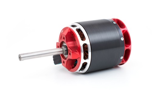

Pyro 650 with 3 orange seal SN134 ceramic hybrid ball bearings
