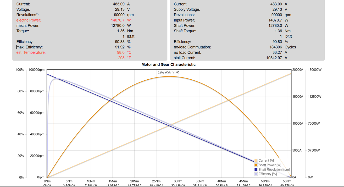

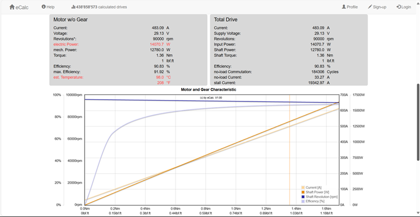

            Click image for larger version  Name:	15392.png Views:	0 Size:	297.6 KB ID:	431895 1/2 turn 1539 diameter 40mm 90,000 RPM! 8s lipo
            Bei 68% Eta und Temperaturen über 200 °C gibt es für 14 kW viel zu lernen

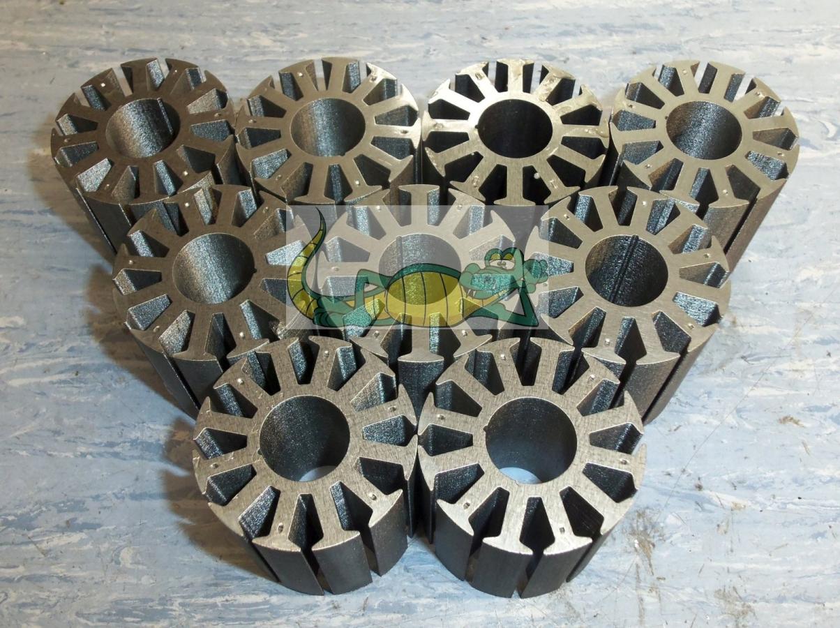

                  #4408

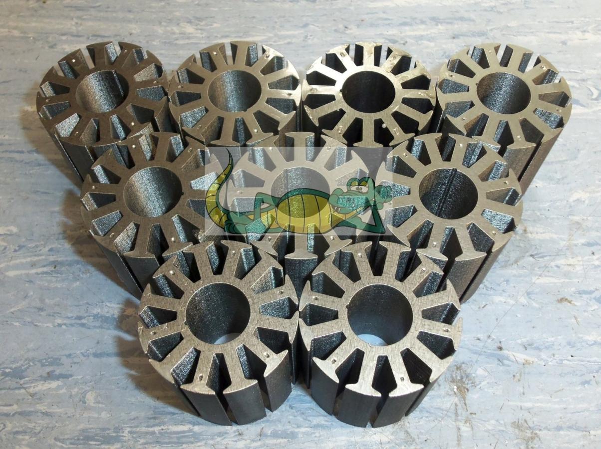

                  "The motors have a diameter of 62mm and - depending on the conversion - up to 95mm in length.
                  Because they are specialized for use in speed flight, they were designed rather airy for cooling reasons and not trimmed for power density. Therefore, the weight of 880-900g is comparatively low compared to the volume.
                  In the following, I refer to the motor for the FAI_Weltrekordreglement, which is designed for 35V.
                  There are several individual pieces of these.
                  They were and are probably still used on large speed models such as the large "Typhoon" by Dr. Marcus Koch and the "Hyperspeed" V1 and V2 and the "HCB" by Alexander Grimm.
                  The stator consists of 0.2mm thick SiFe sheets.
                  In the case of the individual pieces, there are "normal" variants with dimples and more or less insulated, glued without dimples, which have also been freed from the small punching burrs in a phosphoric acid bath.​."
                  ~ Dr Ralph Okon 2/23/2022 ~​
                  So again are the new stators indeed plan B material Dr Okon? Because they are indeed dimpled, not insulated, and definitely not glued together. What is all the excitement about?
                  BTW the 90,000 rpm 45 mm castle 1721 is 819 grams. Lukes 2260 LMT is a shorter 45mm drag machine and even it can peak 20 kW at very high efficiency levels Ralph. The BLDC power systems available in the USA today are hardly utilized for speed flight but they could be at any time. Windings are available at considerably less than a milliohm of resistance 100% of the raw materials can also be directly sourced from the USA as well. With a winding factor of 100% and ultra low resistances, they are designed for maximum power and torque density!

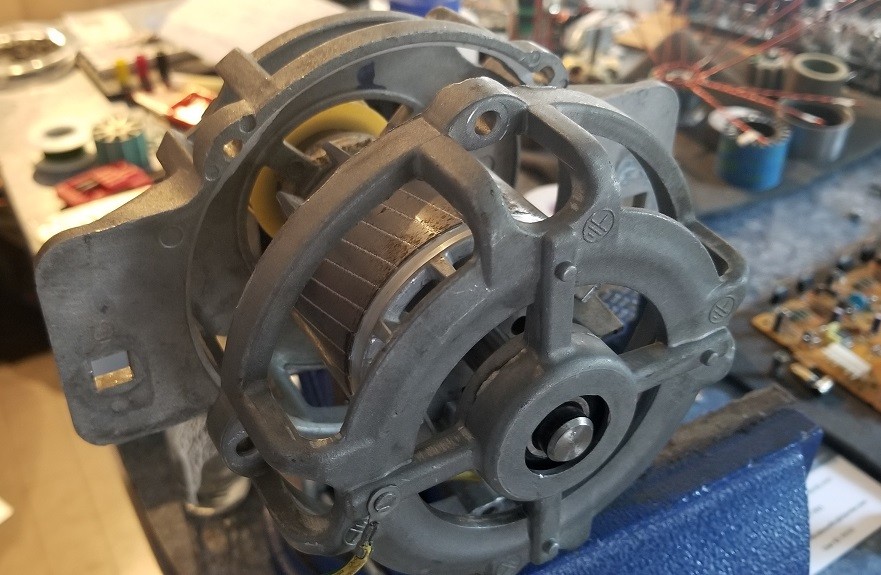

                            #4413
                            Das ist in 90 % aller Haushaltsgeräte verbaut, zum Beispiel in Waschmaschinen. Ralph Okon und sein Freund haben also keine Ahnung. Es handelt sich um einen einphasigen Induktionsmotor. Er belügt seine Freunde einfach weiterhin, damit sie nichts Besseres verlangen, da er Probleme damit hat, die Motoren ordentlich aufzuwickeln, damit sie richtig funktionieren. Er lässt sie seine schreckliche Verkabelung nicht sehen.

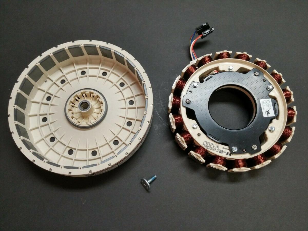

                              Click image for larger version  Name:	20190918_195743 (2).jpg Views:	0 Size:	131.1 KB ID:	431939
                              Gelegentlich findet man ein SRM in einer schicken Waschmaschine. Seht ihr es hier, ? Es ist eine weitere ABC-Wicklung. Es hat nichts mit der Hybridwicklung im Motor eures Modells zu tun. Nur wieder Unsinn von Leuten, die nichts weiter als grundlegendes Motorwissen verstehen. Die späten Acht!​

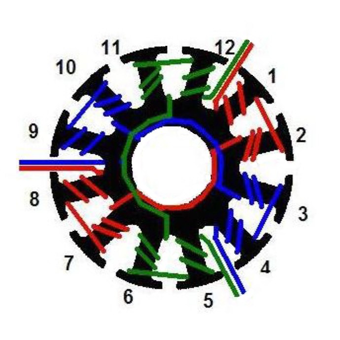

                                Click image for larger version  Name:	y-d.png Views:	0 Size:	804.3 KB ID:	431941
                                Bitte genießen Sie weitere Irrtümer von Dr. Ralph, der nichts weiß. Er hat noch nie eine 3- oder 4-Schicht-Maschine gewickelt, wie sie in einem E-Range Rover mit 8 Haarnadelschichten verwendet wird!

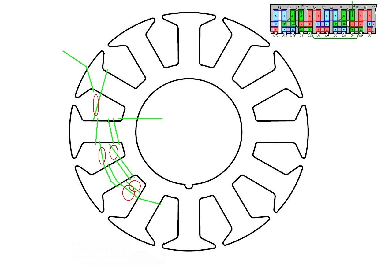

                                      #4418

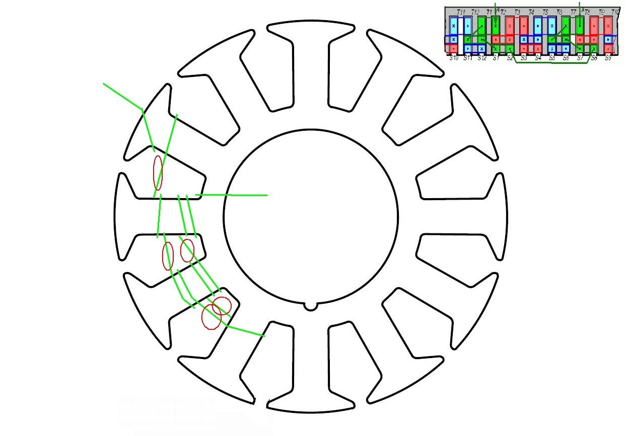

                                      "In the picture above right the proposal, which still looks quite chic and clear and on the large stator the translation of only one small group into the "real winding life."
                                      Logically, the whole thing is 6 times for a complete winding!
                                      This is so daunting for me that I probably won't try it out in practice, but will file it away in my folder "academic development suggestions"."
                                      ~DR Ralph Okon.~​
                                      Aus Dr. Okons Beitrag und Diagramm geht also klar hervor, dass er mit nur fünf Gängen zu kämpfen hat. Nein, er sieht diesen Motor nicht in der Praxis, obwohl er Ihnen gesagt hat, er habe Volllastdaten von einem.
                                      Liegt es an mir, Ralph, oder vergleichst du jetzt Cartoon-Zeichnungen mit veröffentlichten empirischen und analytischen Daten? Du redest vom Konstrukteur beim FC Bayern und seinen Cartoon-Konzepten, aber sieh dir selbst an.
                                      ​​ Click image for larger version  Name:	12N-3-layer.jpg Views:	0 Size:	116.5 KB ID:	431964
                                      :point_up:
                                      Was zum Teufel soll das denn sein? So habe ich es ihnen nicht erklärt. Das ist irgendein Unsinn, den du dir gerade ausgedacht hast. Du hast den Unsinn, den du dir gerade ausgedacht hast, nicht verkabelt, also wer kann schon sagen, ob es stimmt? Ich habe Daten und Video laufen, hast du das vergessen? Also weiß ich, dass es läuft und richtig verkabelt ist. Deine Freunde sind auch total albern, mir zuzustimmen, obwohl sie genau wissen, dass sie dieser dummen Cartoon-Zeichnung nichts entnehmen können …
                                      Ich wette, der Blödsinn, den Sie ohne Bestätigung erfunden haben, ist entmutigend.
