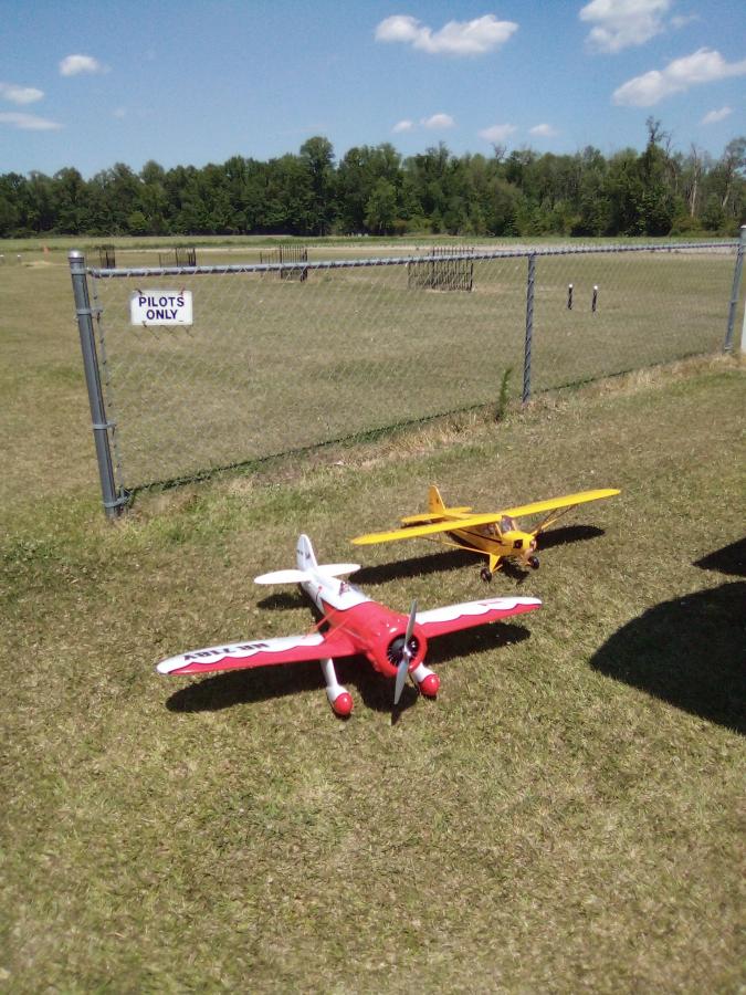

                Took the Gee Bee Sportster out yesterday and man does that thing fly nice. Had my A/R mix mapped to my gear channel so I could turn it on and off in case it interfered with the A3L. Took off with nothing turned on. No A/R mixing and the eagle tree A3L turned all the way off via my rotary knob. Winds were almost nothing. Maybe 2 to 3, occasionally. Otherwise dead calm. Very rare for around here. At first I flipped on the A/R mix and did a few turns to see how it handled. Nice, to say the least. Then I gained a little altitude and started slowly dialing in some stabilizer. No issues at all and I was able to get to the mid point of the rotary knob travel without any oscillations what so ever and the model was absolutely rock solid. Darn, that A3L really works nice. Then, for the heck of it, I turned off the A/R mix. Guess what, it grooved around just as nicely without the mix. Go figure. I am more than pleased with the outcome on this model.

                      I didn't get to test fly the Fokker EIII yet with the A3L installed but I did take out my Gee Beer Y Super Sportster yesterday with a new A3L installed in it and it worked perfectly. Only weighing 3 pounds ready to fly, the little Gee Bee Y got trashed around quite a bit in the wind. Not any more. That A3L tamed it down to a ***** cat. It is amazing how smooth it flies now. I'm hooked. Just ordered 3 more A3Ls from Motion Hobbies for a few of my other models that are a bit squirrely in the wind.
