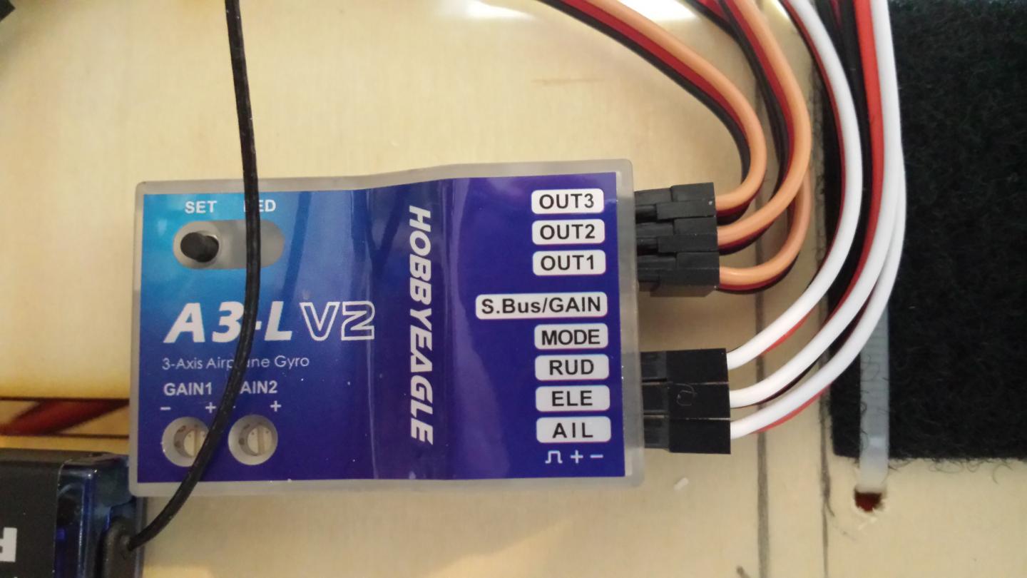

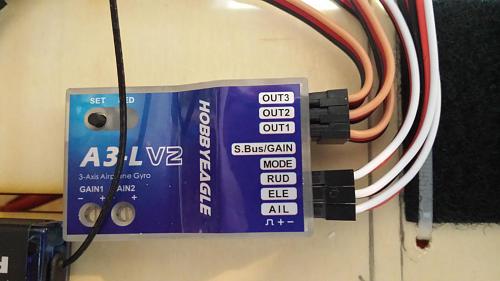

                          Today's Silly Question:
                          What's the orientation of the lead plugs on the A3L? I see the signal/pos/neg icons on top of the case, but does it mean neg is towards the back/bottom? Is it correct in pix? Thanks in advance!

                            Your picture shows the correct wire polarity .
