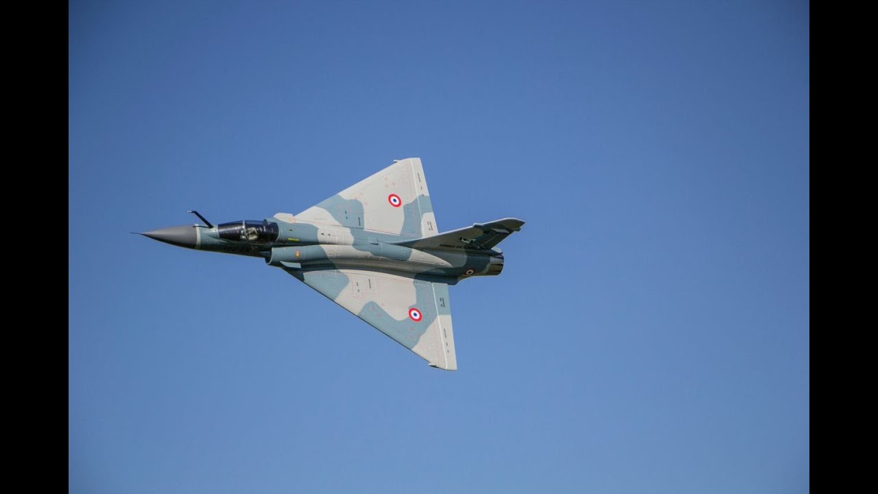

        Hey Doc. Try it out. Leave yourself a way out of course. In our 980mm P-40B vid with gyro I had the gyro way aft of cg it was fine. We also filmed the Mirage 2000 with a gyro placed way forward, that was fine too. I think you'll be fine, just try it out at altitude and start with the gains around 50% and play with it from there.

            You can see in the video that the gyro is directly above the nose gear, definitely not on the cg. Yes, it is recommended that the gyros are placed nearest to the cg as possible. In my case being visible was important. The mirage at speed did exhibit an oscillation, but only at speeds which are pretty quick on that jet. At slow speed and cruise the jet was locked in. The p40B 980 however never exhibited any oscillation and it's a quick ship as well regardless of slow or fast speeds. Also gyro not on cg.
              Isn't oscillation an indication of too much gain. Usually as a result of a system that is too slow to react to the gyro. Deltas and flying wings in general often have too much static margins of stability at speed forcing you to add down trim as speeds built up. These excessive margins tax the system to respond in sync with the gyro. To address this it is often best to use the fastest servos practical in all gyro applications.
              BTW; the only real issue I have with my Mirage 2000 is that the TE is one piece. Freewing should have split the aileron function to separate servos. OK, the wing is a bit too thick.
