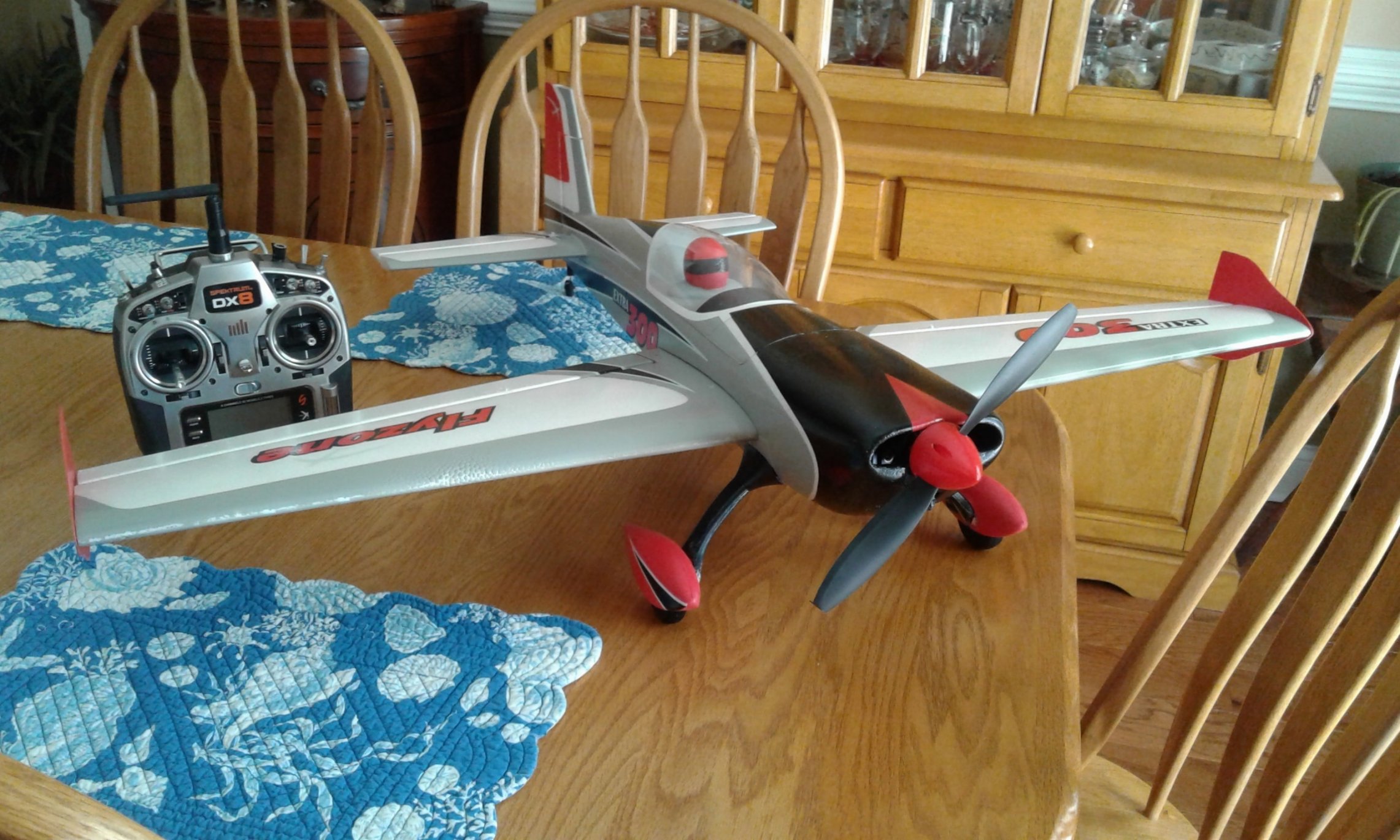

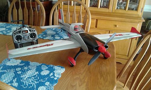

ID:	50273 Test flew it today and it went perfectly. I took off in OFF mode and flew around for 2 or 3 minutes seeing how the model handled. It didn't need a single click of trim. So, I flipped it to normal (2D) mode and there was a noticeable difference in the stability of the little 40" Extra 300. It felt the same on the sticks but the A3-L took care of the 13.5 mph cross wind gusts like it was nothing. Constant wind speed was 8mph and the A3-L dampened any bouncing the winds created. I would not normally fly in a cross wing like that but this thing made it easy as pie. I flew 3 packs through it and each flight was better than the last. I am using a DX8 and it was very simple to set up. I am sold on this contraption and will definitely be buying more. This model is more of a sport model so I think I will disable 3D mode. I take it by lowering the gain to zero will do that. In normal (2D mode) I have the gain set at mid way, 12 o'clock high. I flew it downwind at full tilt and didn't notice any oscillations from too much gain so I am leaving it where it is. Tom
