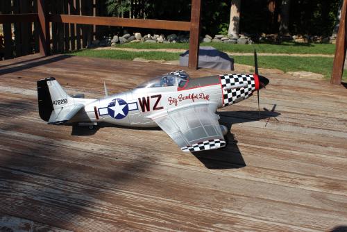

                        I have coated my airplanes with Minwax, they look great!! The Mustang was easy as its already painted so a couple of coats just made everything stand out so much better. Looks like she just got a wax job. The decals stand out beautifully. The Pandoras(s) and the Cub took a little work with IPA, and I gave them three coats, using a foam brush. They turned out great as well. Take the time to really go over the surfaces with IPA, I could have done a better job there, but by the third coat, it covered nicely. Short drying time is nice, although I let mine set over night.
                          • 7415
                          Re: Minwax Polycrylic
                          The Mustang after getting her Minwax treatment. Since she was factory painted, there was no prep work other than a general cleaning, she looks great!

                            WOW !!! That looks fantastic , great job
                              Greetings Grossman,
                              Holy Cow!!! I thought I could see clouds reflected on your wings!!
                              Buddy, that looks outstanding!!!
                              I'm curious to see if you notice any difference in the flying characteristics of such an obvious low resistance surface area. Let me know will you?

                                    You may have a bit of a wait Bill, but I can tell you that weed wacker performs beautifully with her Minwax coat. You can tell right away, by touch, which has the Minwax and which is uncoated

                                      I'd recommend it on your Mustang. Since they are already painted, it's so easy, as I said, it makes the decals stand out beautifully
                                      I guess you could do the canopy as well, I didn't, but I did do the spinner.

                                        Greetings Grossman56,
                                        Buddy, now I've got the hots to go buy a P-51 just so I can Minwax it!!!!
                                        I hope you won't mind but when my wife finds out I'm blaming you!! He, He........
                                        Seriously, your Mustang is really gorgeous.....
