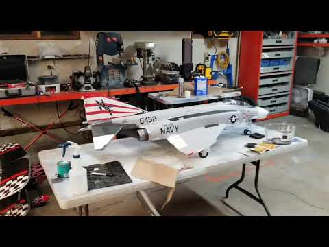

                  t33jetman Thanks so much for that video, I’ve read every post on the polyurethane subject but that video really sent it home. I’m glad to see that you mentioned the Pledge floor care finish, like a typical noob I went out and bought a bottle before really doing my homework on the other ways to seal, what really upset me is the price I paid for that bottle. I may use it for a initial coating over the paint and decals then finish off with coats of the matte Minwax Poly. I want the matte on my warbird, it’s a FW 190 I bought from Motion RC. You did an awesome job on your planes, I hope I can get close to that.

                    Dang Skunk, thank you, they make a Satin Minwax, so you dont have to choose the gloss.
