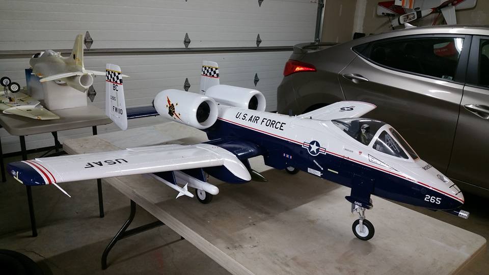

                    I put 8 coats of MinW ax on my A10 ( of course lots of wet sanding too), then primer and paint , then clear coar to stop the gator look.
                    I saw no difference to me in flight performance , just had to adjust my CG because of the paint. Flies great.

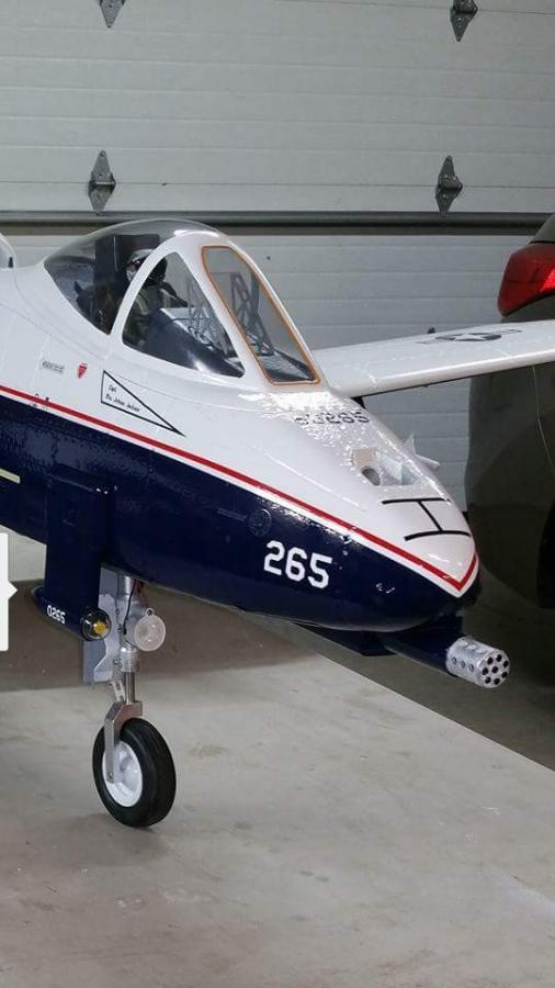

                            My A10 with 6 coats of Minwax is doing very well , but, I don't let any of my plane just set in direct sunlight Light.
                            Keep your planes in the shade or cover them at all times when not flying. I think the hot air will also gator a plane, just like hitting it with a heat gun will. Click image for larger version
