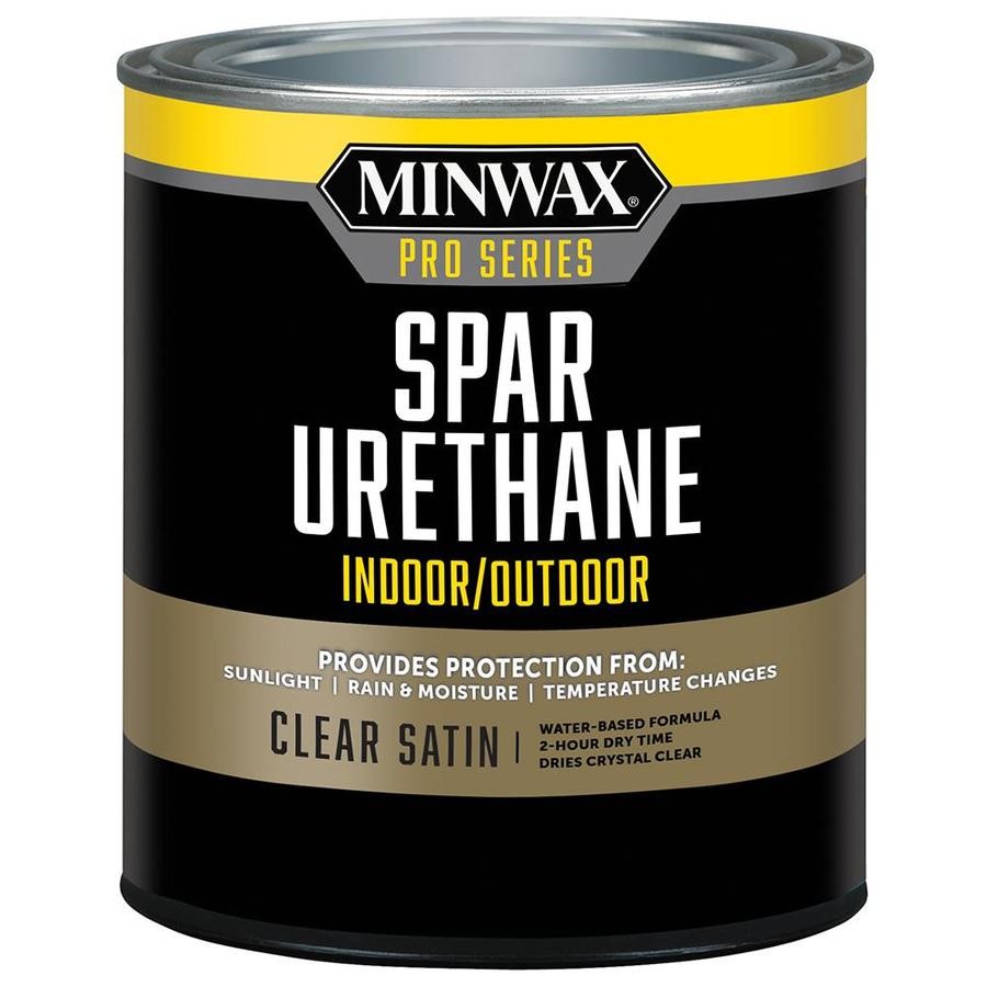

                    https://www.lowes.com/pd/Minwax-Pro-Series-32-fl-oz-Satin-Water-based-Varnish/999918572?cm_mmc=SCE_BINGPLA_ONLY-_-Paint-_-InteriorStains-_-999918572:Minwax&CAWELAID=&kpid=999918572&CAGPSPN= pla{ifdyn:dyn}&k_clickID=bi_264334789_5481217710_1 3814742668_pla-1100008777982_c_&msclkid=ecfeddb15ca4194e5c8881b8c d413641
                    This is the stuff!!
                    For the 'wet look', go with a brush and apply liberally, use a hair dryer to set it while watching for runs. My rule, as I've said before, is to use a brush for maximum shine and a spray gun for maximum flat.
                      • 7418
                      #170
                      The can looks like this, except it says 'gloss'
