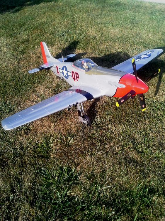

    • #22
      Re: Minwax Polycrylic
      Here's my results.
      Lon
      Freewing A-10 80mm, F-86 80mm, F-15 90mm, Avanti. FMS DHC-2 Beaver, Fliteline P-38L ,HSD HME-262, HSD F86.
      • #23
        Greetings Guys,
        Really!!???! You guys are killin' me!!!!
        Lon, that another awesome example of a damn good looking Mustang!!!!
        I just can't get over how the Polycrylic makes those birds POP!!
        Really nice work guys... if someday we actually get to do a members' calendar, you've both earned my vote for inclusion.
        Clear Skies
        Bill L.
        in Okla.
        • #24
          Great looking warbirds, guys! Lon, are you using the gloss variant? I use satin and it is more muted, which I generally prefer for my warbirds, but I will definitely have to try the gloss on some other airplanes.

            • #26
              Yes, gloss. When standing in the isle picking out the can of Minwax. I switched back and forth several times between the gloss and satin...then thought "Yeh, make her shine!" and purchased the gloss.

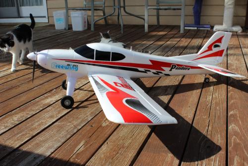

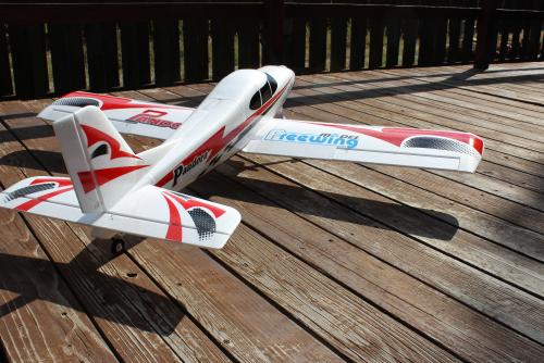

                      • #31
                        I used the gloss variant of Minwax. If your airplane is already factory painted the prep is minimal (read a quick cleaning and/or dusting to remove the cat hair!) As for the non factory paint airplanes, here's Pandora One Risen from the grave.Just follow the suggested steps amd clean and prep with IPA 90%. Pandora Two was a little more tear drop like because of the oil base material used to release the foam from the form. I will reprep the parts that need it and repaint later. See my blog All us Newbies lets share, I'm interested in some feedback to the mods I've done to Pandora One
