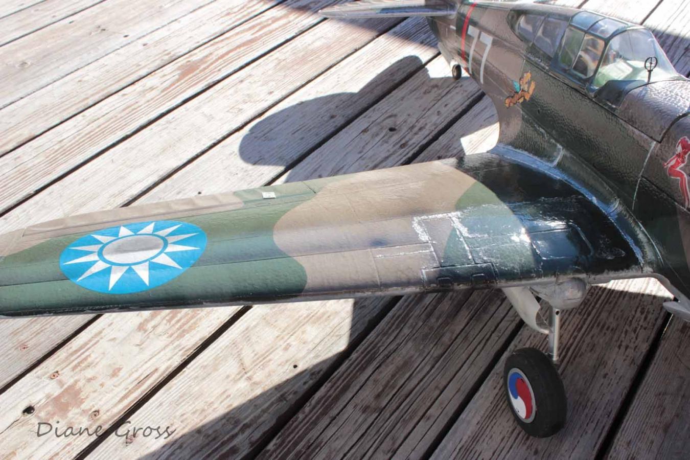

        • F22trainer
          Piper PhD
          • Mar 2018
          • 1484
          • Sun City, Az

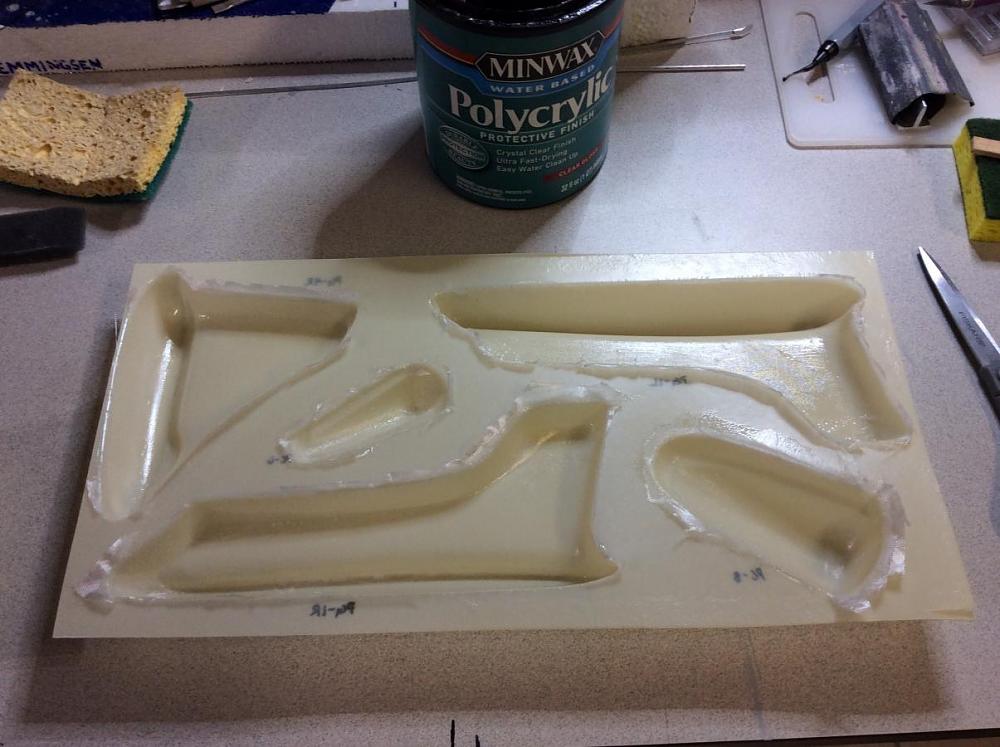

          #144

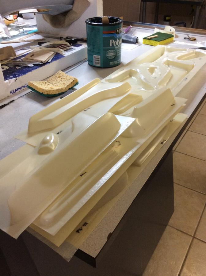

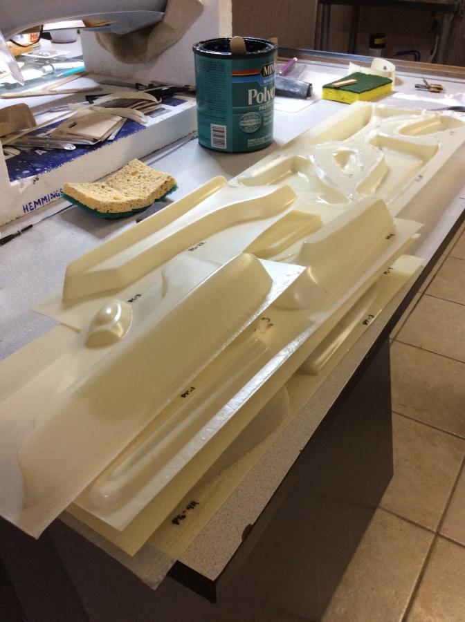

ID:	154817Fiberglass cloth + Minwax Polycryllic made it possible to use real fasteners by giving these plastic parts more thickness and strength with out splitting Click image for larger version

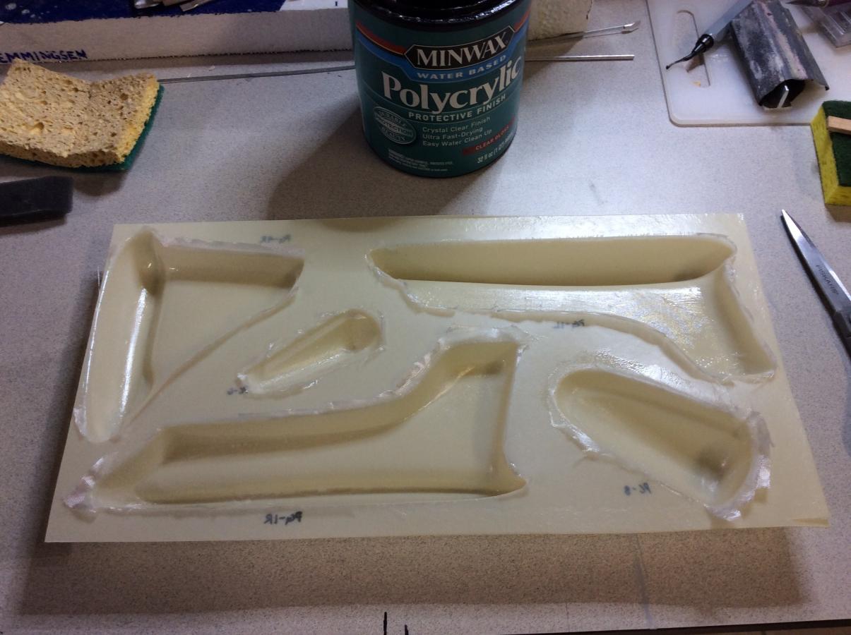

ID:	154816Click image for larger version

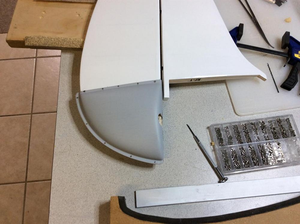

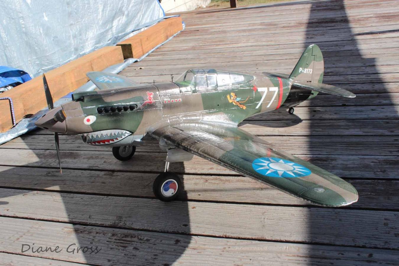

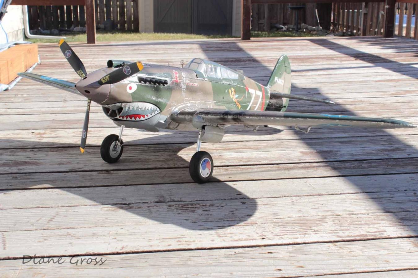

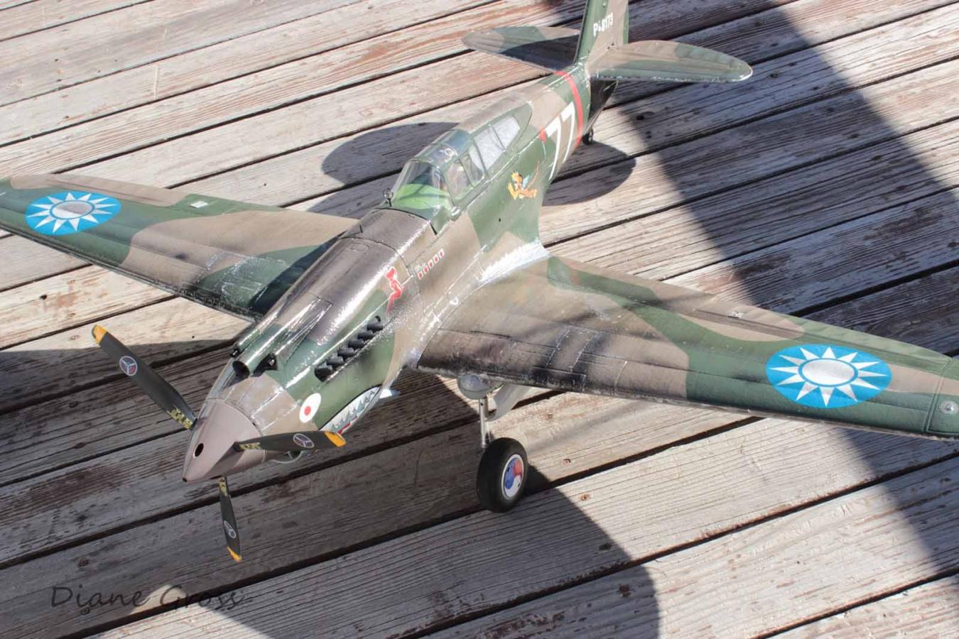

                          Okay--here are the pics. Two coats of Varathane Spar Outdoor gloss applied over original paint. Looks great to me, like someone else said previously--like a good wax job; feels much better when handling plane and shines nice. Not a mirrored surface (that would take many more coats I think) but really nice.
                          I removed the wing and masked the canopy, speaker covers and all ball clevises/horns (and associated hardware). Sprayed liberally and carefully heavy coats from a 12-oz aerosol can. Used 7 ounces of Spar but that is mostly water which evaporates of course.
                          No perceptible effect on CG location. Still balances right where it was before application. I absolutely love the finish; much better than out-of-the-box. Gloss is good for silver painted aircraft. Satin was even duller than out-of-box finish; glad I chose gloss.

                                  I have to take it back--flew it today and it was definitely more tail heavy. I must've not been too precise with my fingertips and their position on the little squares--it obviously moved back. So, apparently it may be something to look at after you're done.
                                  DB
