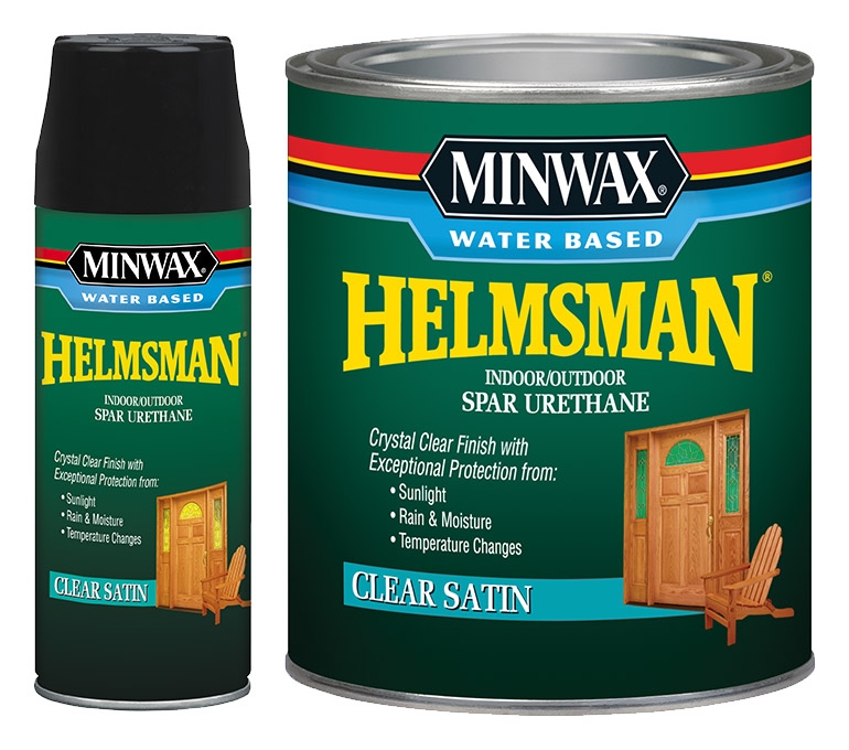

                                • New member here and great discussion on RC foam finishes! Like several others, I could not locate the Varathane products locally. However, Minwax appears to make a competing product called Helmsman Water Based Spar Urethane. Approved for outdoor use since flexible and has UV inhibitors. Best of all, can be found at just about any hardware store and Wal-Mart as well. Basically, it's the more economical version of the Minwax Pro Series redtwilight posted above. Here is what the can looks like along with the aerosol version as well. Available sheens are Gloss, Semi-Gloss and Satin. Anyone have experience with this product?

                                  • Thanks Paul1PA and welcome to the Squawk!
                                    Did you notice if it's available in gloss as well?
                                    • Hey Dan. I'm not Paul but yes it is available in gloss as well.
