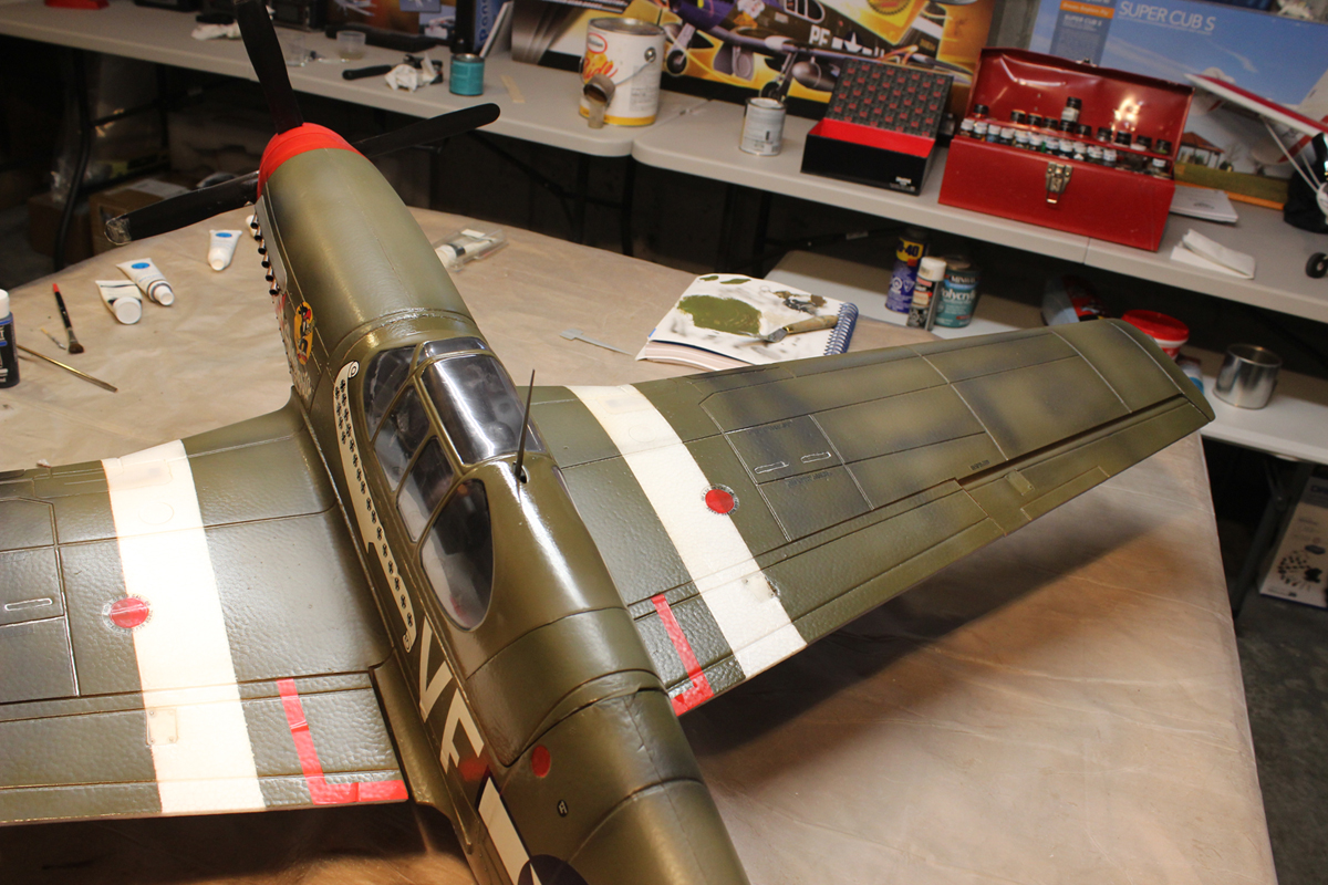

                                Faded by the sun.  Like a car that never gets waxed out here in the desert, eventually all the luster is lost and the paint tends to either look like its been whitened, or in the case of green, the yellow starts to dominate (Yellow and blue mixed make green)
                                To start, I blackened the edges of the panel lines on Shangrila with a thinned out black paint, then used the paint I had scanned to match the color on the plane (good ol' Ace Hardware), thinned out and changed slightly, either mixed with a little white or a pinch of yellow and thinned out.  The top of the engine cowling was just white, then I blocked out half of it with a piece of cardboard and sprayed the other half again to change the color slightly to give the effect of a panel line.  Same with the bottom, only I used blue to vary the color and watered down black for the stains.  Gun smoke was the same black, just layered where I wanted it thicker.  One thing about the gun smoke lines, make sure they're running straight back, otherwise they look pretty funky.
