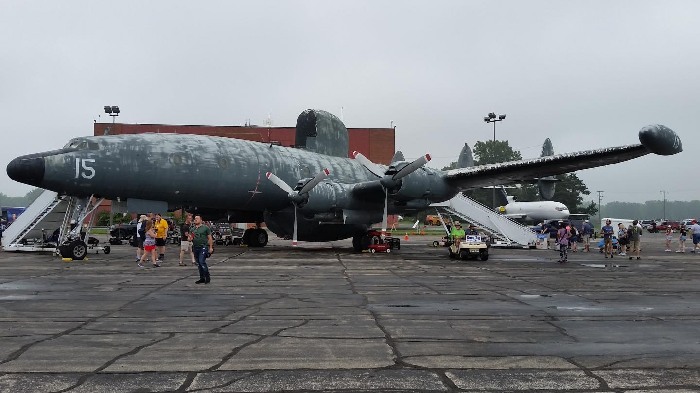

    Would love a Connie! Took these shots when I was at the Seattle Museum of Flight a couple months back...
    • themudduck
      -TMD- Foaming at the Mouth!
      • 1041
      • Burton OH (near Cleveland)
      #142
      Woodcock said, Connie's aren't as big in real life as they seem in the pictures... well I beg to differ! I was at the Thunder over Michigan airshow a few months ago (near Detroit) and the Yankee Air Museum wheeled out the Connie it just saved for display, stained from bird poop and all (they are getting ready to restore it) and it was possible to walk up to it and around it, and inside as well. I took this picture from Waaaaaaaaaaaay back. It is a BIG plane. The wingspan is only 20' less than a Boeing 707. (This is an EC-121 Warning Star). The propellers are 15' diameter!
      Click image for larger version  Name:	Connie2.jpg Views:	1 Size:	142.2 KB ID:	158417
        #143
        Very cool themudduck! That's a nice configuration for a Connie and an airliner I could live with.

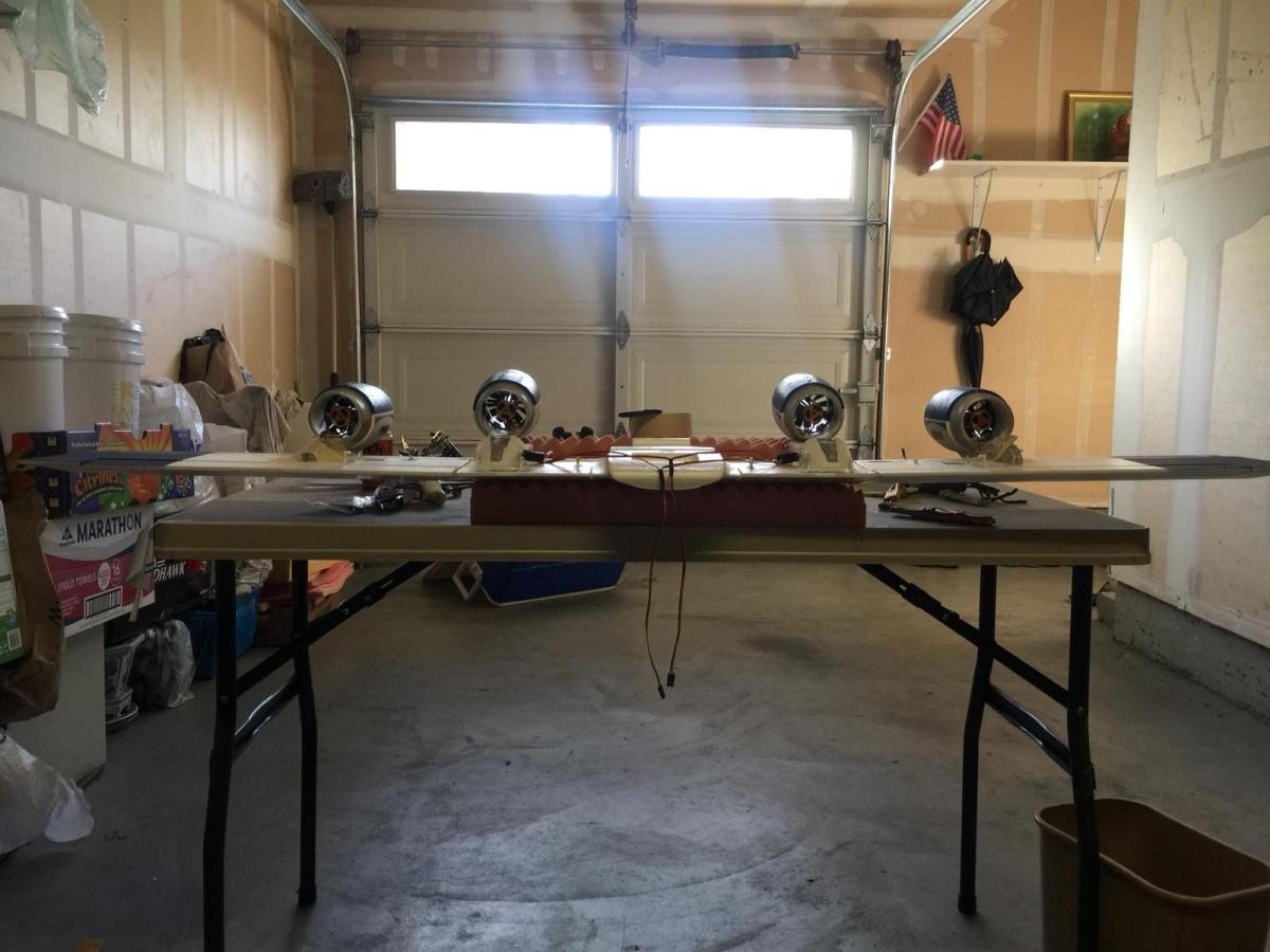

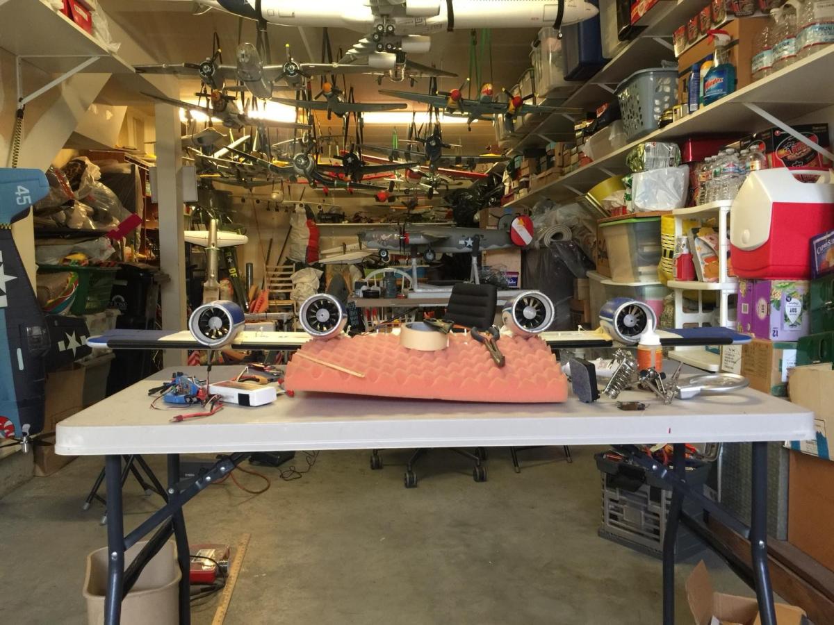

            aircraft#52 "Tengarang Airlines Flight 911"
            Update some progress made this afternoon.
            some gorilla glue was used to fill in the empty cavities of the nacelle to stiffen the structural integrity of the older Eflite foam....
            Tomorrows activity will entail parts placement and routing of the ESC and wire length matching.

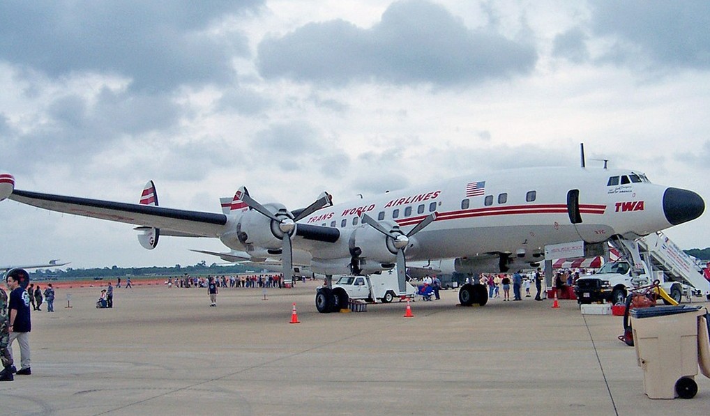

                      Hey Woody, I agree with you that the Connie is one of the best-looking airplanes ever. Even messed up with all that extra stuff stuck on it, the EC121 still looks pretty good.... I saw "Save-a-Connie's" TWA Super-G restoration several years ago at Cleveland and it was spectacular. Maybe its not as large as some modern jetliners but it looks very large when you're next to it... you can walk under it with feet to spare (jets are usually a lot lower to the ground) and those giant props look like windmills! But I guess its all a matter of your own perspective, like you said. Regardless---- this would make an absolutely spectacular model.

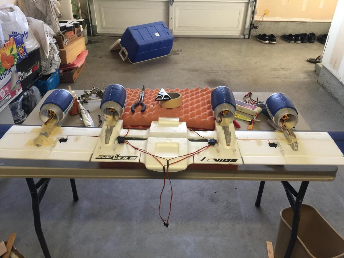

                                Dear Friends, and update for today.
                                Hope everything is well, the tengarang airlines 911 is making way and almost ready to go. Will need some cosmetic work on the inboard nacelles later but she is essentially ready to go just need to button her up a bit and do some last functional test.
                                Today we have measure again all 4 nacelles individually and then together all at once.
                                I am happy with the 3s setup on average we get ~430 watts to the nacelles "un-shared " load, at an average under load of 11.6V which is 500mV above 11.1V nominal which means at 3s the battery is happy.
                                If i combine the 4 nacelles we loose bout 41% total efficiency at 1000 Watts which gives ~10V underload, this is 1.1V under the nominal i would like to see on the static ground test but its close enough the battery is struggling abit, which means i will consider checking how this plane will handle two 4000mah 3s 55C packs. If the CG is good then i will consider going this route for the maiden flight as the extra capacity will for sure raise the 10.1V under load above the 11.1V nominal.
                                Start Test
                                Measure Idle voltage: 12.49V
                                Test data Engine 1: 37A. 430watts 11.62V
                                Measure Idle voltage: 12.43V
                                Test data Engine 4: 37A. 429watts 11.59V
                                Test data Engine 3: 37A. 432watts 11.675V
                                Measure Idle voltage: 12.36V
                                Test data Engine 2: 37A. 432Watts 11.675V
                                Measure Idle voltage: 12.35V
                                Engine 1-2-3-4 Together: 99A 1000watts 10.01V
                                End Test
