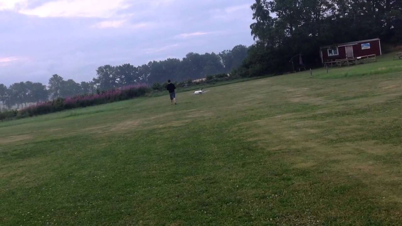

    • Originally posted by tengarang View Post
      Hey that is pretty cool, looks like the stock eflite setup. How did it fly any videos?
      It was a handful, I will try and find itโ€™s maiden video
      • Originally posted by lmramos44 View Post
        10-4 ................Roger that
