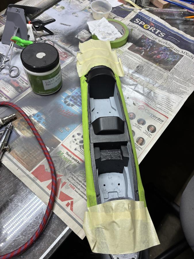

  • jetfool
    Sprayed the red teeth. 3 coats. Letting dry overnight and see tomorrow if I need to re-do it.

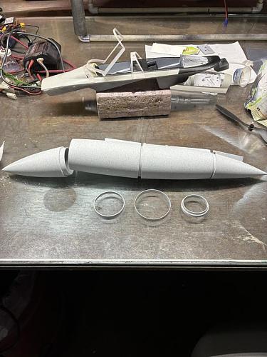

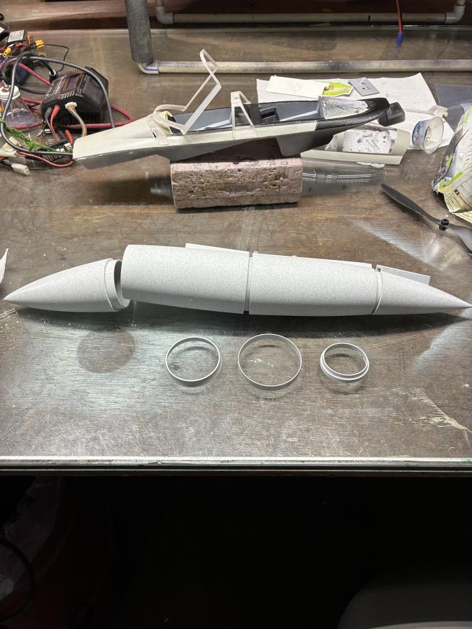

  • jetfool
    Moved on to the Centerline tank, Need to think some on the canopies. Glued tank together and filled the small seams. Primered the center seam and will put panel line tape at the others. Need to figure out the fuel cap position and make. Plan to spray the red teeth on the nose cap tonight. Always something to do. weighed the tank and it's over 1/2 #. Won't fly with it but will use for the static display. Wish it was lighter so one could fly with it. Hint, Hint Elbee
    Best Regards, Rex

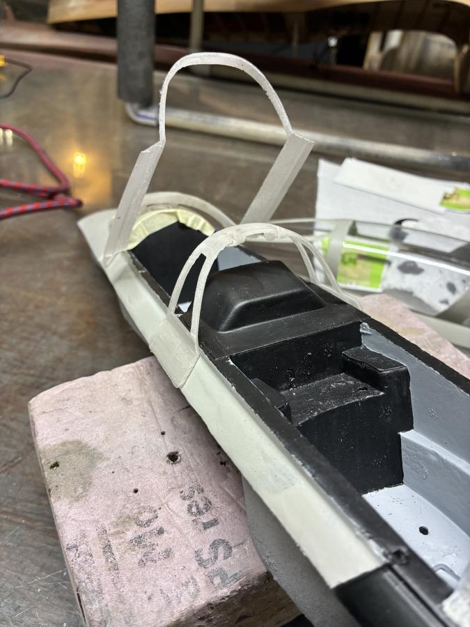

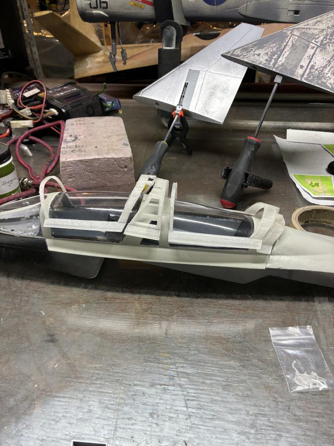

  • jetfool

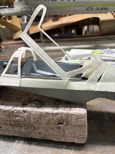

    Canopy is getting better. Had to use the heat gun to form the canopy sides to fit the foam cockpit tub. Not hard just have to watch the heat so it doesn't deform the bows. Starting at the back and working forward.
    Had our indoor fly today and the robotics class finished printing the 600 gal center fuel tank, Its pretty big. They forgot the fus. mount but will have it done Friday
    Best Regards, Rex

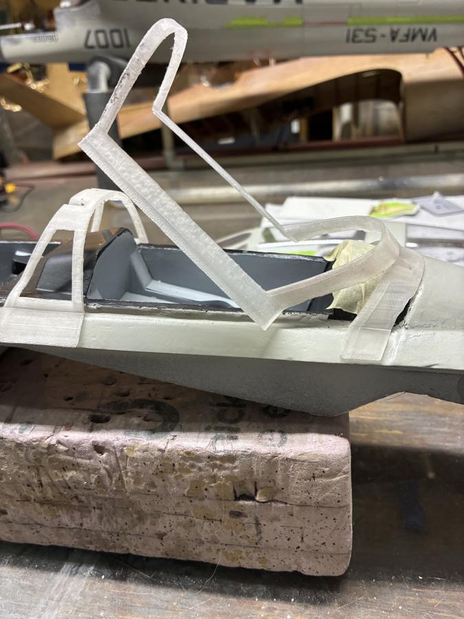

  • jetfool

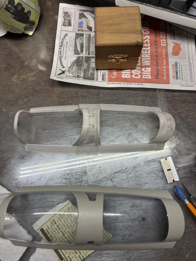

    Guys, After several hours of sanding the canopies are fitting together well. Still more fine sanding to do before primer. also need to make the pins that hold the frame so they can open and close.
    Best Regards, Rex

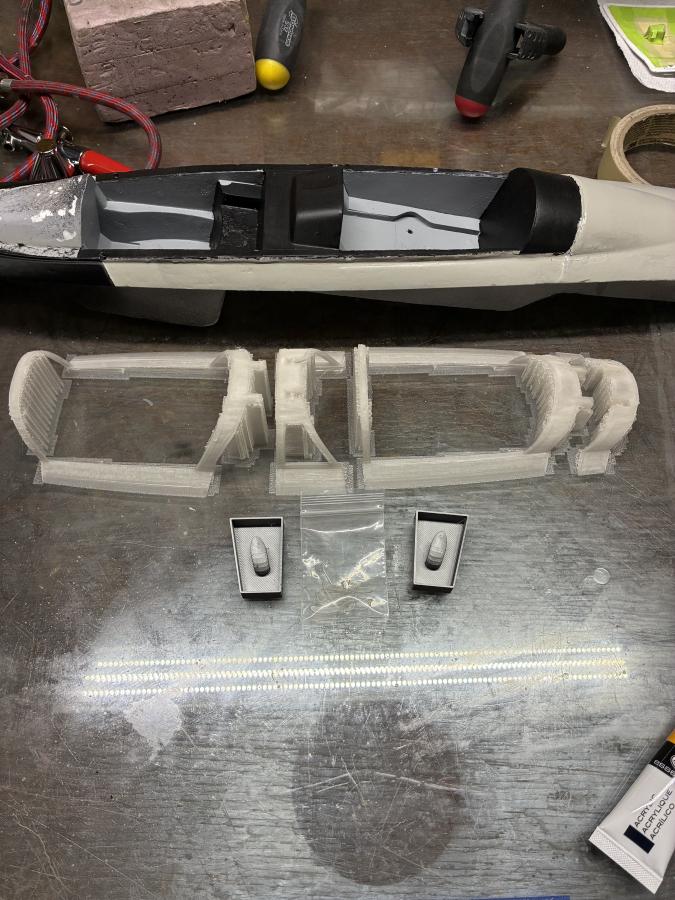

  • jetfool
    Evan D,
    Yes, the frames are nice, but some elbow sanding will be required to get everything fitted to the cockpit. Have a few questions for Chris Wolfe and waiting to hear back.
    Rex
