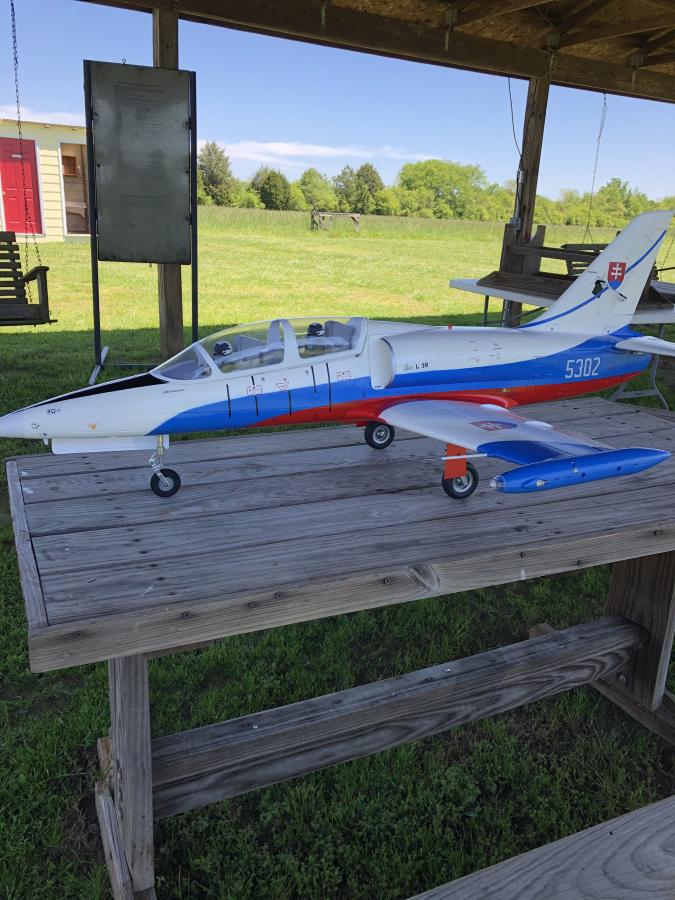

    The front gear door on this plane is not servo actuated. Yes, there is a servo rod but it's not connected to a servo. It's connected to a bar that is pushed on by the strut. The whole mechanism is spring loaded to stay open when there is no strut against it. And yes, it's a matter of playing with the length of that servo rod and through trial and error with repeated closing and openings that the gap in the door is reduced to the desired amount when closed. However, there is a compromise between having a small gap to having the door stay open insufficiently and it gets in the way of the strut as it tries to retract, thereby causing a jamb mid-travel. Some doors, I believe have a slight warp in it and this makes it impossible to close that gap completely without it catching the strut in a bad way during the closing phase.

    I did play around with the length of the rod but it didn’t help much. Will post pic.
