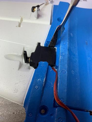

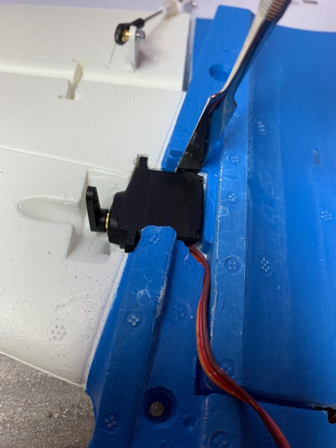

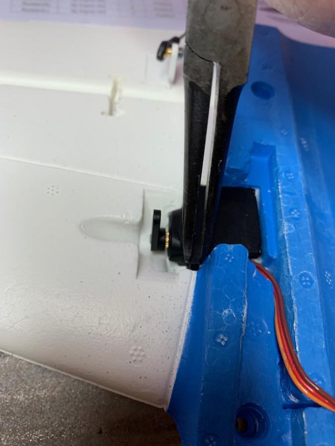

    Hi Guys,
    Just in case anyone else has to replace one of the elevator servos, this is some of my notes based on my experience.
    1] remove the vertical fin 4 screws
    2] remove the horizonal stub 4 screws
    3 unplug both elevator servo plugs
    4] pull out servos leads with horizontal stub
    5] the servo is mounted in the pocket with silicone glue.
    6] use an xacto knife to cut the glue around the edges of the servo
    7] I used my spudger tool to clean the glue without hurting the foam
    8] use needle nosed pliers to lift out the servo with the pliers (see photo)
    9] please note: the servo lead is 30" and not what the L39 product page says.
    10] reverse the process to install the new servo. Use silicone glue to mount the new servo and feed the lead into the foam channel and route it back through the stub opening.
    I hope this helps

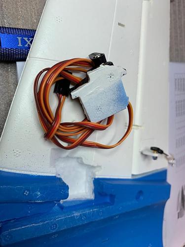

  • RichJ53

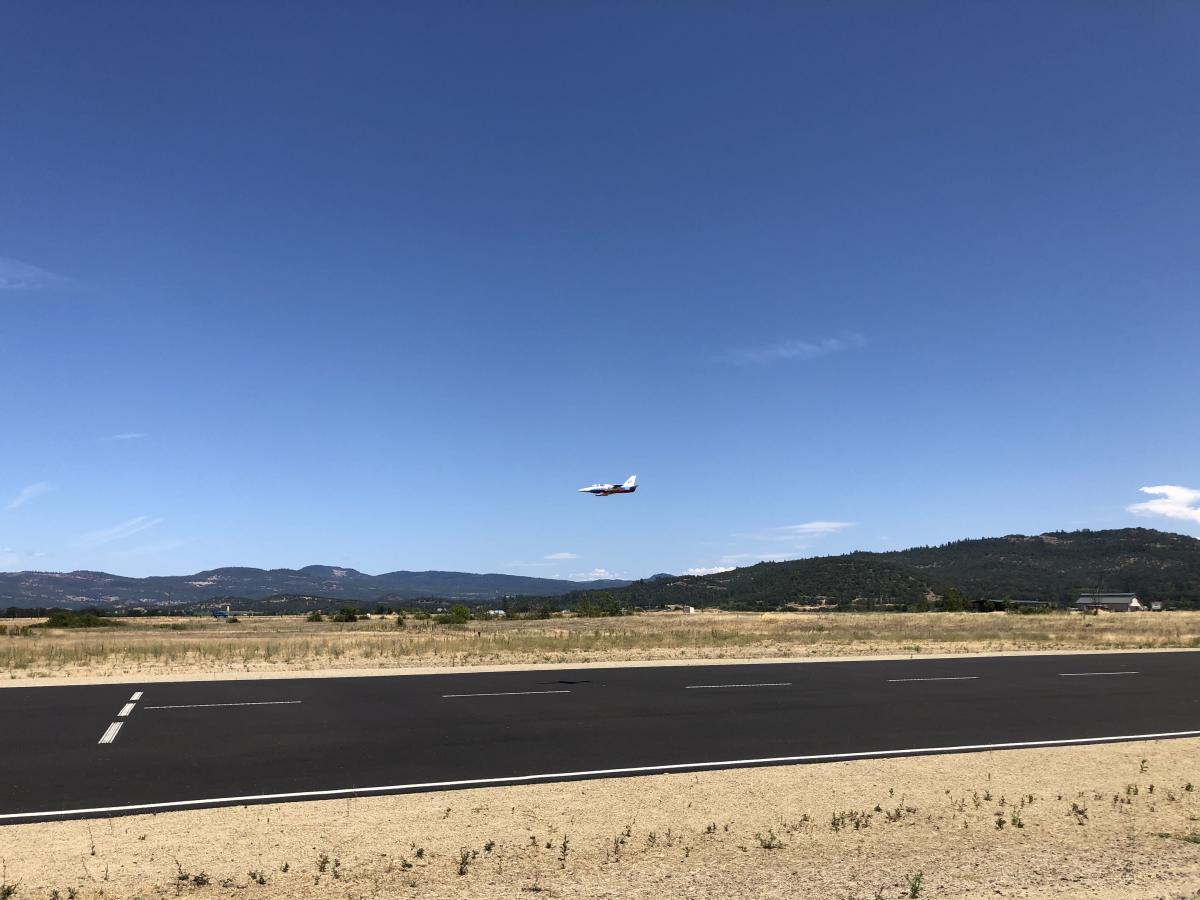

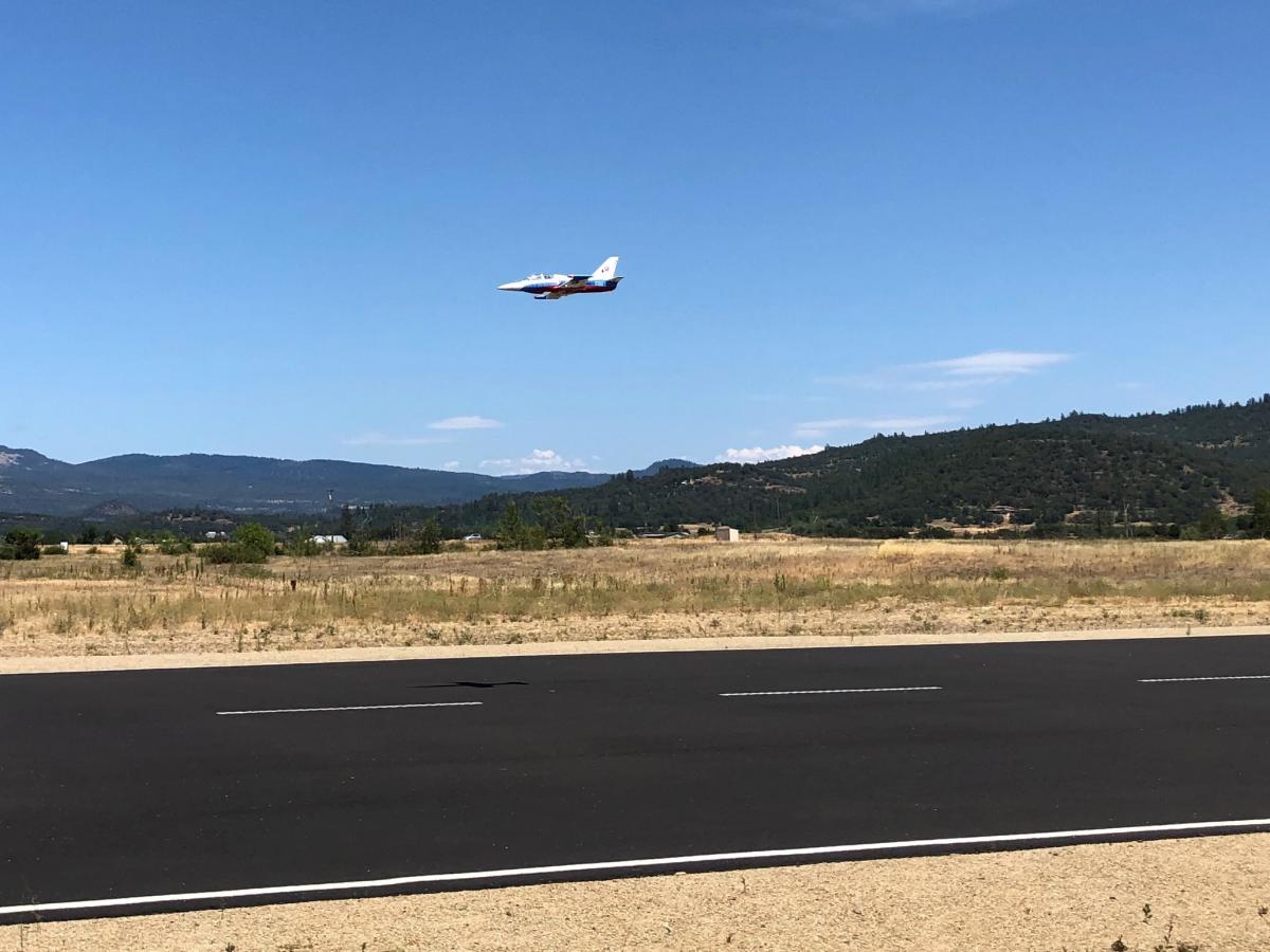

    Flew my L39 today and thanks Scott H for the flight photos!! I just before taxing out on my next flight, I noticed my left elevator servo wasn't moving :(….. aborted my flight and later at home it looks like another bad servo. Yikes... that was a close one.
    Rich
