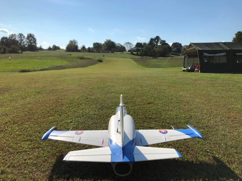

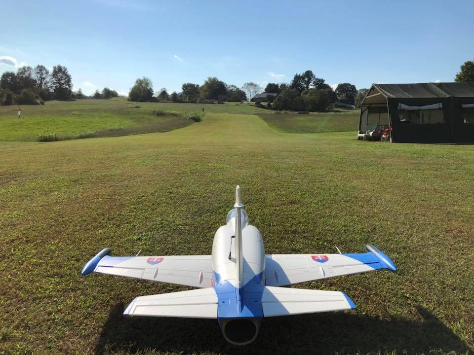

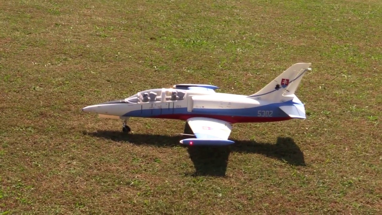

              I have 38 EDFs and the L-39 is by far the most stable and predictable, that’s not to say it’s boring but rather it feels so locked in it makes me more comfortable pushing it to the limits...did I mention it’s crazy fast:Cool:
              Thanks for posting your maidens, guys keep 'em coming! I look forward to yours, Pat. This bird gets even better with time. I'm working on tail sits, trying to get a brief hover. But you're right, George, the landings so far are always easy as a confidence builder.

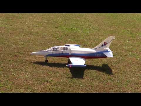

                        Put the first three flights on mine today and was very comfortable with it before the maiden was finished. It slows down enough for landing that even the free wheeling on asphalt I was concerned about was not an issue.
                        This was the best video shot of it today. Shot by another club member using my good camera. Could have used a little more zoom but at least the plane was in frame for the whole flight.
