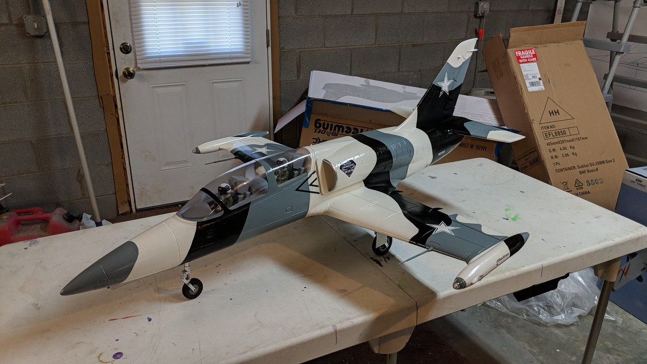

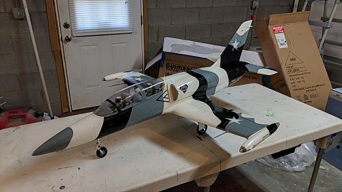

                                  All done. Clear coat is on. Will get some shots of her at the TIA Fall Fly-in this weekend.
