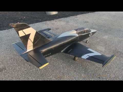

        • A cool L-39 video trying to re-create the Polaroid shot that Goose took in Top Gun....(no top gun music in this one)
                  Great video Seaviper. Thanks.

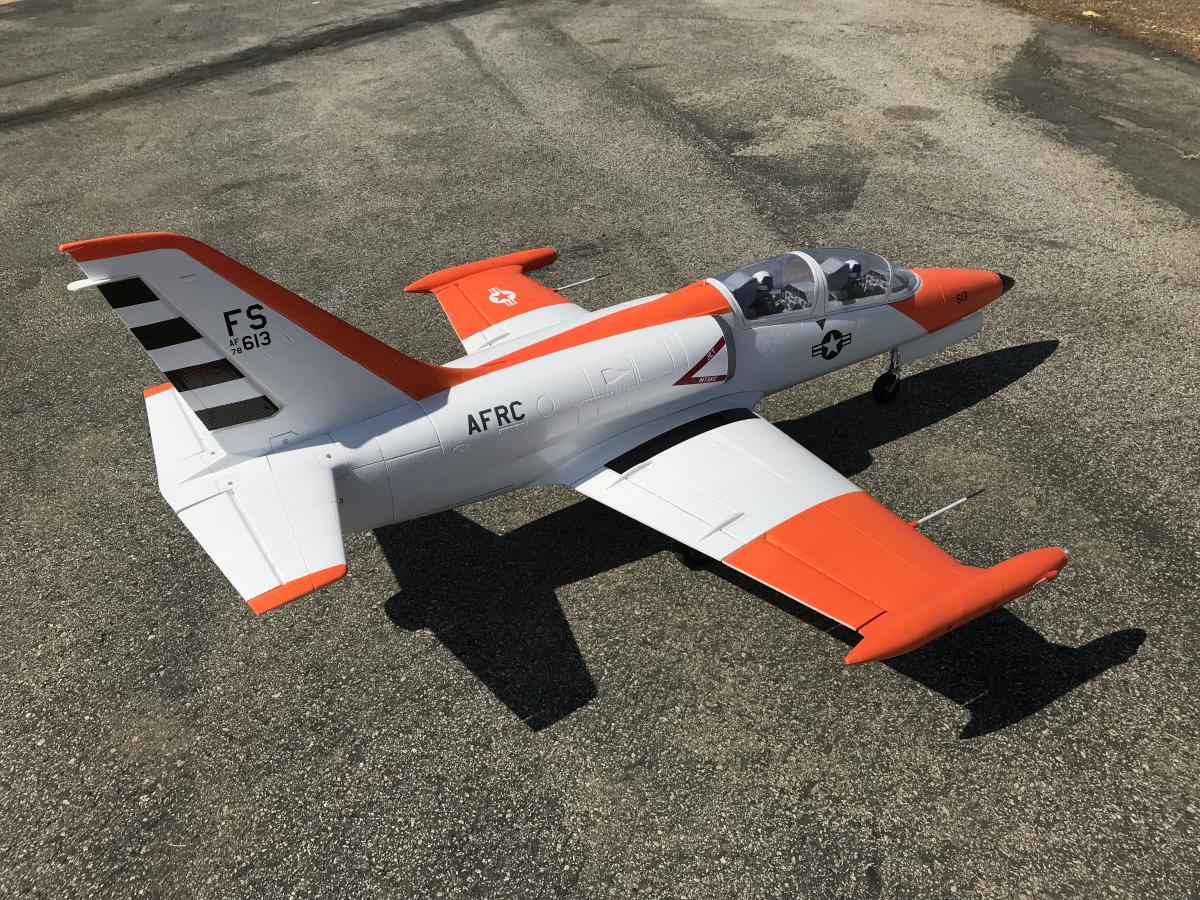

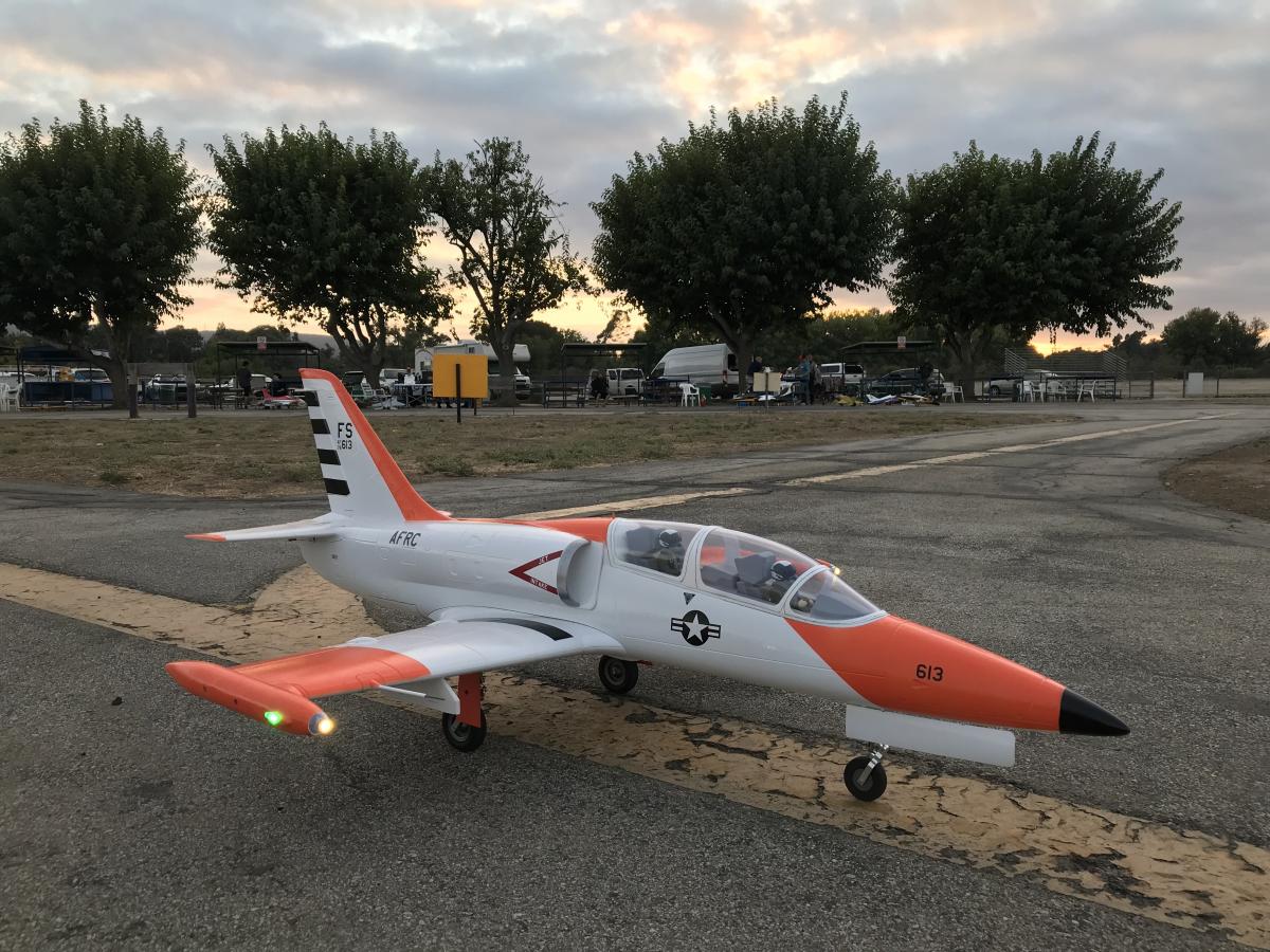

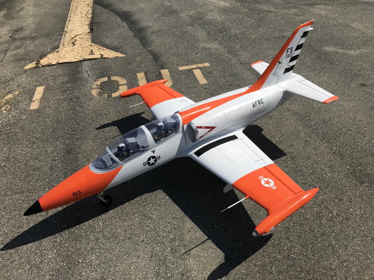

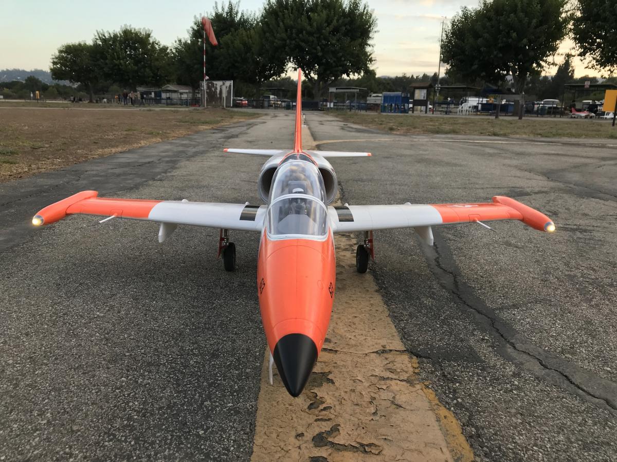

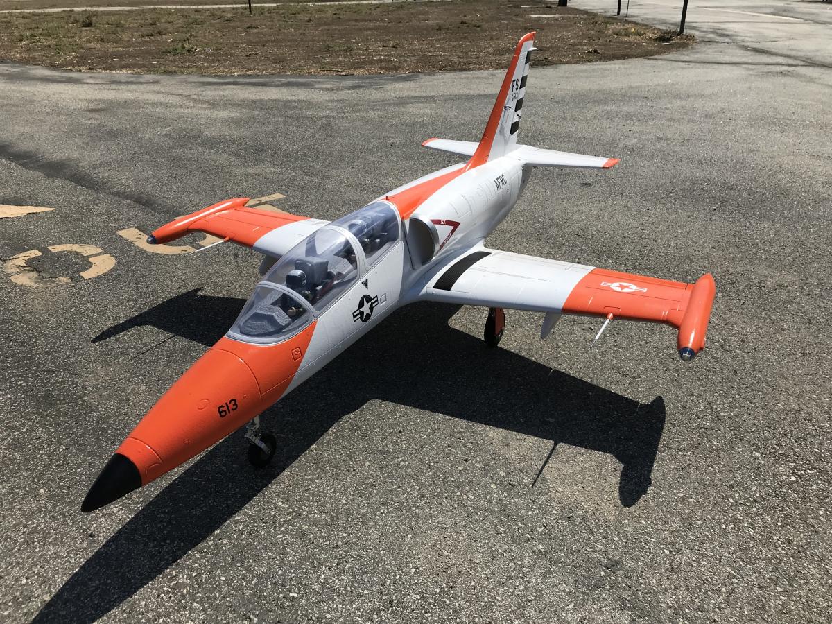

                                    • After the first 20 flights over the week, I decided to repaint the L-39, so today I got a chance to fly with it. It shows up extremely well in the sky with those colors, as well as at dusk. Some of the pictures are at the beginning of the day with the jet unplugged and another picture of it at dusk with the lights on. I’ll tell you, those lights showed up SO incredibly well on those later flights, even the sunny afternoon flights they could be seen at times.
