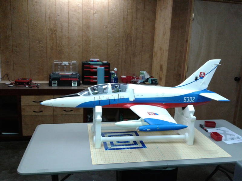

                  Really short leads on the tank wires. After messing with these for a while, I have decided to just solder some proper leads.
                  Click image for larger version  Name:	20181003_142130.jpg Views:	1 Size:	61.3 KB ID:	154668
                  Be careful gluing the tail piece. Mine was out of alignment with the wing saddle. Personally I bolt on the wings and the tail before gluing that tail piece on any jet. That way I know it is aligned with the main wing.
                  This alleviates trim problems and makes your bird fly more efficiently.

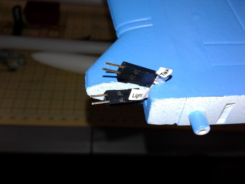

                    I didn't have any issues with the tip tank LED wiring. The trick is to make sure the connectors slide into the void area when sliding the tip tank on the wing mount.

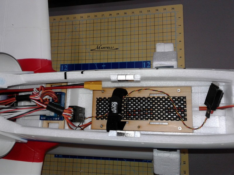

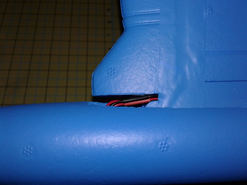

                                    I have been getting more of those lately. One of my complaints. Generally the culprit is a bad solder joint. If you are so inclined, you might go in and look at the servo. I actually fixed one of mine and restored it to flying status.
                                    I fixed the bad connectors on the tank lights.
