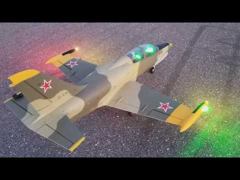

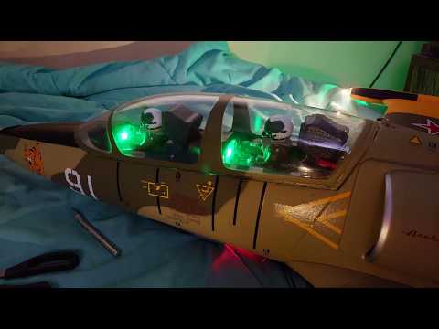

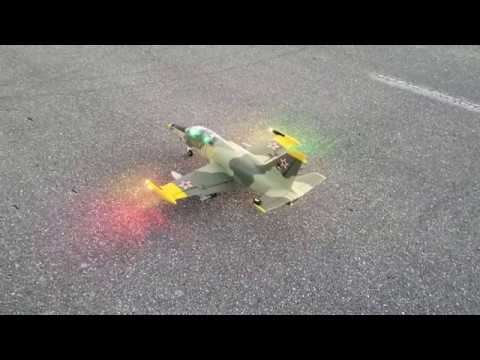

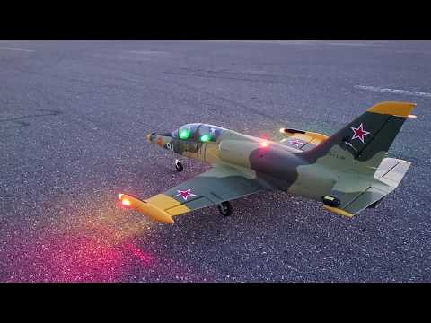

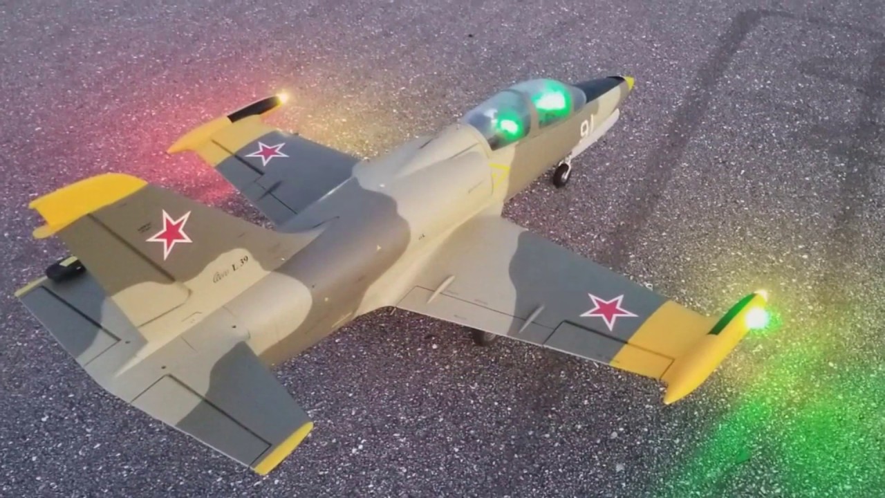

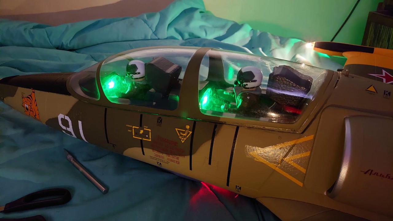

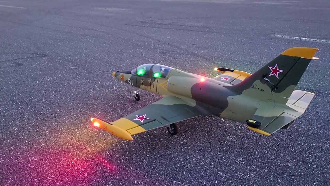

      A rather quick and easy mod for me. Perhaps white lighting would have been better but I love the green.

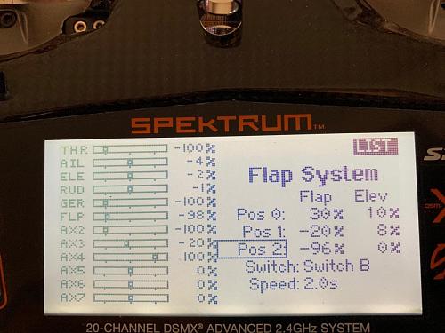

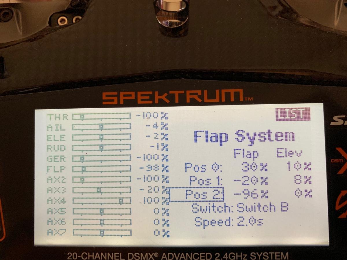

        Originally posted by Rudderman98
        Hey fellas.

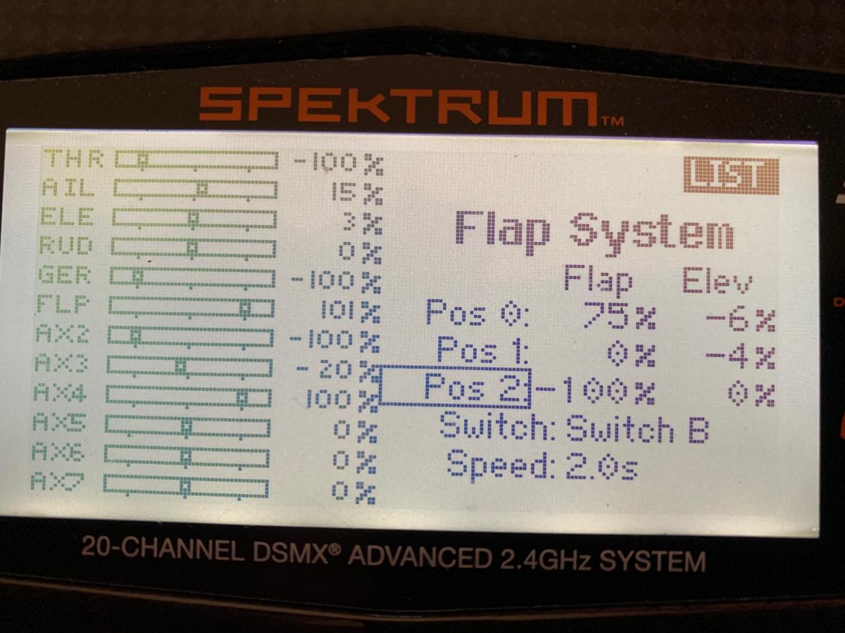

        Anyone have the elevator to flap settings for the L-39? I've been having some issues getting the right settings. I have the DX-18 Tx.
        This is my DX20 flap settings on my L39. very predictable and works great for me.

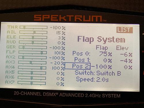

        this is what I have on my FW A4 as another example

          If you take a look at Rich's settings, you can see that the numbers are different from one plane to another and even with mulitples of the same plane. What your settings will end up being is dependent on where in the flap servo arm you began to size up and attach the rod and also on whether or not you are using any flap servo sub-trim to begin with to get the flap servo closer to the beginning (zero flap) of its travel. So seeing someone else's flap settings may not necessarily be what you will use for yours. If I put up my L-39 settings, they will look different from Rich's.

            You are absolutely right and I didn't think about this. Differences would definitely change the outcomes. Post your photo I am curious to see your settings now :)

              PUZZLED:
              How does the way the flaps are set up (Geometry,etc) determine the elevator mix?
