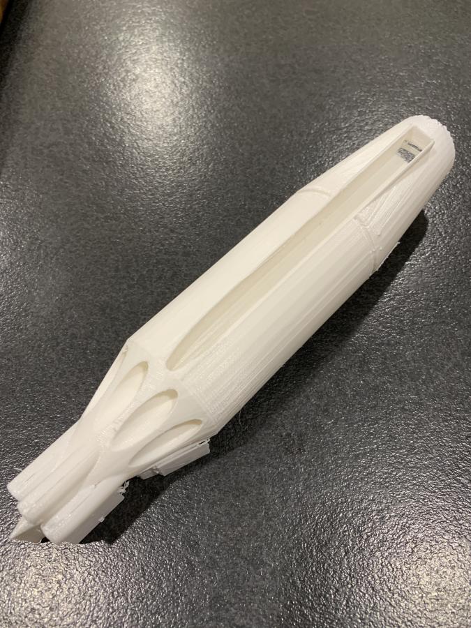

Starting to print now. Going with supports everywhere on a 60 degree overhang, 40mm print speed, 5% infill and a raft to hold it down. I'll report back in 13 hours :Whew:Comment

Don’t do supports everywhere, I did that on my first attempt and it put supports inside the tubes, my second attempt was with base supports only and that worked however they broke the tubes when removing

Did you alter the overhang angle? If you leave it at 0 degrees, supports become almost one with the build, going over 45 degrees, supports have enough space between the print while giving the rigidity for it to build clean. 90 degrees is basically no support.Comment
Yes had overhang at 60. Giving it another go now. hopefully I've got enough filament left for this one as I'm using white instead of my usual green :) Will report back in the morning if it's done before I leave for work.Comment

Unfortunately I can’t print vertically as my
machine is just to short for this model (ask me how I know) this is how mine came out overnight. My supports are thick along the base so will have to be careful removing them off the tubes.
Thinking I might split the file along the line towards the rear which will allow me to print two pieces vertically
That will look great, a little sanding and some paint and it will be all good. I am half-way into the second one then I will start painting. Will look MEAN on the camo bird!Very nice!
