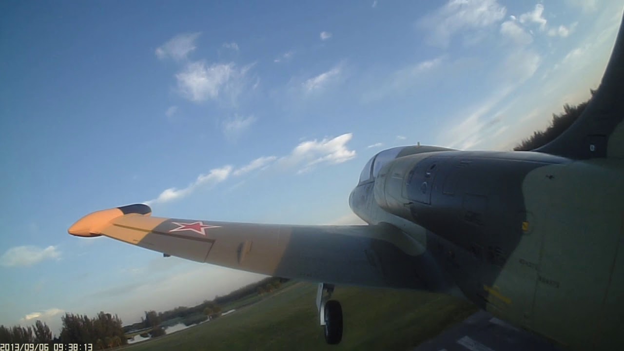

    Flew my L39 today and thanks Scott H for the flight photos!! I just before taxing out on my next flight, I noticed my left elevator servo wasn't moving :(….. aborted my flight and later at home it looks like another bad servo. Yikes... that was a close one.
