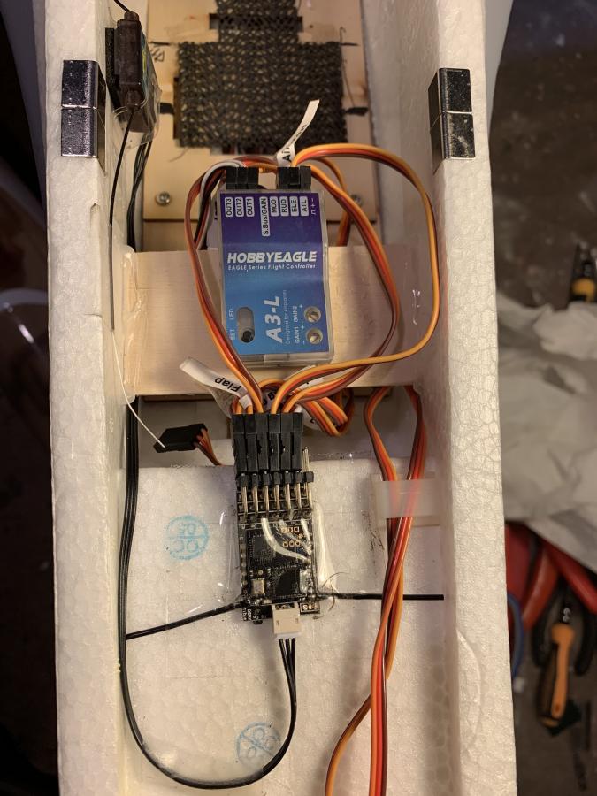

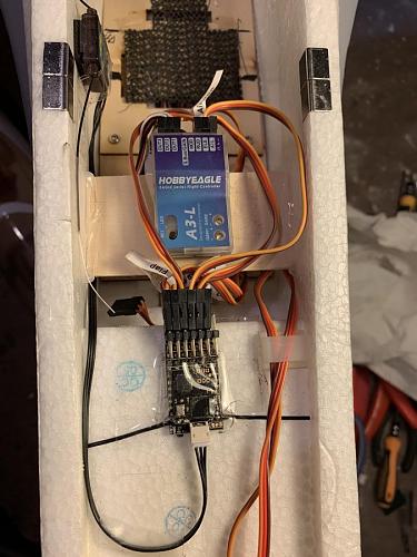

    Im so confused. Can i run an A3L gyro while using the blue box? The gyro needs to recieve signal from ailerons but the ailerons are the ribbon cables.
    and the aileron lead from the bb goes to the rx. :Confused:
    It doesn't matter. You've got the idea slightly backwards. It's the ailerons that need the signal from the RX and it doesn't matter if there happens to be a gyro in between. The leads go from the RX to the gyro, then the leads from the gyro go to the wires that "used" to be plugged into the RX.
    It so happens that my Avanti S is on the table for some modding. It has the "blue box" like the L-39. See how the A3-L simply goes between the RX and the blue box. The blue box is under that wooden tray I built for the gyro.
    PS. The Avanti S doesn't really need a gyro. I did it when I first got it to show something to someone and I've forgotten now what the point was. If I need a gyro for some other plane, I'll just yank it out. Same goes for the L-39. It really doesn't need a gyro. However, in crosswinds and buffeting situations, the gyro does make the plane quite solid, even more so than they already are.

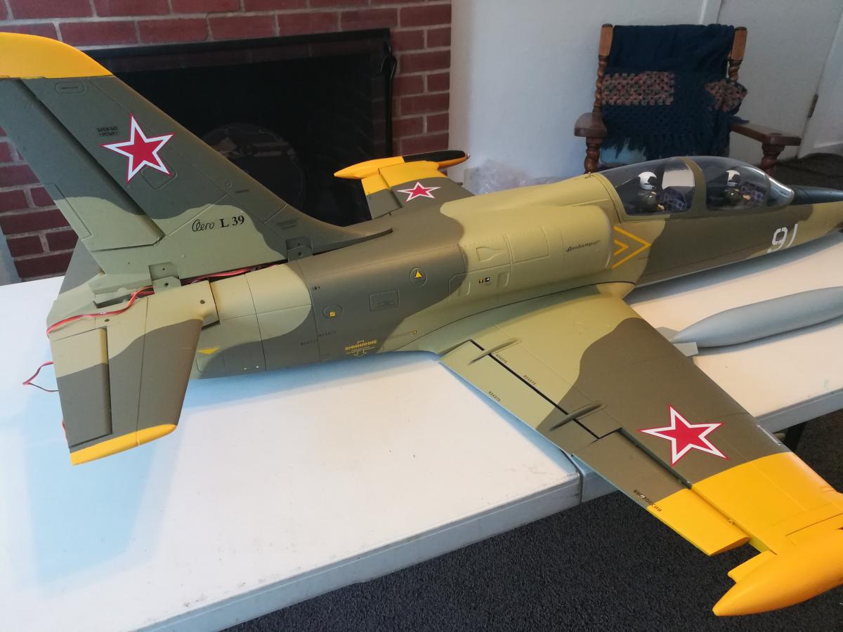

                  Okay, first off I was away when this big brown box showed up and I knew it was waiting on me to open it up when I got home, I was like a kid on Christmas, that was the longest 2 1/2 hr drive home ever.:)
                  So here it is, just had to throw it together and it has to be the best looking paint job on any FW jet, it is stunning.

                                  Ok guys, got it ready to maiden. Now I wanted to clarify something that I didn't notice at first and I don't know why, but if you look at my pics versus the Motion website you will see that video and their pics it looks to be more of a desert camo but it is actually green on green camo, just wanted to let others know this just in case your about to order one and your expecting green and tan.

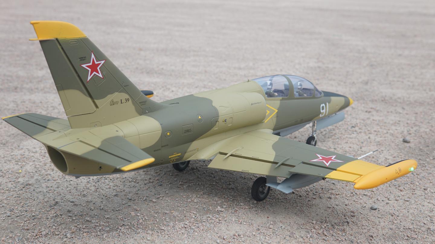

                                      Correct! Thanks for pointing this out. The Czech/Russian L-39s from the late 70s into the late 90s used colors similar to FS14079 and 14255, both of which are greens. The first code is the darker green and the second code is the lighter green. These are FS codes, so they're not exact to an aircraft from that region and that time period. But, they're fairly close, and based on our color samples, our L-39 is color scaled to represent those general colors. The lighter green is warmer and closer to tan, but seems less green especially in pictures when considered in contrast with the darker green beside it. If you were to separate the two colors onto separate swatches, most people would agree they're both green. But putting them side by side in certain lighting, there would be less consensus as to if they're both green or if one is decidedly less so. These factors are probably why the scheme has worked as an effective camo for decades, because the colors are relative to each other and yet not relative to each other in other ways. It's confusing. Which is what camo is supposed to do.
                                      We were hesitant to release this color scheme for visibility concerns, but the gray belly and yellow tips and nose to enhance visibility to an acceptable degree. Plus, the scheme just looks so darn cool. :Cool:
