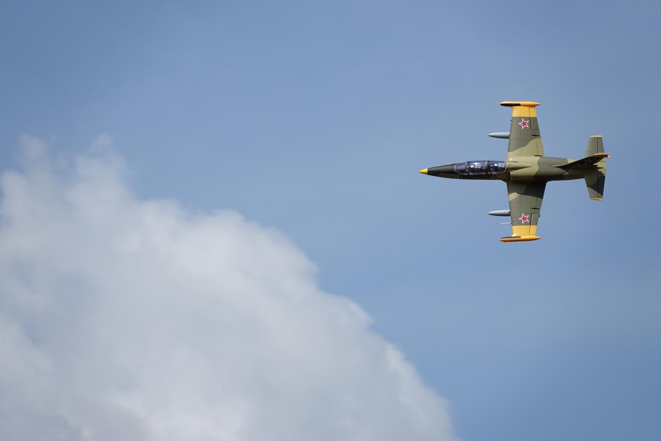

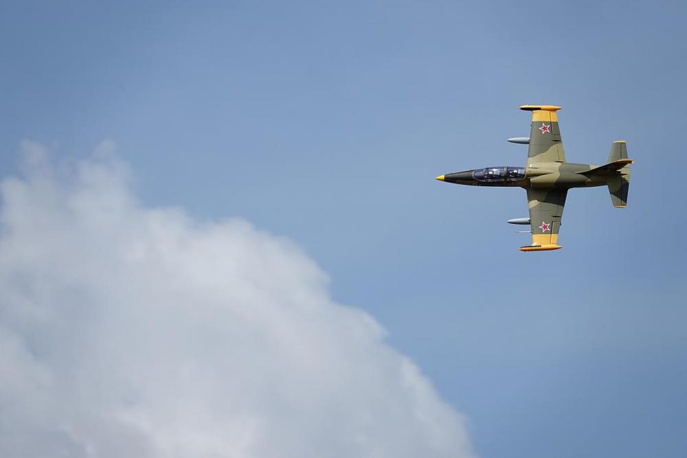

                                      I need to print up some of those UB-16 rocket pods and dirty up the cannon. This bird loves to knife edge!
                                      Click image for larger version  Name:	DSC04642.JPG Views:	0 Size:	32.9 KB ID:	204427

                                        its one of your best planes yet Alpha
