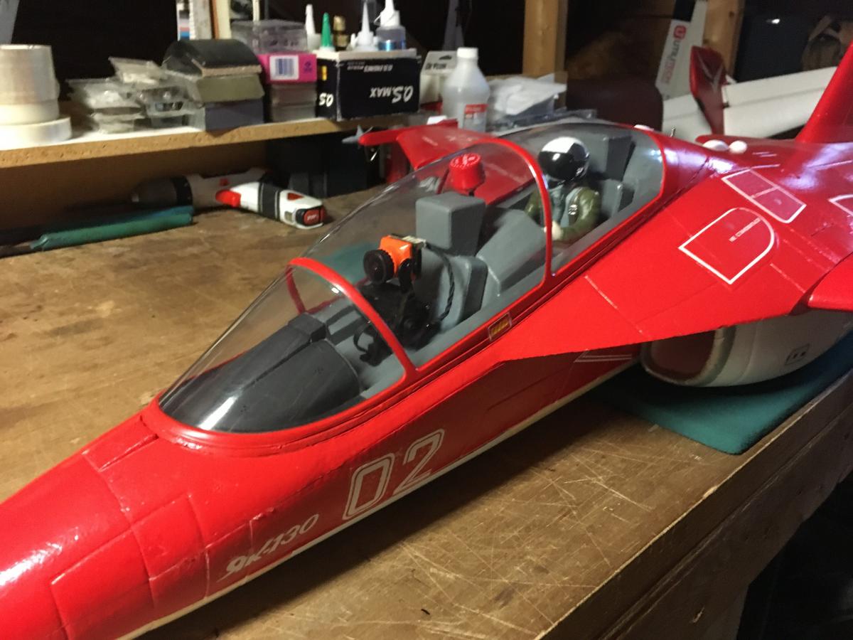

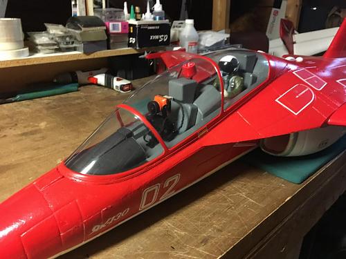

ID:	236793 I use the P&T out of the Avios Spitfire that you can get from Hobby King. As far as camera's I only use micro's that have M12 lenses (such as the Micro Eagle or Caddx Ratel) so that I have a decent quality view. I also replace the lenses to have a longer field of view. The one's most come with are too wide angle for airplane or EDF use.

                                        Click image for larger version  Name:	631A32EA-EBD8-4FF6-8B3A-9C5ACB46CDD7.jpeg Views:	46 Size:	114.9 KB ID:	236793 I use the P&T out of the Avios Spitfire that you can get from Hobby King. As far as camera's I only use micro's that have M12 lenses (such as the Micro Eagle or Caddx Ratel) so that I have a decent quality view. I also replace the lenses to have a longer field of view. The one's most come with are too wide angle for airplane or EDF use.
                                        I just went on HK and ordered one..... at least it is a start! I love the RunCam eagle... i have a few of them on quad's. Thank you for the info on the P&T!!
                                        What size lens to you put on it?
                                          • 5401
                                          #1520
                                          I’ve settled on the micro eagle for various reasons like size of the sensor, all the settings, overall size... One of the reasons that didn’t work out is the zoom feature. If you zoom it doesn’t allow some functions to work.
                                          So I’ve gone to different lenses. You can find them cheap on Amazon. I’ve found 3.6mm gives the best all around FOV but I have 6mm in my Tiger Cat. With pan and tilt a narrower FOV is not bad. With a fixed camera a wider FOV is better. The lenses are IR CCTV lenses for security systems and to be used in our cameras need a IR cut filter to get natural colors. I’ll get on my computer later and send links for lenses and the filters if you’d like. The micro eagle and most larger cameras use M12 threaded lenses.
                                          Get FPV and other model sites do have some lenses but are limited... I’m not sure if theirs would need IR cut filters or not.
                                          oh, I fly 4:3 if that makes a difference.
