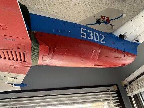

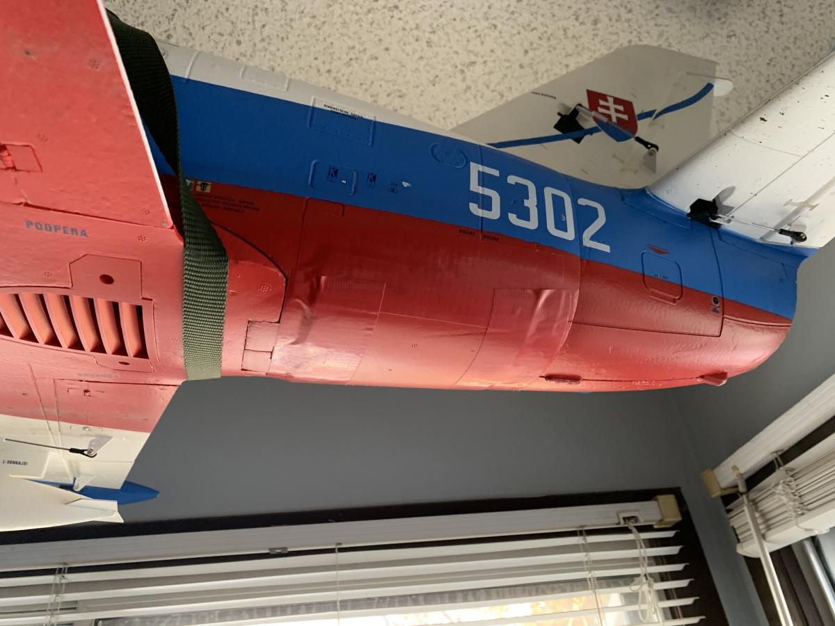

                    Thanks I will look into the upgrade considering I making another $100 investment in the new fueslage. The Club Pres is very experienced, I think everyone flying electric jets at our field, the model really took him by surprise.
                    Please note: The FMS fan unit doesn't mount perfectly flush. It' a couple mm larger in outer diameter, so you either have to shave off a little foam around the fan or you just mount it and deal with the small ridge due to the fan hatch not sitting flush. Since that area is red, I didn't bother with shaving foam. I just covered the seam with red tap. If that bothers you, then you'll need to do some shaving, but since you're dealing with a new fuse, it shouldn't be too much of an ordeal to work with it before everything else goes into it.

                        It's about a mm all around. Instead of taking and sanding away a mm I sometimes just take my thumb and compress the foam a bit.
