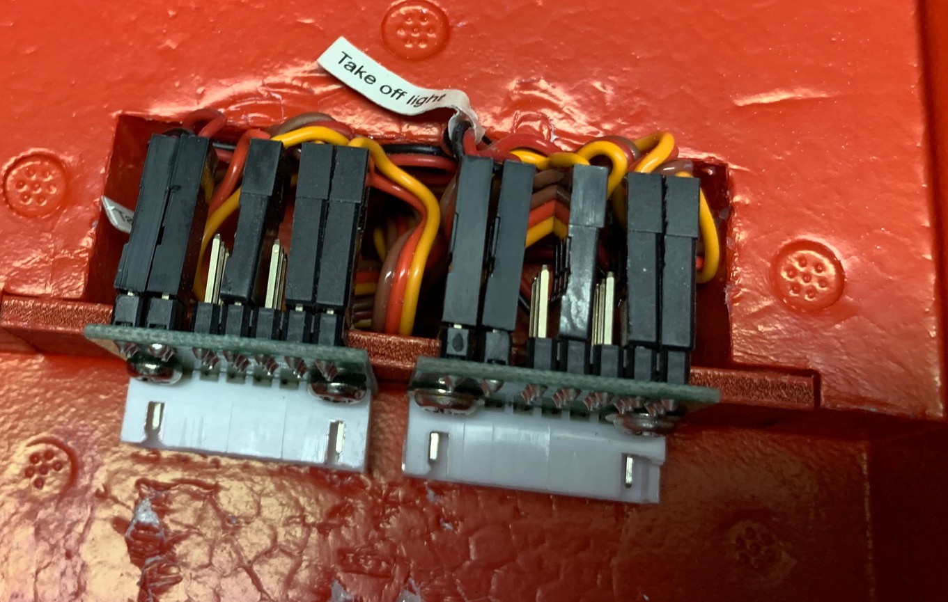

    cashmoneybrother, check wiring make sure all colors are matching from both ends, then if that is correct check blue box, and make sure wiring is correct
      • 8817
      #1642
      Originally posted by cashmoneybrother
      Left side landing light wont turn on at all and nav light only turns on when gear is up. Right side landing light is on all the time but gets dimmer when gear is up. If I disconnect the left side then the right side works as intended. Please help!!!
      With your manual, you should have also received a sheet with diagrams of all the different kinds of control boxes that Freewing planes can come with. Find the one that is the same as the one in your plane. Check the labeling for the light pins. Move them around till you get the lights to work the way you want them to. Note polarity. I'll bet they were plugged into the wrong pins when factory assembled.
      Edit: On this plane, the more specific answer has to do with the wing connector boxes.
        The wing lights are connected to the MCB-E (Blue Box) by the two ribbon cables, not much room for errors here.
        At first, check the connection at the wing control boards. See attached picture. On each board, the light connectors are on the left, landing light at very left, then Nav light. Red wires have to be on top. If that looks OK on both connectors, unscrew the wing tanks and remove those carefully. Check the connectors at both ends for correct polarity and matching labels. I assume, the fault is here. When everything is properly connected here, add a piece of masking tape or heat shrink tube to keep the connectors together when pushing them into the wing again. Take your time at this step and mount the tanks again.
            This is the correct solution. My answer was based on a Freewing plane where some or all of the lights are attached directly to the blue box. In this case, it's the wing connector that needs to be examined. I think somewhere in the manual there may also be a diagram of what plugs in the wing board does the job.
