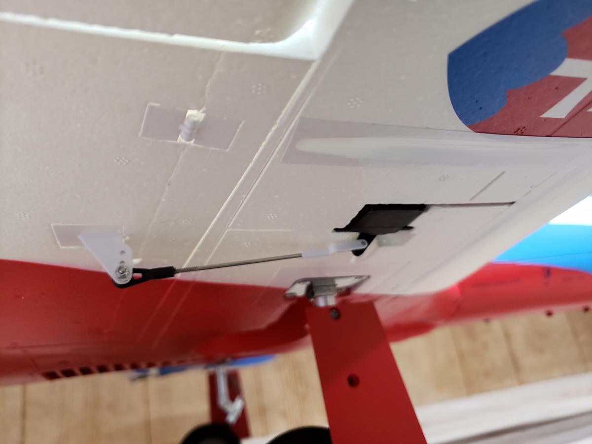

                      Got mine yesterday. It looks awesome! This is my first EDF and model with retracts. My Flap pushrods were too short (measured 80mm though) with the servos centered so I had to sub-trim them. If I hadn’t already glued the pylons in, I would have moved the servo arms. When checking the CG, should it be right side up, gear up?

                        Howdy. The pushrods are not too short for the flaps.... What radio are you using? You have to set the flaps up so that the servos are in the " flaps up" position. That gives you the correct amount of length for your pushrods.... Let me know if you need more info. I can help with Spektrum radios... (DX-9) And Welcome to Hobby Squawk!!!! I balanced mine inverted with the gear down. That way, when the nose gear retracts forward, it shifts to a touch nose heavy... 103 mm worked great. Right at the edge of the tape that covers the servo leads in the wing...

                          No dude they are not too short. The horns should not be centered with flaps up. The horn should be over toward the flap with flaps up.

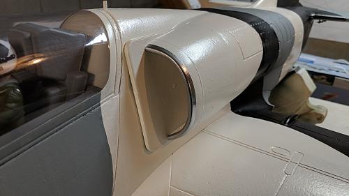

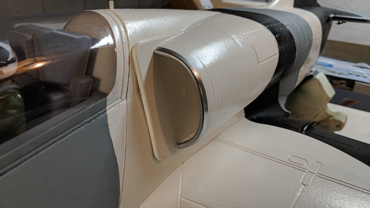

                            Shiny intake edges..... Me likey...

                              Shiny!!!! :Drooling::Drooling::)

                                Thanks Hardway and Seaviper! This is also my first model with flaps so now I know. Would have been helpful if it was mentioned in the manual. I am using a DX9 and its flap system. Is using sub-trim to accomplish it harmful?

                                  No, not as far as flaps go. When setting flaps up, always have the rod disconnected. Use sub-trim to run the servo near the end of it's travel. This will be your "no flaps" position. As an alternative, you can also use the flap menu and in position "0" (no flaps), dial in whatever it needs to run the servo to near the end point. Test for movement in position 2 (landing flaps) set at greater than zero flaps so you know that the servo is moving in the right direction when you throw the switch. Now, you can hook up the rod in "flap '0' " and dial in what you need for position 1 (1/2) and position 2 (full). Also, sometimes, you need both sub-trim and flap adjustment in the flap menu to "zero" the flaps at the starting point. Be careful you don't have any flaps dialed in (% wise) in the menu when programming a new plane. If you have the flap servo reversed, you can over-drive the servos and kill one or both.

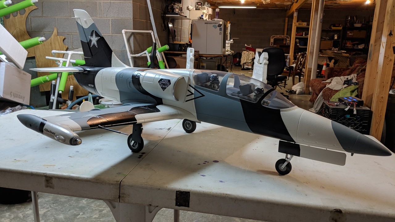

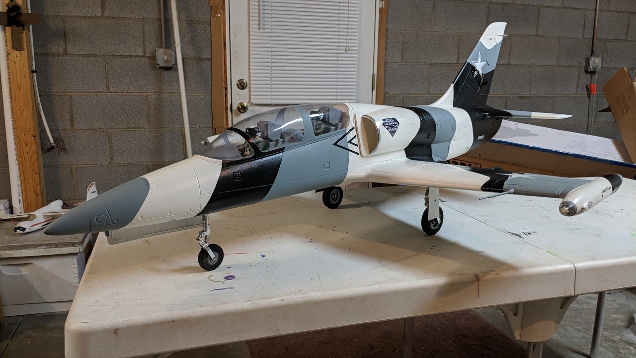

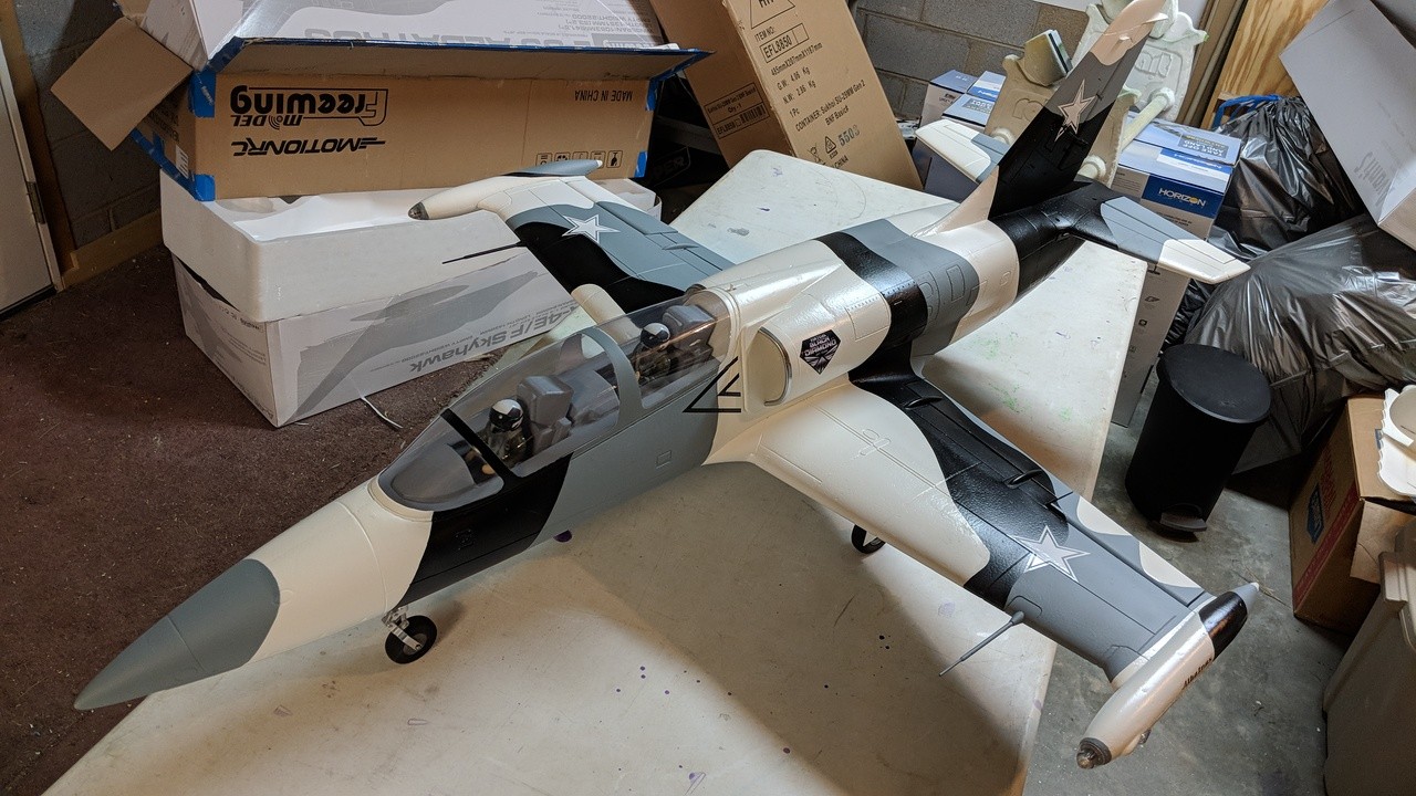

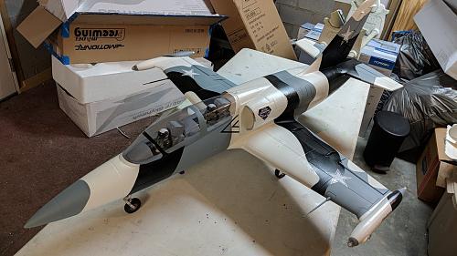

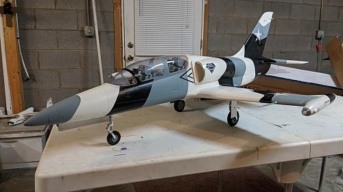

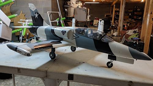

                                    All she lacks is a clear coat.

                                      Very nice! What did you use for the silver on the intakes?
                                        #659
                                        I got one of those Molotow chrome paint markers. Twisted off the end of it and dumped the paint into my airbrush cup. The stuff is super bright. Dries fast and it worked great.
