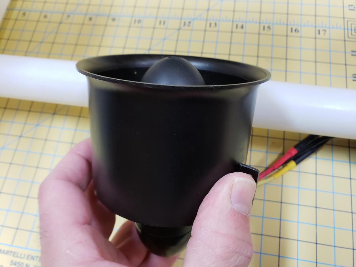

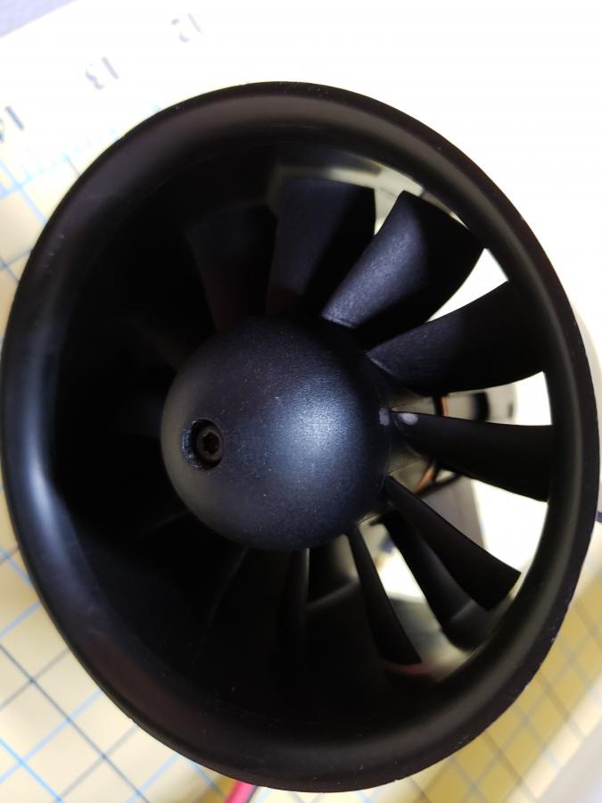

                        Finally had a chance to tear down the motor on the Albatros. It was the front radial bearing that was making noise. I ordered a fresh set of bearings from Boca Bearings.
                        We'll see if that fixes it. $18.52 shipped vs $55 + shipping for a new motor.
                          #832
                          Awesome. When I first read your msg, my brain said 55.00 shipping..... LOL Never mind!!! :Silly:
                          • seaviper
                            ATC retired
                            • Aug 2016
                            • 1092
                            • Philadelphia Mississippi
                            #833
                            What happened was the spinner got a little loose and rotated slightly. This caused vibration which killed the front bearing.
                            i put a little loctite in the screw hole, then rotated the spinner until i got smooth operation. I held the fan unit up against the plastic poles on the robart stand when testing for vibration. Its really very apparent when the fan is out of balance.
                            anyway, she is back in service.
