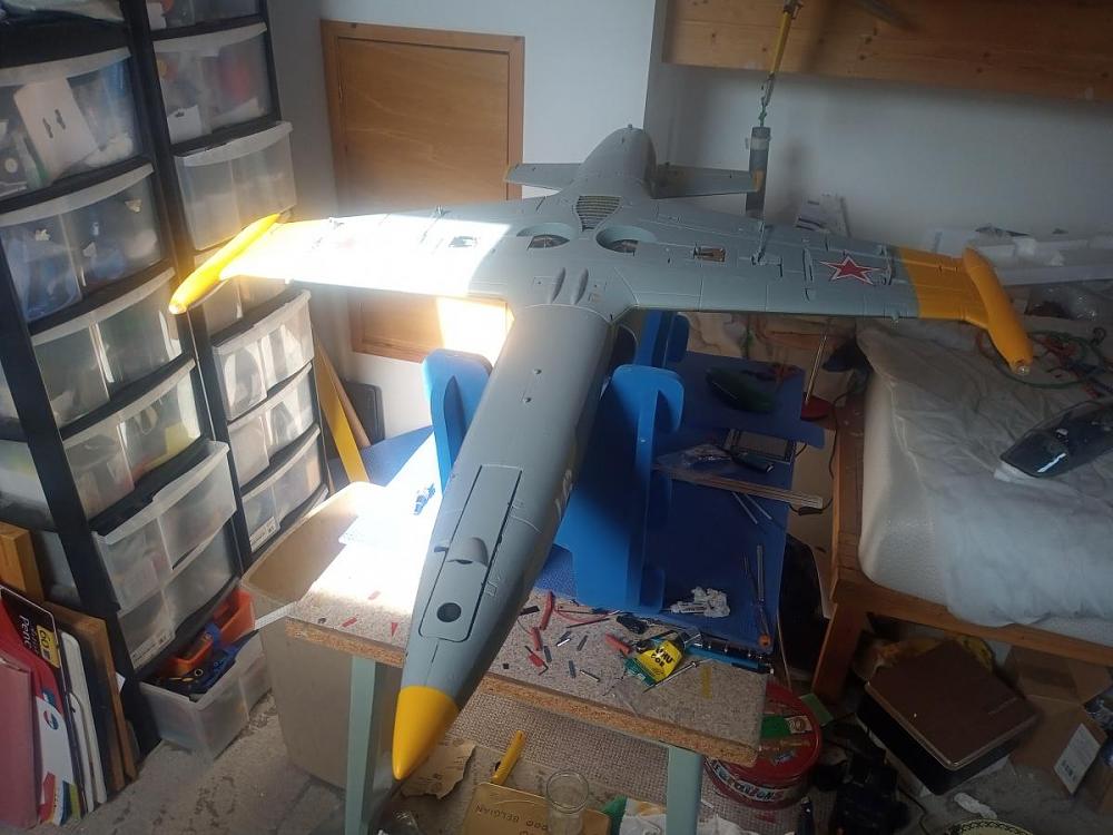

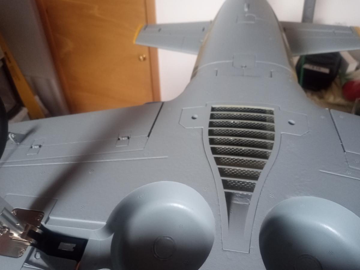

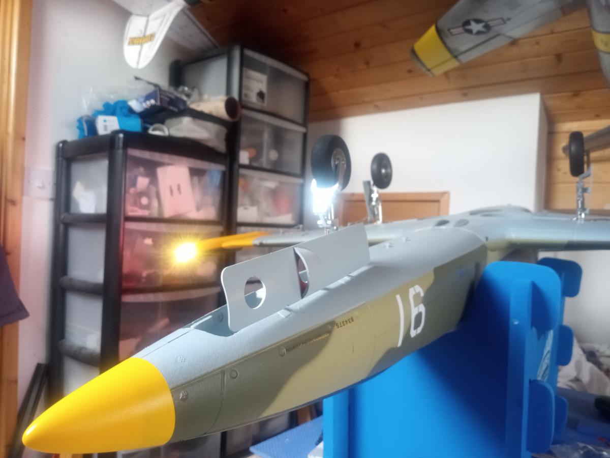

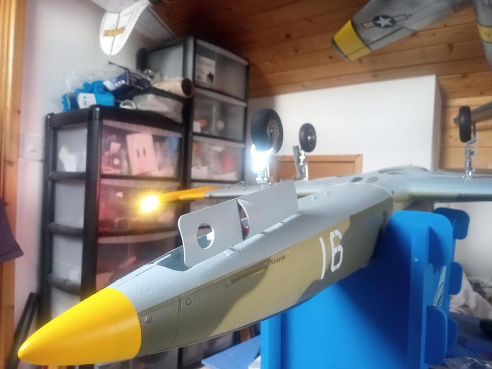

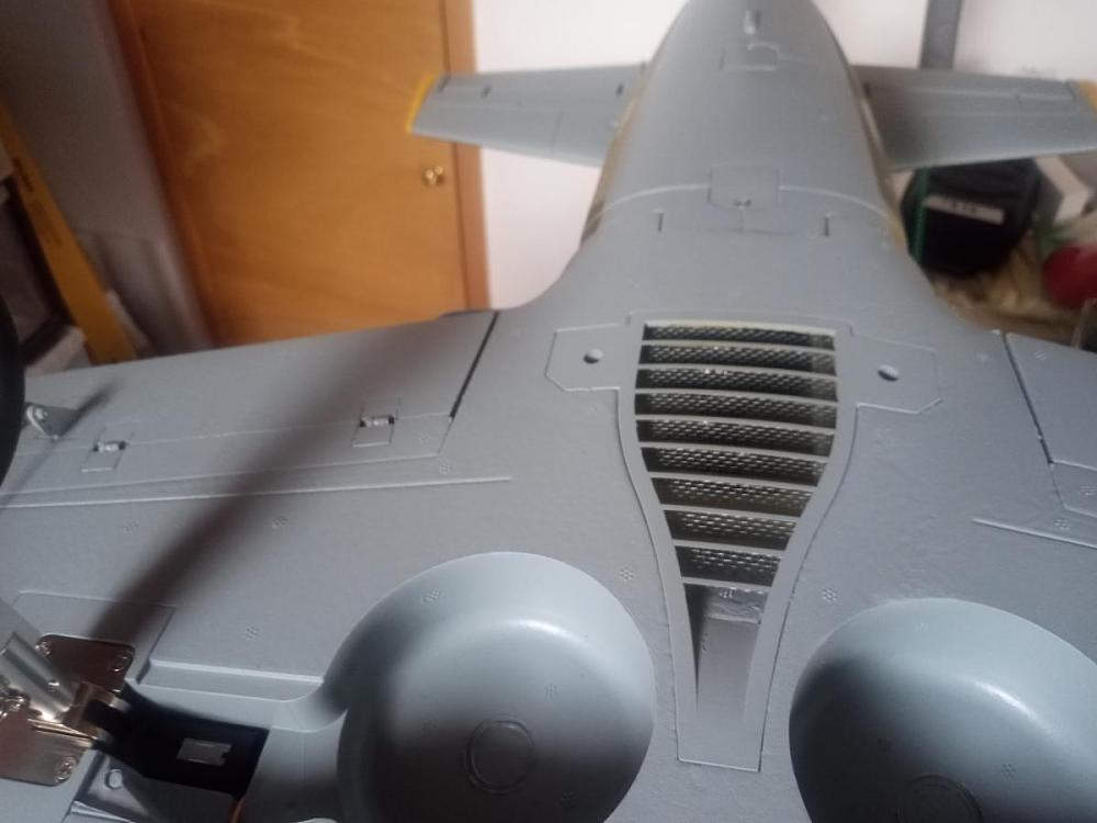

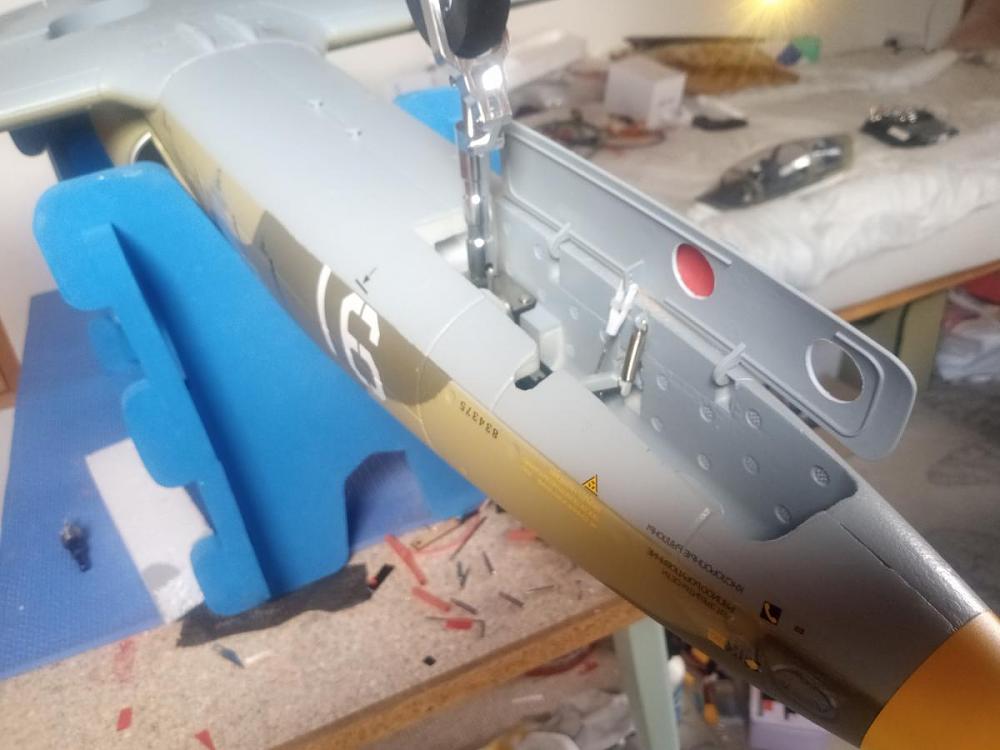

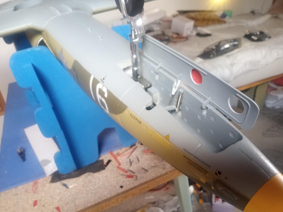

                                        Finally opened up the Albatros box, fitted the fms pro platinum series 80mm in-runner ( 2100kv 3.5kg thrust ) added the frying pan mesh guard to the cheater hole, painted the servos and connectors grey and added an air intake hole and an air scoop ( cut down a small spinner nose) mainly because Freewing went to the trouble of adding an air intake hole which clearly worked with gear down but not so good with gear up and gear door closed. Now all I need to do is add 6mm ply restraint/ v shaped centering piece to rear of nose leg and wait for the 30mph winds to subside before maiden flight later this week. I will be using Rhino 4000mah 50c packs and expect to get 3 to 3.5 mins flight time but I have a separate 6 to 10 amp BEC set to 5v output with with 370mah 2s lipo ( I normally use about 75mah per flight and swap after 2 flights.)

                                          There is no need for any auxiliary air inlets. I‘ve got two FW L-39 and both have the heater hole closed from both sides. I‘m flying off grass and tried it with a couple of different fan setups.
