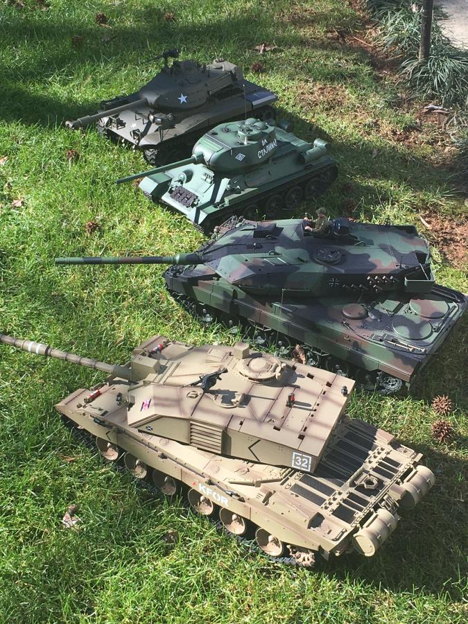

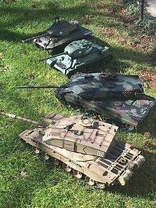

    Here is my latest FPV vehicle...

      Evan D Sweet line of tanks! It looks like FPV takes it to a whole new level. So do you have a center point of the camera? And does it line up with the center of the gun? Or at least parallel center? Or do you have a seperate gun camera?

          Some of my tanks have cameras in line with the barrel and that makes it really easy to aim. Unfortunately I want the camera hidden in a proper part of the tanks structure which means near the commanders or other cupola or hatch and not in line with the barrel. On my T-90 I fashioned a site in front of the camera to help aim. With the head tracking on the Challenger in the video I would need something like a heads up system or a front and rear site to look through. Anyway, it's new to me and I don't see anyone else really into it (yet). A friend is mounting his camera directly to his barrel with a 3D printed mount but I want it more hidden. My "click" group all decided to try this a month ago and we have four of us battle ready. Like most things I went a bit crazy and in 6 weeks bought and set up seven tanks. Luckily this is the first of my hobby stuff that my wife has decided she wants to participate in and we have a great little course set up in the undeveloped part of our back yard.
          They have IR transmitters and sensors that record main gun and machine gun hits and will incapacitate the tank after a set amount of hits. And yes, we also do the airsoft BBs. :)

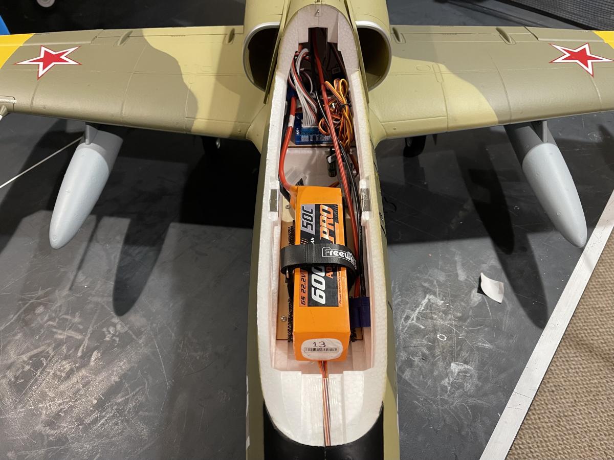

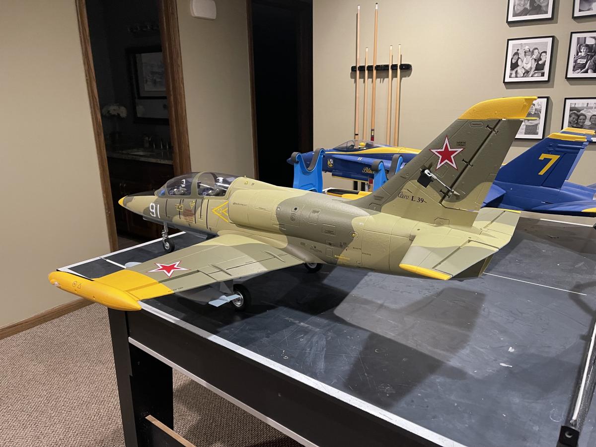

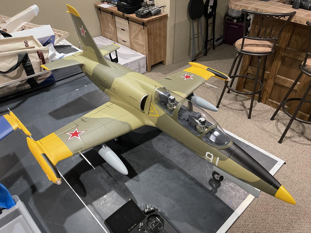

                    My L-39 arrived in the mail today, and I've gotta say that I am impressed for an 80mm jet to say the least. The thing that struck me first was the sheer amount of space under the canopy. It makes my Admiral 6S 6000 pack look tiny. Much more manageable than even my F-18. I plan on doing a turbine conversion with this jet in the future, and I chose the L-39 because of the rave reviews about its performance and the space for all of the equipment. Very excited to fly it soon! How does the book CG perform and what kind of flight times should I expect running 5000 and 6000 packs?

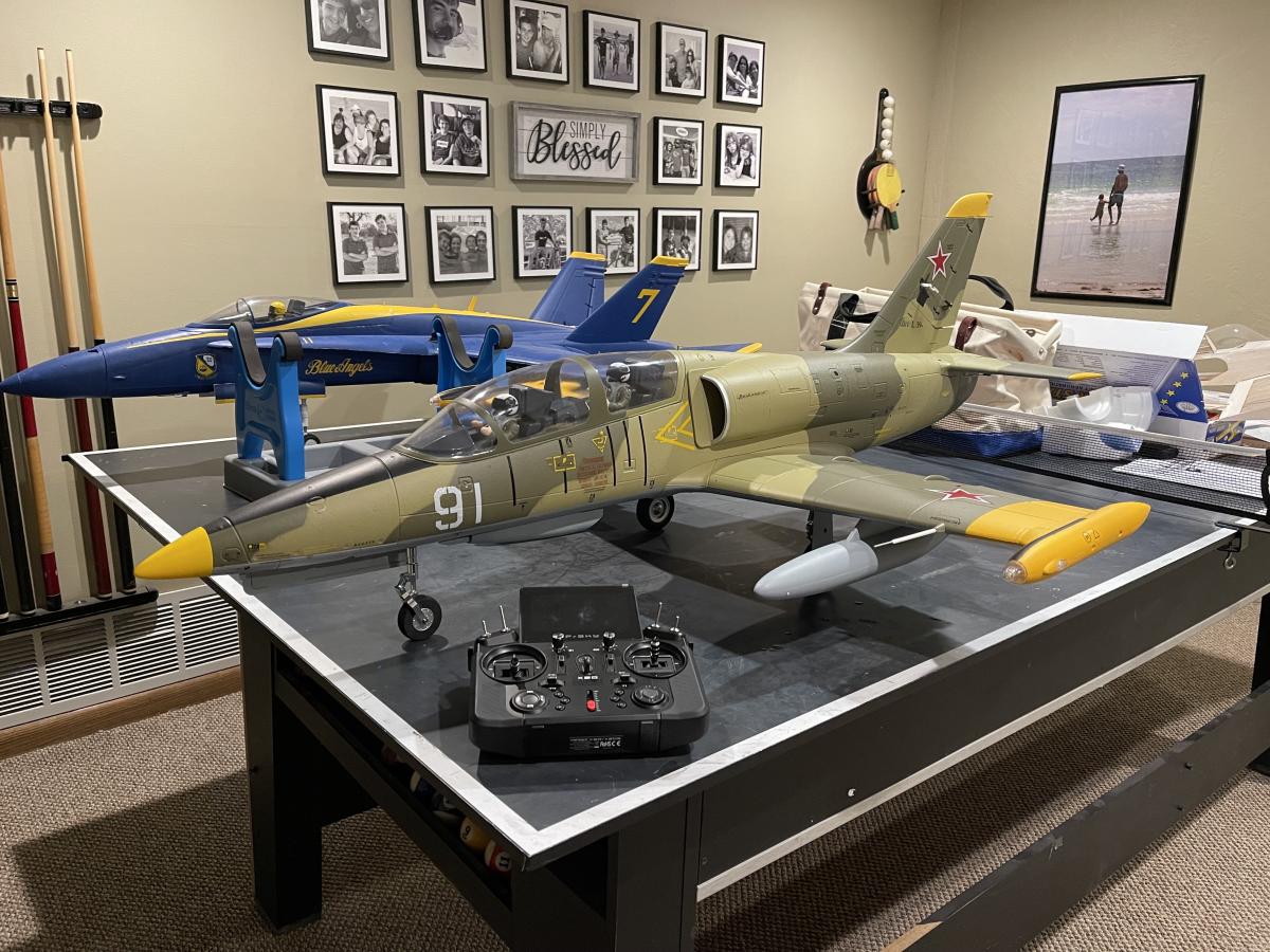

                                The 80mm WeMoTec unit is a „drop in fit“, but it requires a slightly smaller nozzle. Here‘s my 8s powered L-39. 50% more power than stock.

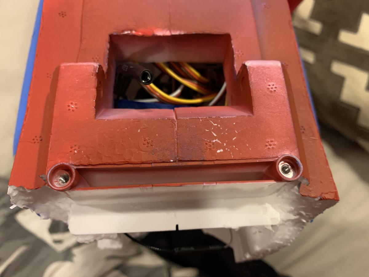

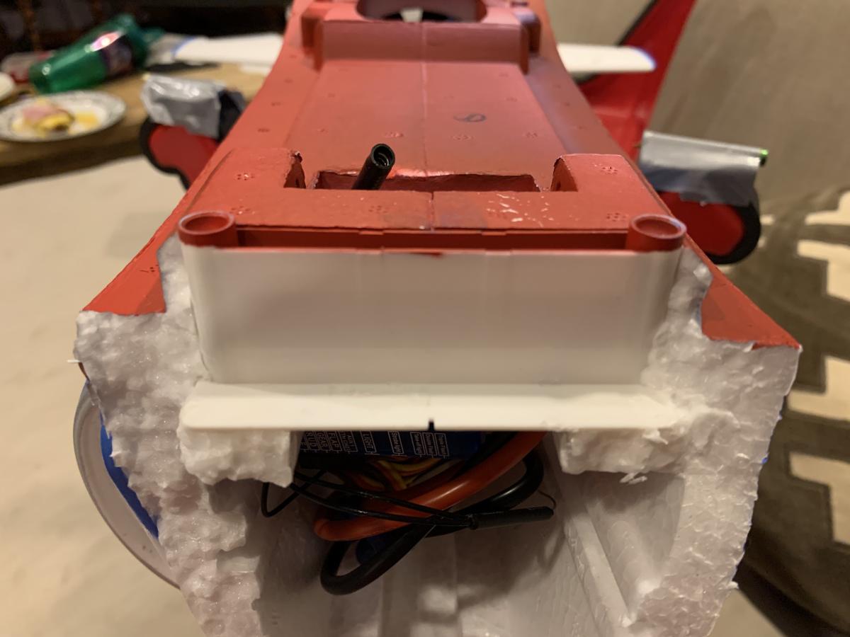

                                        Alpha

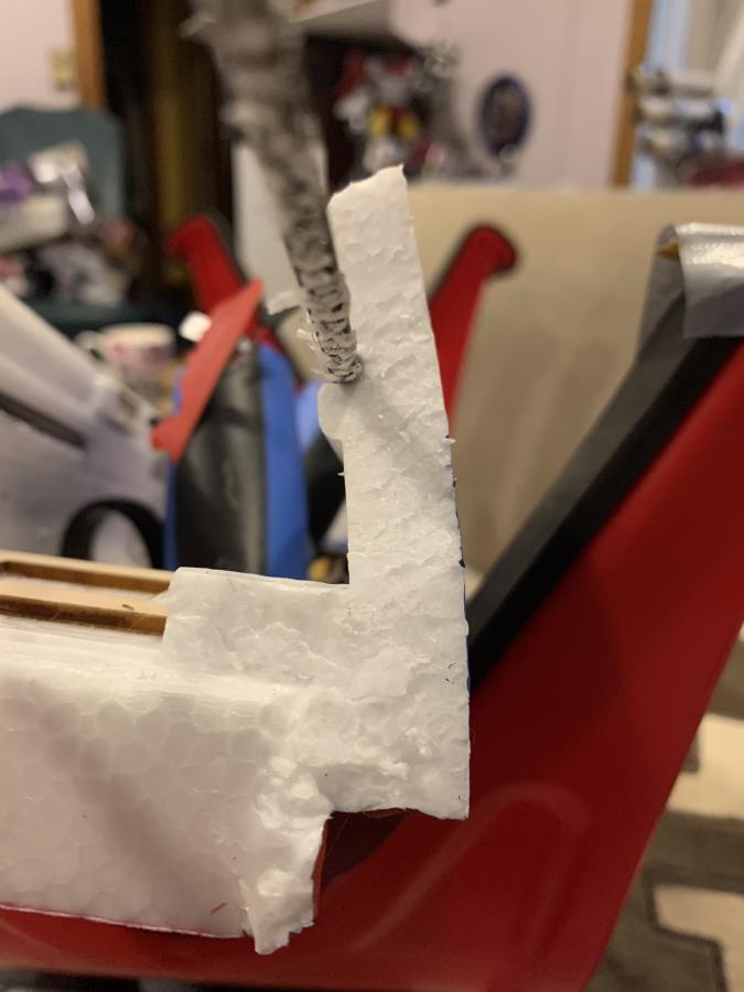

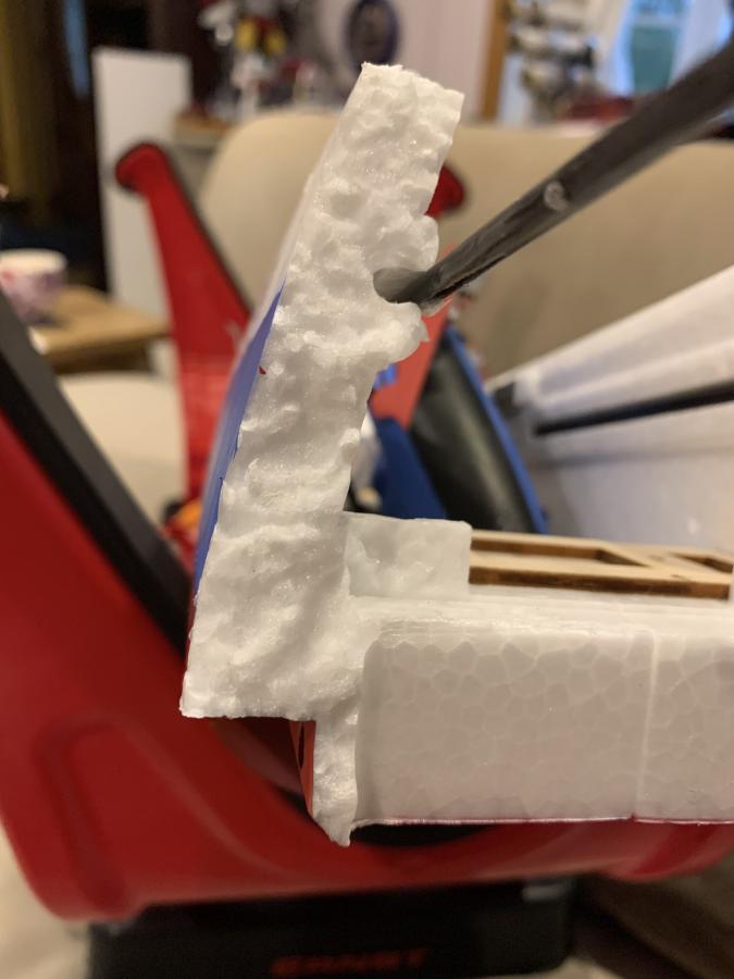

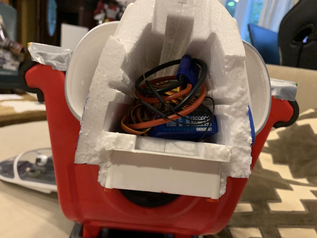

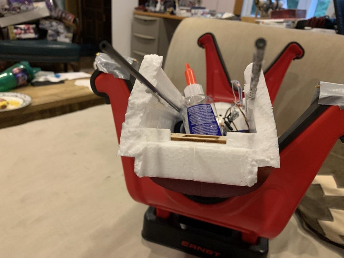

                                        Im not sure if this is normal but my L-39 has a major weak point in the fuselage. I had a minor rough landing into the weeds and encountered a partial fuselage break.
                                        I was on approach for landing, flaps down, gear down and the plane was banking slightly to port(I believe a flap servo had malfunctioned causing this), but correctable with ail input. As the L-39 passed in front of me I saw the gear hadn’t deployed and I was unable to get it to come out (blue box problem?). I ditched the plane in the tall grass at very low speeds and when recovered I found the fuselage had split just in front of the front wing screws.
                                        When I got home I surgically separated the rest of the forward fuselage so I could make better repairs. That’s when I noticed that there was no glue between the forward wing screw mount and the fuselage on either side of the plastic mount. This means the entire forward fuselage was connected to the rear by two lengths of foam 1/2 inch wide and 3 inch long forming the side walls of the fuselage. This was “reinforced” with the two round carbon fiber tubes that had broke loose during the crash. In the pictures below you can see there is not glue on the foam or plastic where the wing mount is. The port side of the fuselage is where it broke on its own and the starboard side I cut with a razor.
                                        I feel that this is an exceptionally weak point, especially with no glue in the 1x3 inch spot where the wing mount resides. I’ve crashed planes faster and hard and not had a fuselage with so little actual foam at the point of breakage.
                                        Alpha, help!

                                          You may want to contact Motion's customer service about this. Do it through their web site.
                                          The reason that gear don't extend 95% of the time is you have had a rough landing and bent the strut to retract unit pin slightly so the gear, when retracted, doesn't sense the retraction so it won't extend. After you get the gear to extend bend the strut forward slightly and it won't happen again until your next rough landing.
                                          Interesting term "minor rough landing".
