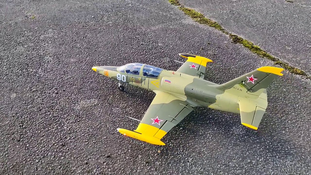

                        There you go, the first flight

                          Guipedroso Nice!! Welcome to Hobby Squawk from Texas!!! Good job Bro!! Jerry
