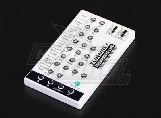

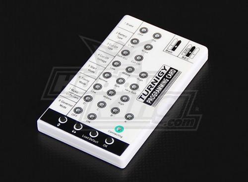

Thanks for posting the photo, I just ordered one. Can someone post the settings that should be used, at least that way I, and maybe a few others will not be guessing at what should be changed.Originally posted by HellHathNoFury View Post
TIA for all the help:Cool:
Read the instructions, it explains everything. The programing card just makes programing easier than using the transmitter sticks.
Brake Off
Battery LiPo
Cutoff Soft
Cutoff voltage Low or Medium. Low runs the risk of damaging the battery, medium ups the risk to cutting off power to the plane if you run the battery low.
Start mode Normal
Timing Low
Cell- not sure this is a choice in the ESC- Auto?
Governor Off
If you use the default settings you'll be good.
- Likes 1
I have that card but personally, I've never found the need to use it. One would only use it to either confirm what's already in there OR to change some or all of the parameters OR to put it back in the event that you accidentally changed something when you were trying to do a throttle calibration, in which case, would you even know what parameters to put it back to? Most of these ESCs come ready to go with the default settings out of the box. For throttle calibration, you don't use this card anyway.Originally posted by HOSSINARIZONA View Post

On the contrary..Default timing on HW escs are usually Med ( check for yourself)so need to be changed to Low especially for the Inrunners & the Card makes this simple..I usually set my battery cutoff to the lowest .. Not that I would run it down low but on the off chance it happens it’s cheaper to lose a Battery than a Plane..:)Originally posted by xviper View PostI have that card but personally, I've never found the need to use it. One would only use it to either confirm what's already in there OR to change some or all of the parameters OR to put it back in the event that you accidentally changed something when you were trying to do a throttle calibration, in which case, would you even know what parameters to put it back to? Most of these ESCs come ready to go with the default settings out of the box. For throttle calibration, you don't use this card anyway.
Hmmmm ........................... I've never messed with stock programming unless the plane performs oddly. So far, using the settings as they come, have been quite satisfactory for me, so I don't want to risk screwing something up, which I fear I'm likely to do delving into stuff I know very little about. The only time I fiddled with the programming was when I transplanted components into a different plane and quite frankly, I couldn't tell the difference in the way the plane performed no matter what settings I chose. Instructions I've read on some ESCs I have, have indicated that "med" or "auto" is sufficient for general applications. Sports cars, I tweak. Model planes, I usually leave it as is.Originally posted by HellHathNoFury View Post

You can’t Dork the timing unless you set it on HighLOLWith low timing you’re running the fan more efficiently & not wasting output as extra heat..Tweaking Edfs I love :)Originally posted by xviper View PostHmmmm ........................... I've never messed with stock programming unless the plane performs oddly. So far, using the settings as they come, have been quite satisfactory for me, so I don't want to risk screwing something up, which I fear I'm likely to do delving into stuff I know very little about. The only time I fiddled with the programming was when I transplanted components into a different plane and quite frankly, I couldn't tell the difference in the way the plane performed no matter what settings I chose. Instructions I've read on some ESCs I have, have indicated that "med" or "auto" is sufficient for general applications. Sports cars, I tweak. Model planes, I usually leave it as is.

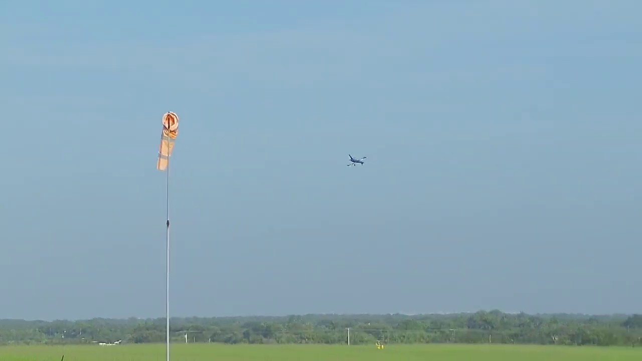

Decided to try and get some video of my Arctic Aggressor repaint today since I didn't get any yesterday while doing the F-18 maiden. I only took two batteries along so I'd leave the field earlier in the day as well. Yesterday about killed me staying til noon. I was on my way back home before 10:00 this morning and as a result, don't feel as dead. I was flying a bit on the aggressive side for this video and tracking left a bit to be desired. I didn't allow quite enough weight shift for the flight pack to compensate for the extra weight of the tag and was a little nose heavy as well.
I wasn't flying as aggressively on this flight as I did during the "Arctic 1" and the Soloshot tracking worked pretty good overall. Even if it hadn't this would have been my "keeper video" just for the landing. It's not often that I make a nice smooth one, and even more rare is for it to be caught on video.
