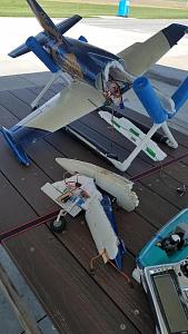

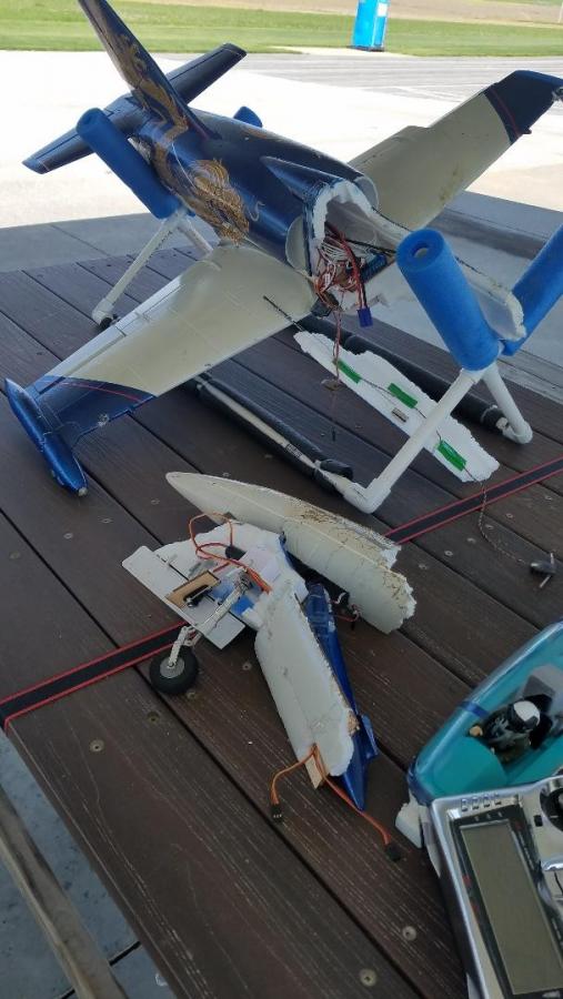

    Well it happen but State Farm cant cover that. Seems my 6s 6250 may have took a hit as it lost control even after pulling power to nill and still no control regained. Tested battery on internal IR and total was 15ohm with average of 2.5 ohms on each cell so not sure. All radio checks fine but when I plugged the battery up and tested at 25-30% power it dropped like a rock on the cell checker. Just as i was turning base to land too!
    Good news in this, really, you think? Yes the Dragon is still fully intact and im thinking of a Frankenstein resurrection of graphing a new fuse to the front from the intakes forward. What would you do?

    Your L-39 looks really great, sorry for your accident, so as you said, I would use a new fuse front! Get it up again

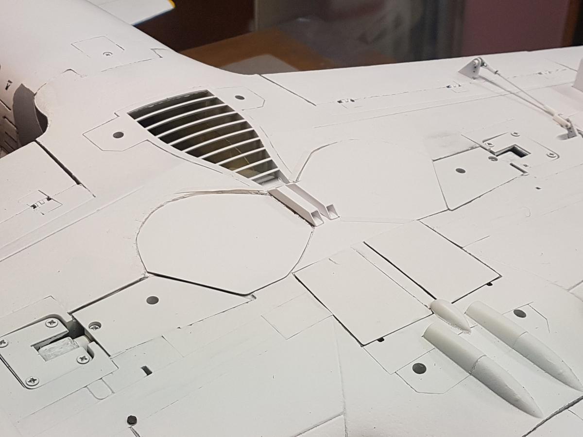

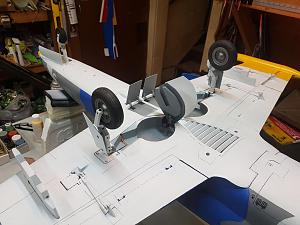

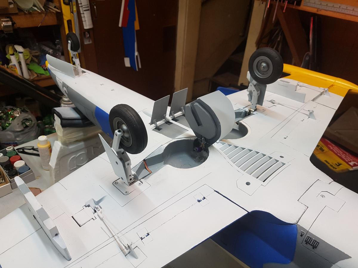

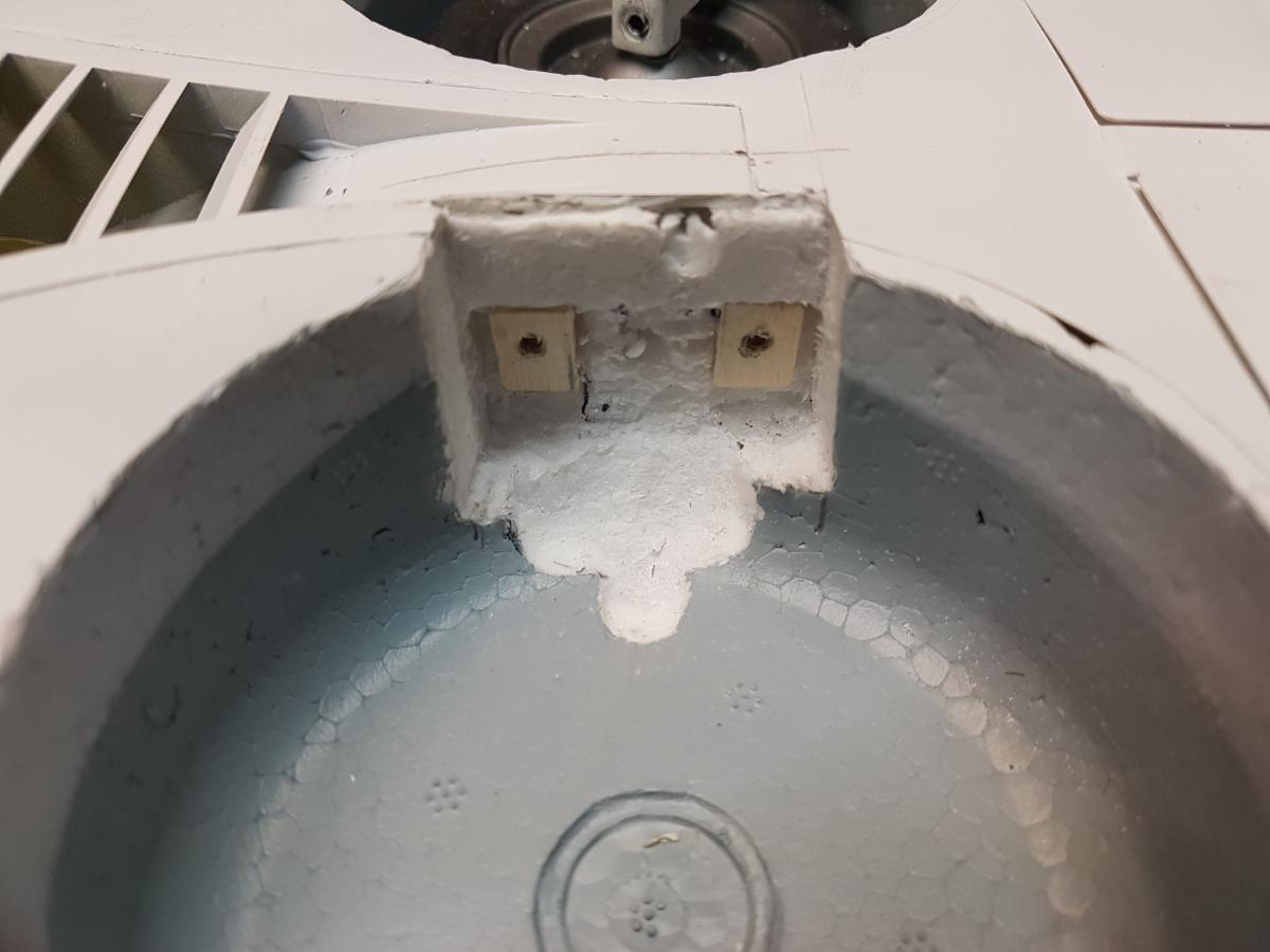

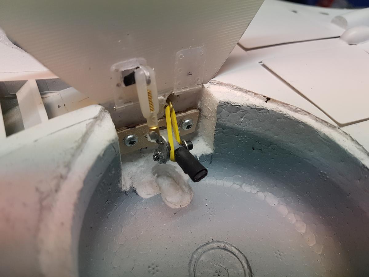

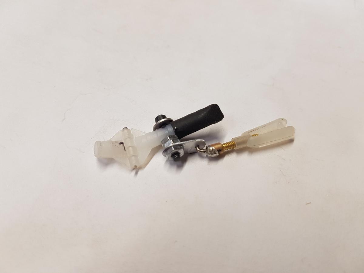

    I just completed the main gear doors on my L-39 after struggling for ages to get the 2nd one to work. The first door went well and operated fine right off the hop, the other one not so much (go figure). Hours of fiddling but finally got both working reliably on the bench and hopefully in the air. As can be seen the opening and closing is quite abrupt but such is the nature of mechanical, as opposed to servo, operation I guess. I've used an elastic to hold the doors open but will try to source some springs at some point- there's a fine line between what feels like enough spring tension to hold the doors open in flight and too much tension which stalls the retracts as they try to close the doors.
    I just hope the retracts continue to work for awhile as they've been subjected to maybe a thousand or so cycles in the last few days!
    A little video:
    https://www.youtube.com/watch?v=BuXD...ature=youtu.be

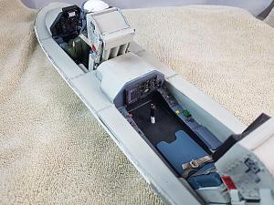

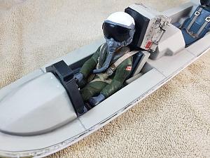

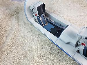

    3D Printed parts:

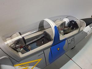

    MotionRC is all about choices and with the 3DP upgrade parts the choice is all yours ;) Files will be available to download on the top tab of the listing for free for printing yourselves or alternatively they will be available to purchase under the upgrades tab and should come with a bass white ready for your own finishing paint. Below are examples of the 3DP parts painted by Alpha with just a few hours work. I think you can all see the results talk for themselves:

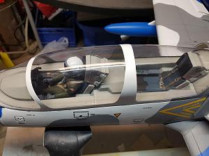

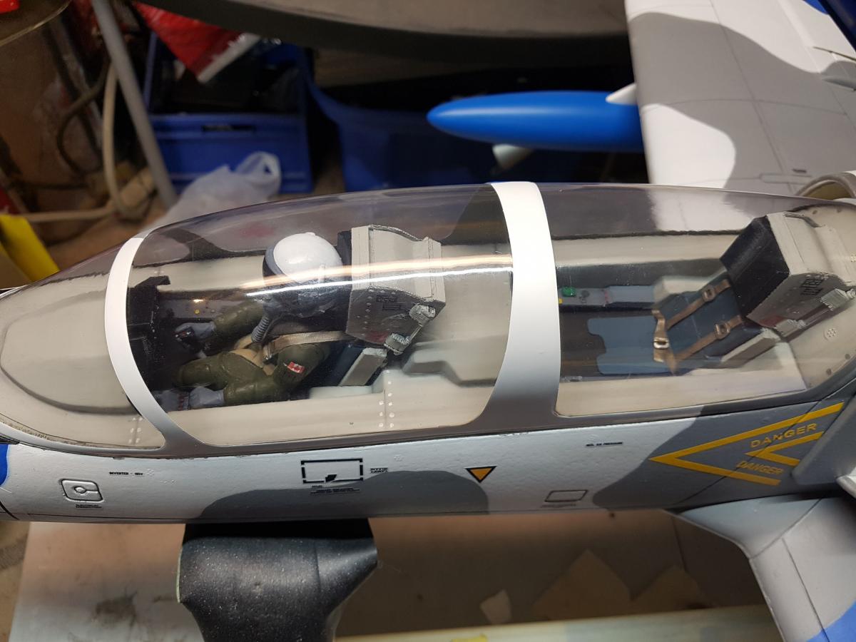

ID:	245415 A pal at work printed the cockpit parts someone at Motion designed (was it you Alpha?- thanks!) and here's the finished product. The pilot is a Canadian F-18 driver who destroyed his aircraft and got sent on exchange to the Royal Thai airforce as punishment (?). Hope everyone is well.
