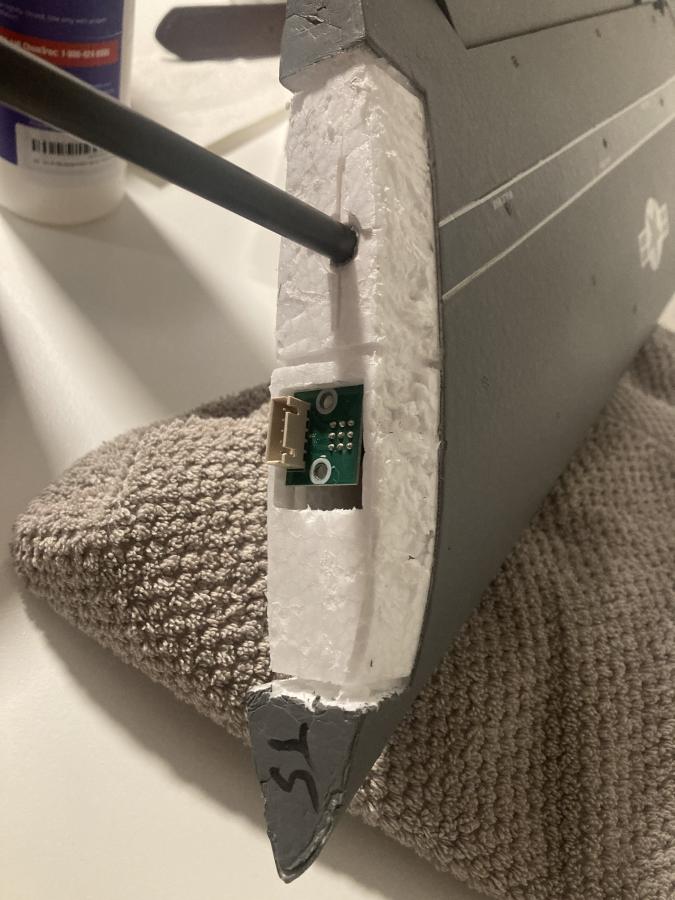

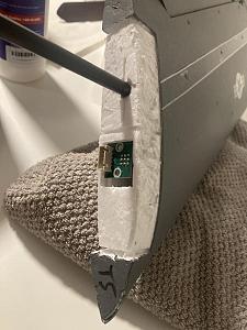

                        Here’s a tip which might prove useful in the future for this and other planes…..
                        Problem: How to remove the broken/damaged plastic wing root piece?
                        Comment: This is a multi-faceted molded plastic unit that is strongly glued and embedded in the foam root….in this case the root of the outer wing panel. It can’t be removed by simply sliding a long razor knife blade between the foam and plastic. Too many embedded and hidden twists and turns.
                        Solution: WORKED like a champ! Step 1) is THE KEY! Results in very little foam damage. Ready for a new end cap when done.
                        1) With a Dremel-type tool, cut through the top and bottom lengthwise/chordwise 90 degree “corner” areas. By removing this plastic, you will be able to access the glue area between the top side and bottom side “flat” pieces of plastic that form the top and bottom of the plastic unit.
                        2) Slide a razor knife into the cut-off areas you can now access after step 1). Use whatever other tools you need to peel away the topside and bottom side flat plastic pieces of the plastic. Some addition Dremel tool cuts will need to be made at the front and back. End result is that you will have removed 2 rectangular pieces of plastic which formed the top and bottom sides of the root end cap.
                        3) Now attack the “vertical” flat face of the end cap. Remove as much as you can. You’ll need to unscrew the electrical connection panel and move it out of your way. When finished, only the embedded areas of the end cap will remain.
                        4) Use a razor knife and cut through the glued areas around the embedded pieces for easy removal.
                        5) You are finished, and you haven’t damaged the finish of the wing areas around the root end cap….no digging or poking required that might have damaged the area around the cap.
                        -GG
                        Click image for larger version  Name:	A97C73EB-EDC2-46DE-B9F4-C32268822861.jpg Views:	0 Size:	76.2 KB ID:	372015

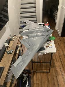

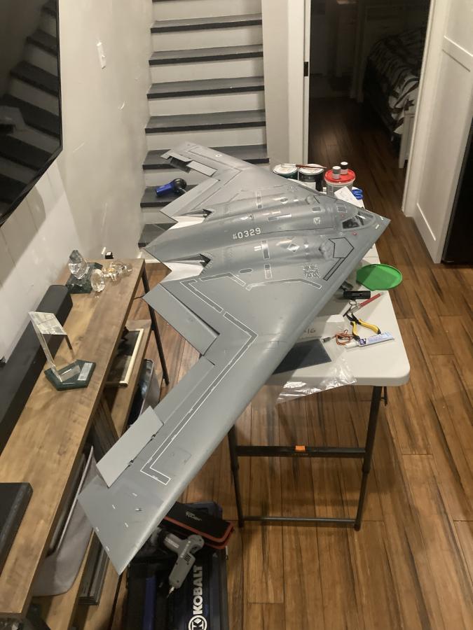

                          #1372
                          The plastic root cap for the left outer wing panel arrived today. She’s ready to fly again. Woo Hoo!
                          So much foam fracture and wrinkle repair was needed around the nose area that I couldn’t save the decals in front of the intakes. I improvised with the black stripe stick-ons from the P-38 decal sheet. I won’t tell if you won’t tell. 😉. If it bothered me, I would buy a $30 decal sheet. It’s a don’t care for me. I just want to fly her.
                          If you haven’t read my post 1371, that technique saved the day. Not sure how one would remove the end cap without doing bad foam damage otherwise.
                          I replaced both elevator servos. One failed and both had a ton of flights on them. Replaced the nose gear retract servo, too. It was in bad shape.
                          If you ever need to repair a crushed nose, the flat, palm-size area on both sides of the cockpit can be cut away with a razor knife. This exposes a hollow area in which you can work. Bondic UV-cured glue was used to repair the fractured nose cap’s cracks.
                          Again, nothing needed to be done to the mains…no damage at all. Shows that I almost saved her….not a hard impact. If that darn rock had been somewhere else, it would have been a nose gear repair, only. See post 1366…
                          -GG
                          Click image for larger version  Name:	8A879829-E0D9-44E5-93DB-154D96147D94.jpg Views:	0 Size:	75.8 KB ID:	372334
