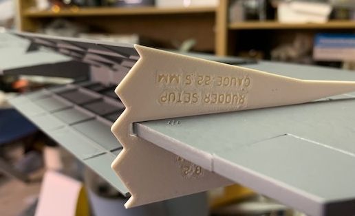

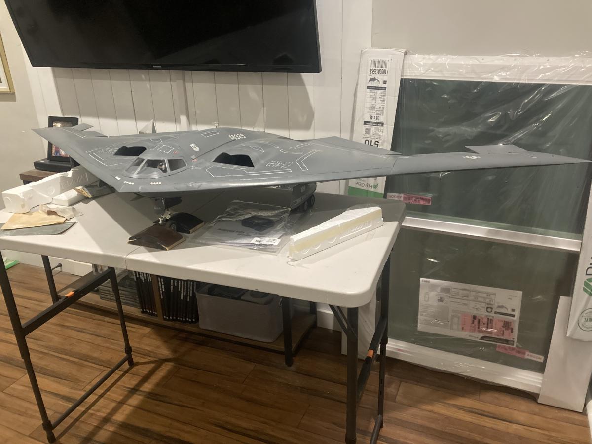

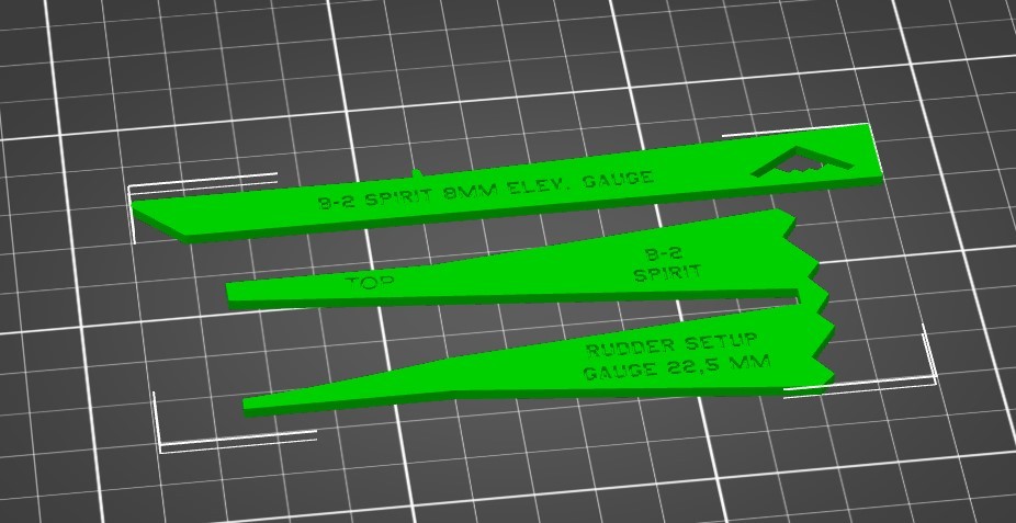

      Originally posted by Radar-Guy
      I didn't like the fiddling with rulers while setting up the control surfaces, so two gauges were created and printed. +/- 25mm for the rudders, 8mm Up trim for the inboard control surfaces measured at wing bottom. In case someone is interested in the STL files, I'll put them on cults3d. Just let me know.
Name:	Screenshot 2022-04-14 123205.jpg
ID:	342949Click image for larger version
ID:	342948Click image for larger version

                    Originally posted by Bearcat
                    I would love to see this myself- post a link if you haven't already.
                    Here you go
                    https://cults3d.com/de/modell-3d/ver...ce-setup-tools

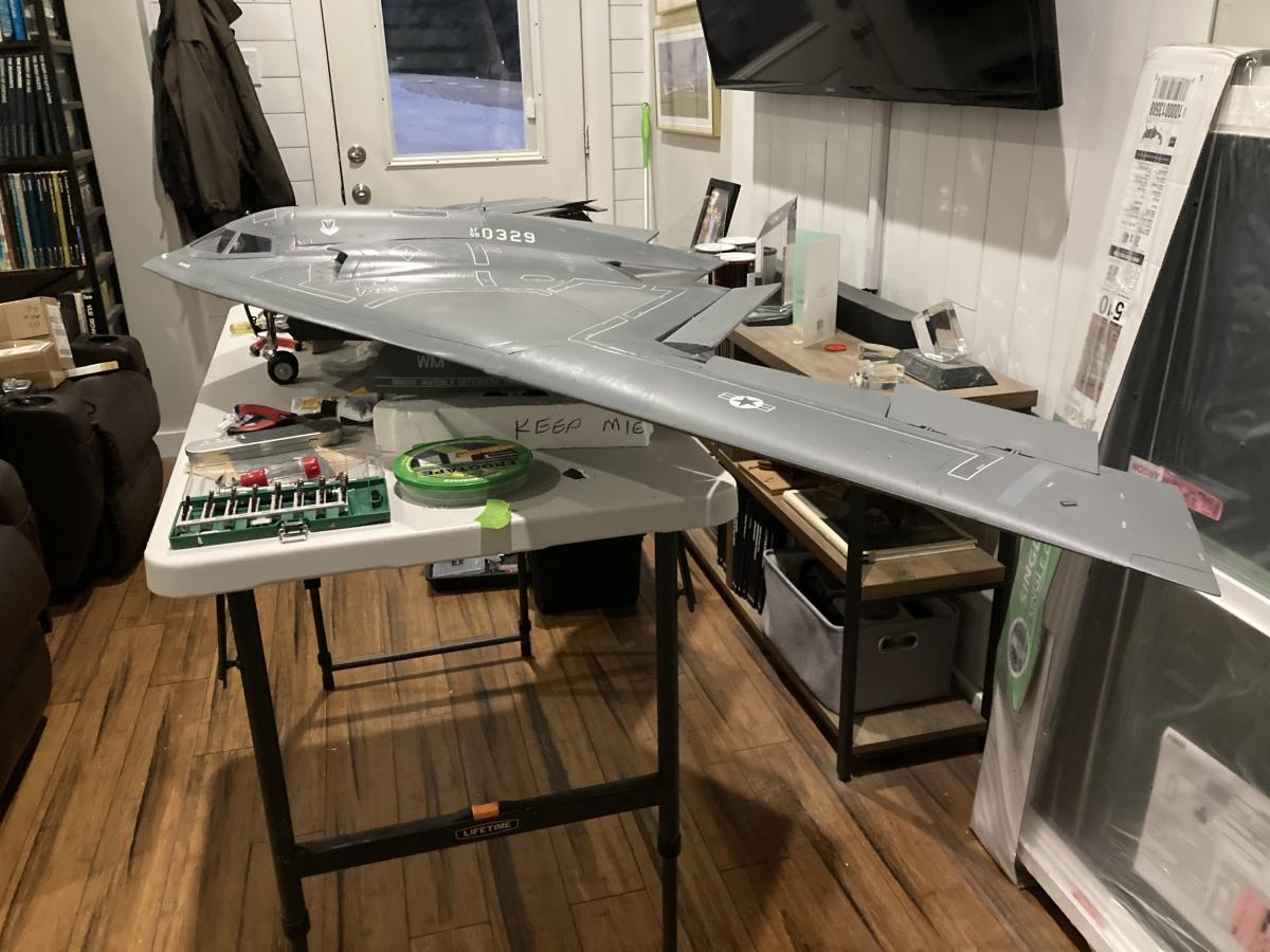

                        Almost 2 years of putting the B-2 through its paces, and…increasing the chances that if something can go wrong, something WILL go wrong. UGH.
                        A few days ago, shortly after take-off, the motors went dead stop. No cough, no sputter…just 100% zero thrust. Being slow and in a nose up attitude at about 50 ft altitude, a recovery wasn’t in the cards. Nosed in. Hate that when it happens!
                        Once home, everything functioned normally. So, toss it up to a rare system Gremlin. Rare indeed, considering how much flying time my radios have on them….thousands of flights.
                        A comparison was made between two crashed B-2s on hand. The oldest went in after striking a wire antennae and has been serving as a spare parts hangar queen for bird #2. But, #1 was in better shape. So 20 hours of work making one bird outa 2 birds paid off. #1 bird is ready and WILL FLY AGAIN!
                        Waiting for good weather to maiden this Phoenix bird.
                        Note: Ignore the extreme control positions in the photo…not flight position.

                            #1453
                            Ref post 1451….SUCCESS!!!
                            She flew perfect this morning. Woo Hoo!
                            The Phoenix has arisen from its year+ of storage after it crashed and became a hangar queen for spare parts to keep #2 B-2 flying.
                            -GG
