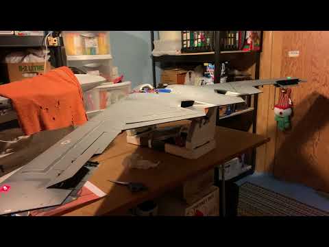

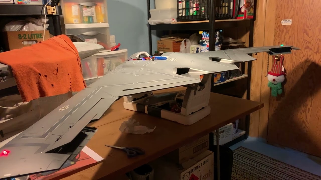

                              GG ................... Please explain what "flower flap" is? How is it different than the stock set up where entire control surface acts in unison for ELE (as a single elevon)?
                              Like this .........................
                              (I only made this video to show my "drag brakes" but it's also useful to show the stock elevon set up.)
                              • LOL - Gotta love autocorrect.
                                LOWER FLAP command please.
                                Again, it’s a fake out. There are no flaps per se.
                                I noticed when lowering the gear, the CG change caused a slight pitch down. So I slaved the elevator channel to the flaps channel on my TX. When I put the gear down, I switch the “flaps” down and the slaved elevator moves up a small amount in response.
                                I run the Admiral 6,000 also and with the added touch of up elevator, she easily gets off with a normal run distance.
                                Fowler flaps I know about (not on the B-2).
                                Flower flaps = TYPO
                                -GG
                                • OK, I follow now. Auto-incorrect. Gotta love 'em.
