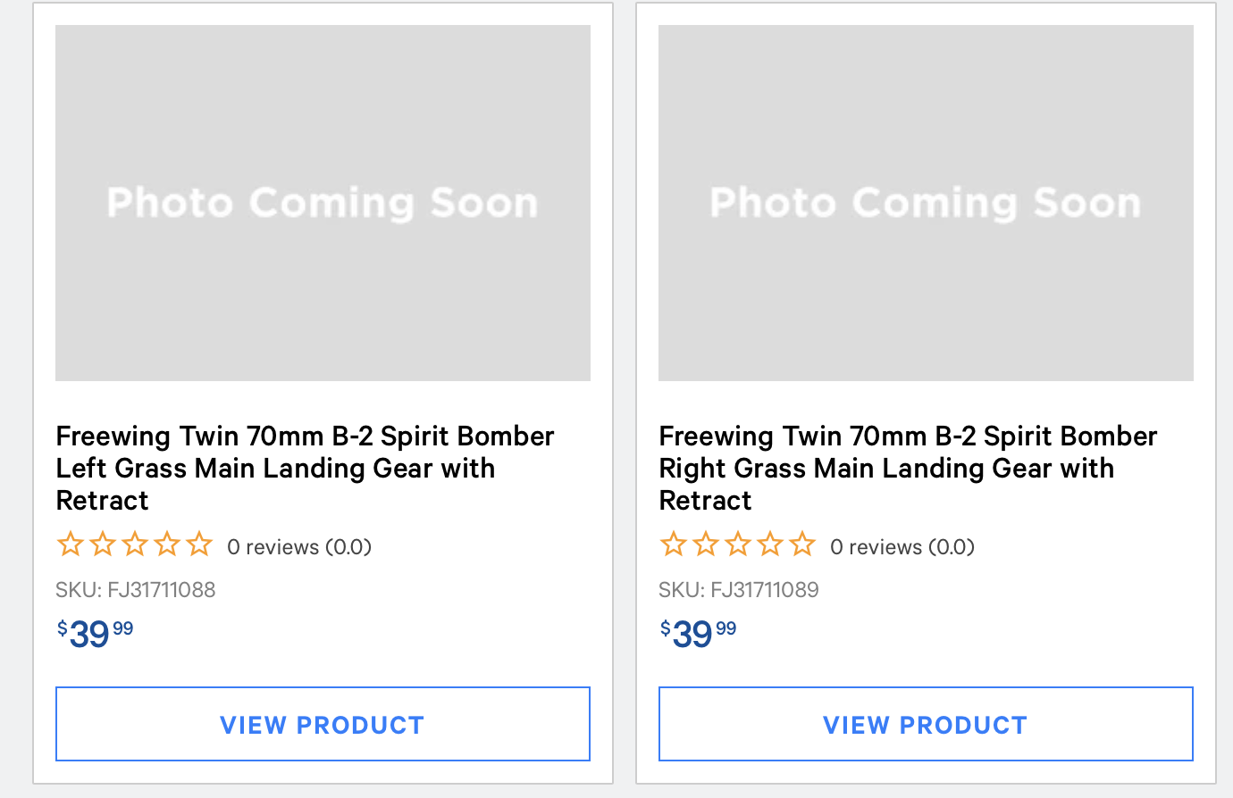

          Not sure anyone's seen this yet but it looks like motion put together a grass ops retract kit....I put an order in for a set. I'll post pics of what they look like when they arrive next week.

            Nice find, Rudy. I do have a grass field that I'd like to fly this plane from. I would very interested to see what these new wheels look like and how tough it would be to swap them in and out as desired.

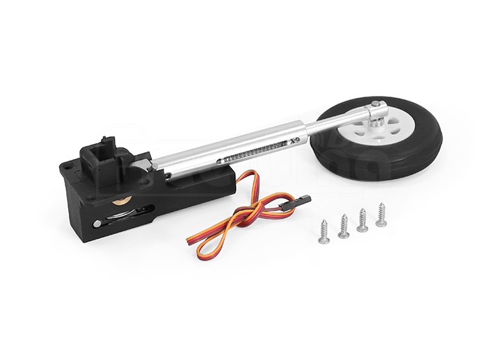

              Rudy, they look like this:
              They are rotating retracts, much like on a Corsair. The whole retract would need to be swapped out. It may even be possible to increase the size of the tire a bit to make it that much better for rolling on grass.

                Sweet...Luckily the rear retracts are pretty easy to remove. 5 minute swap at most.
                  • 8835
                  #1328
                  I don't recall where the first connector is. If it's near the wheel well bay, then yes, it'll be easy.
