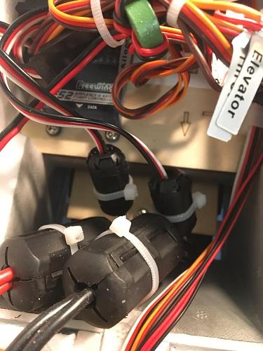

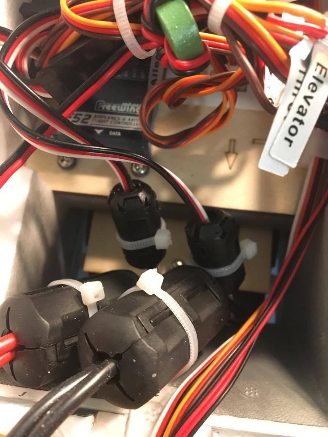

                                      Perfect bay for the RF Chokes. Plenty of room. Get them as close to the ESCs as possible.
                                      Amazon has several options. Here is one.
                                      https://www.amazon.com/Cedmon-Pieces...s%2C109&sr=8-3
                                      Don’t leave home without them…as has been discussed on several forums. High current ESC birds benefit from them. Reduced chance of a radio glitch caused by the RF noise emitted by the ESCs.
                                      Fly without them at your own risk.
                                      -GG
