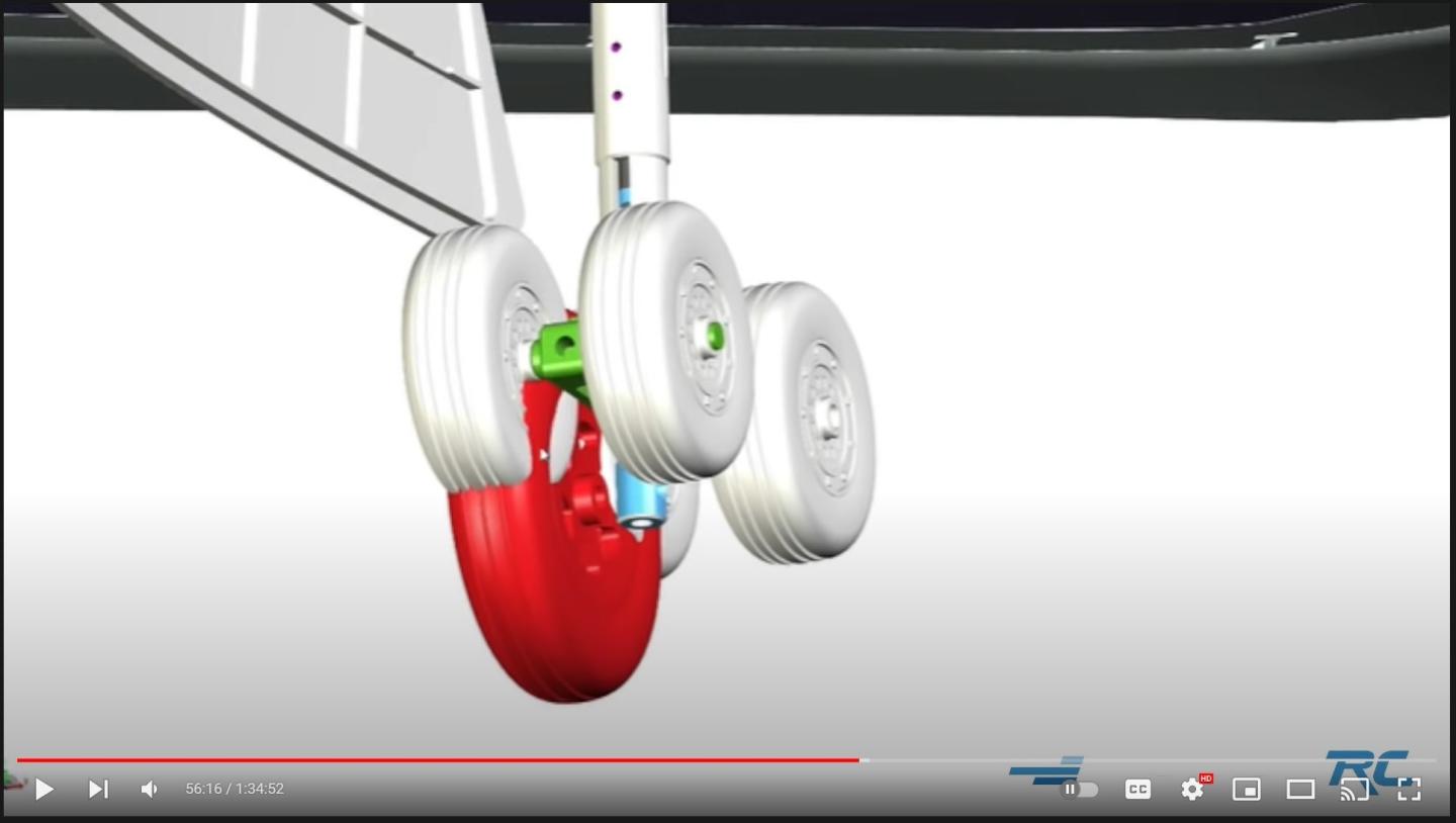

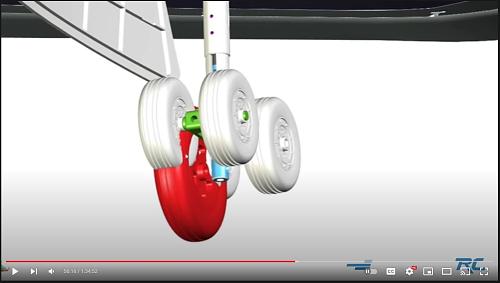

                  Is it possible to fit larger wheels for grass ops? I remember alpha showed some CAD of larger wheels but not sure if there is space in the wheel well.

                          Alpha was using a twist and turn retract (like the Corsair or MiG 29 mains) to fit the larger wheel in the CAD drawings. If you look at the front side of the gear bay, you can actually see the molded panel lines marking where the bay would need to be expanded to fit this larger wheel. So yes, should be possible but will take some alternate retracts and some foam cutting.

                            Re: larger single wheel. Those who have this model would be the best ones to comment on this. Take a look at the size of the wheel wells. The way the main wheels are angled, they take up a lot of space and those wheel wells appear to be quite large. I think a fairly large singe wheeled strut could work in there. As for the nose wheel, that might be a limiting factor as the well doesn't look any bigger than any of the other double wheeled nose gears I have (eg. AL-37, PJ50 and assorted military jets).
                              Doing some quick measurements, it looks like the largest wheel you could fit in the stock bay would be around 2.5” diameter. Of course, you’d either need to swap struts, or reconfigure the stock struts to grip a single axle instead of the bogie arrangement.

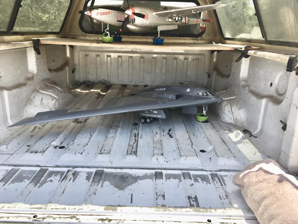

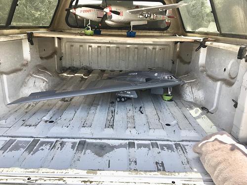

                                It FITS!
                                You can see how ramekin cups (P-38 wheels on top shelf) do a great job holding wheels. Then I use mini-bungees secure the wheels into the cups.
                                Ramekin cups fit large MiG wheels, too. WalMart has them. Glue them down with RTV silicon rubber. Then you can simply twist them off should you need to haul something. Then re-glue.
                                Look closely on either side of the B-2’s right main. The mains won’t fit ramekin cups I have. You will see a black clip on either side of the right main. I will run a mini-bungee from clip-to-clip across the main to secure it.
                                One mini-bungee wraps around the base of the nose gear’s ramekin. Then a second mini-bungee clips to the base bungee goes across the nose wheel and clips to the base bungee’s opposite side.
                                Secure a main and the nose….you’re done.
                                As a final touch, I used the shipping crate’s plywood planks to bridge the truck bed depressions. Now, the main gear trucks sit level on the plywood bridges and are under considerably less stress.
                                Someone suggested keeping the crate’s nice plywood. Bless that person!
                                For those with nicely carpeted beds, use Velcro to secure the ramekin cups to the carpet.
                                Now if only the wind would stop blowing!!!!
                                -GG
                                  I think someone mentioned just swapping in a complete set of struts/tires from another plane. Perhaps known trailing links that have worked well on other planes.

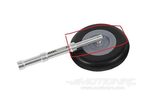

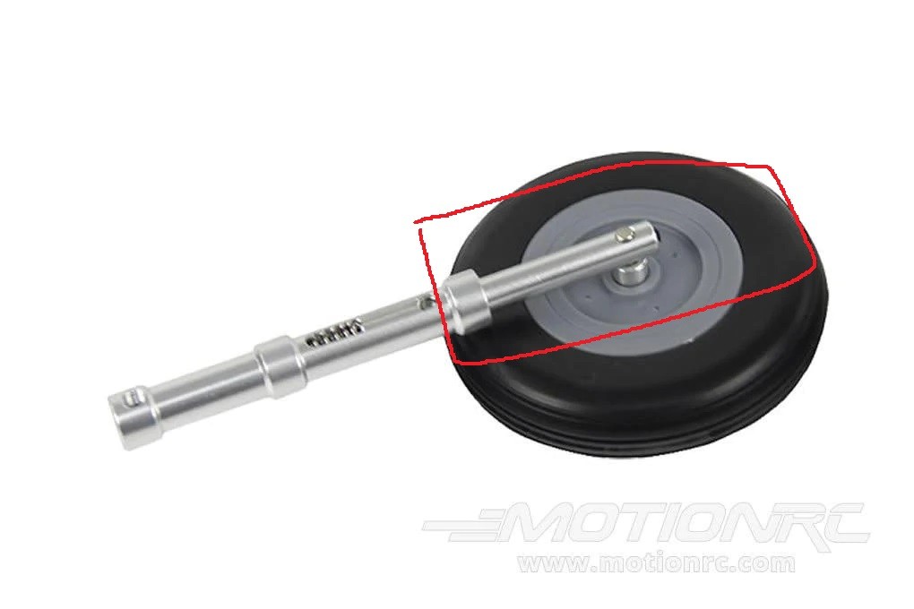

                                          Based on the CAD work in the live stream i was picturing a solution where you simply swap in the lower part of the strut from something like an me262 oleo. Just need to find something that fits in the upper half of the strut and has appropriate clearances. Perhaps the wheel trucks can be removed completely and swap in a more conventional axle.
                                          The B2 struts do look fairly robust so some mesure, fit and testing would be needed. https://www.motionrc.com/products/fr...085#hash-tab-5
                                          Click image for larger version  Name:	b2grass.jpg Views:	0 Size:	62.9 KB ID:	342927Click image for larger version  Name:	freewing-70mm-edf-me-262-main-landing-gear-strut-and-wheel-motion-rc-26232477772.jpg Views:	0 Size:	48.0 KB ID:	342928
