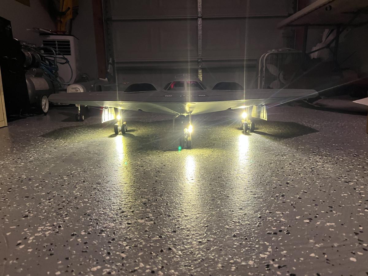

                    Got the LED landing lights all hooked up and wired in...
