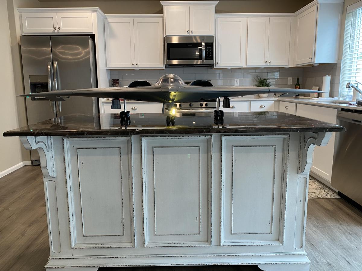

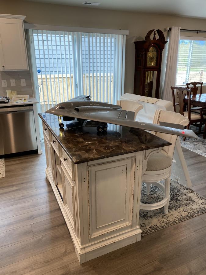

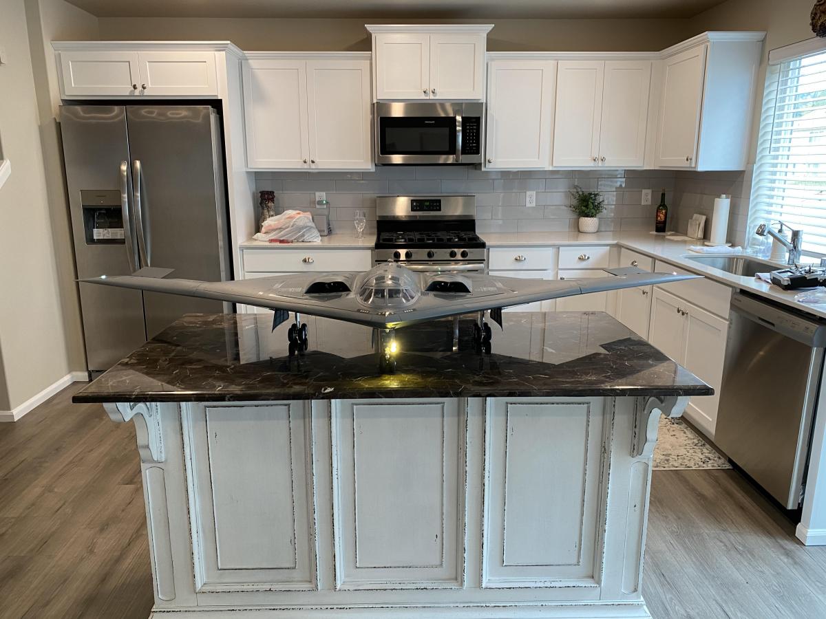

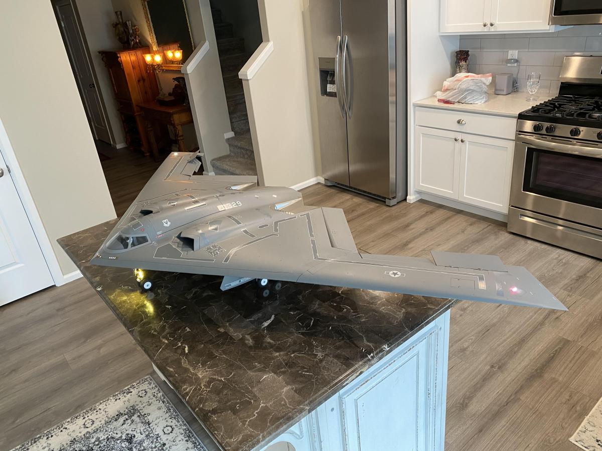

      • Great report GliderGuy! Glad you are enjoying her. I put mine together yesterday, she is everything folks have been saying as far as presence and quality. I haven't dialed in the rates/trims yet...Just bound her up for some photo ops on her feet. I did push the sticks around and everything seems good except for the elevator response. When I would advance the stick up and down fully the elevators would twitch but barely move. The ailerons and drag rudders had plenty of deflection. Any ideas? I checked all the connections and everything "looked" tight and secure. I just plugged all the available leads into their proper ports with the right polarity. The controller/gyro is all plugged in and secure, I didn't change anything there.
        I'm sure it's nothing and I will get it figured out. I cannot wait to maiden this marvel!
        • Is your red light solid on the gyro? Other than that, you might try unplugging and re-plugging each connector. Maybe something isn't making contact.
          Check that each of the "single wire' connectors is connecting the single wire to the signal side of the RX. ignore the color of the single wire connectors.
          Nice photos!
