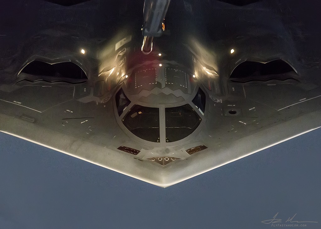

              #646
              Originally posted by avanti127
              Got the LED landing lights all hooked up and wired in...
              I have all of the items I need to try to get this accomplished too. Do you have any other installation photos / videos of your procedure? Looks awesome and surprised they didn’t include this in the model. I’m also going to add the refueling guidance lights to the top.

                    #649
                    My LED's I ordered for the top just arrived today so I will be completing the top refueling lighting as well. I will post pics later.
