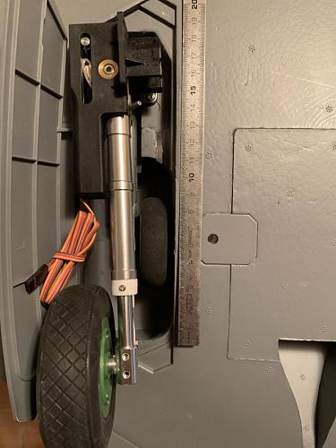

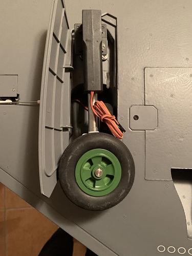

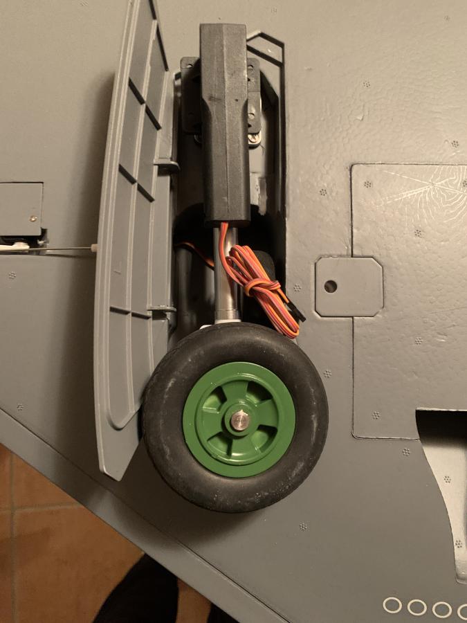

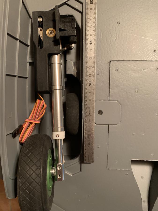

  • I think I'm going to investigate whether or not the Mig-29 mains could be used as a replacement for grass ops. May require the removal of some foam (hopefully at the mold marks) but should allow the gear to be fully enclosed in the well with the doors completely closed. I flew my Mig off the grass for the first time last Saturday with no issues, so hoping this will work for the B-2.
      Not just some foam….

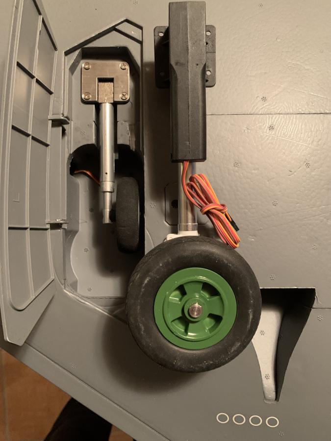

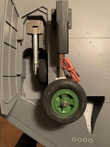

          OK, so negative on the Mig-29 retracts. I wonder if the Corsair mains would work. I need to find some measurements as I don't have one.
          • OK, negative on the Corsair mains as well as they are 85mm tires and the max I can use is 60mm. I may do what Frank did and go with T-45 mains and the "frankenstrut" and 50mm nose wheels.

              • I ordered up:
                Two Nose Wheels:
                BenchCraft 55mm (2.2") x 15mm Treaded Ultra Lightweight EVA Foam Wheel for 2mm Axle
                BCT5016-098
                Two Main Wheels:
                BenchCraft 64mm (2.5") x 24mm Treaded Ultra Lightweight Rubber PU Wheel for 3.1mm Axle
                BCT5016-077
                Two Main Wheel Struts:
                Freewing Stinger 90 Main Landing Gear Strut
                FJ305110811
                Two Main Wheel Axles:
                Freewing Stinger 90 Main Landing Gear Wheel Axle
                FJ305110812
                Two Main Strut pins (Just in case):
                Freewing Stinger 90 Main Landing Gear Connecting Pin
                FJ305110810
                I have not dissasembled the main retracts to see what size the main strut pins are....betting they are 5mm. If they are the 90mm Singer struts may need drilling out for 5mm.
                Will report back on what parts interchange or need cutting drilling......
                Hoping to have good luck as a couple pilots have reported with thier own hacks for Grass Operations (Short nap well manicured grass runway)
