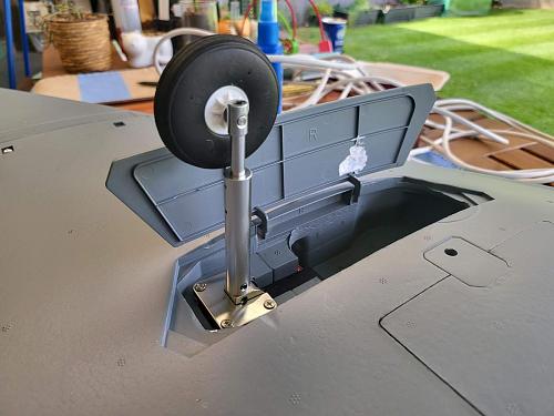

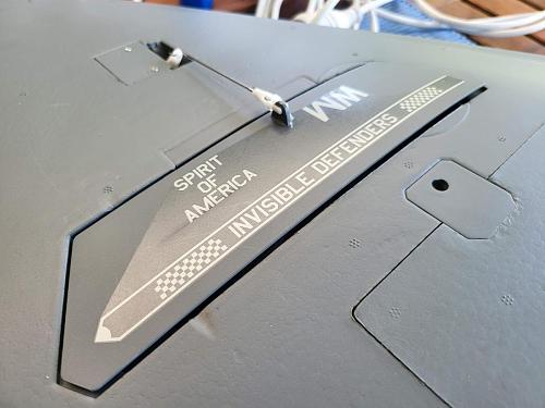

  • Originally posted by Aros View Post
    I am happy to report I have the perfect color match for this B-2. The guy at Home Depot NAILED IT. I can't even see where he put the test dab on the hatch. It's that good.
    Here's the lid..Click image for larger version

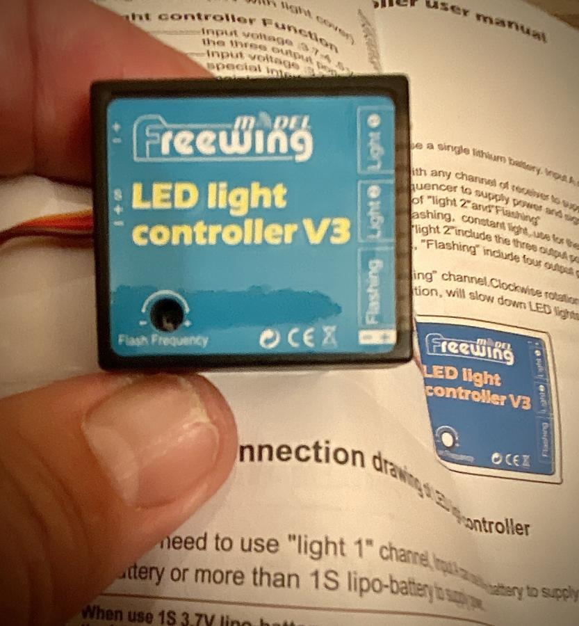

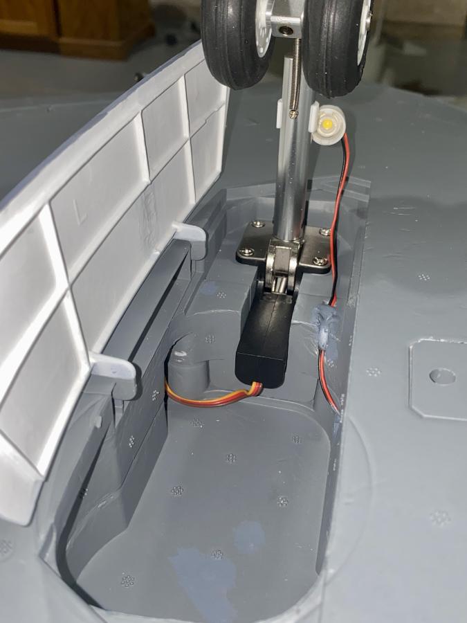

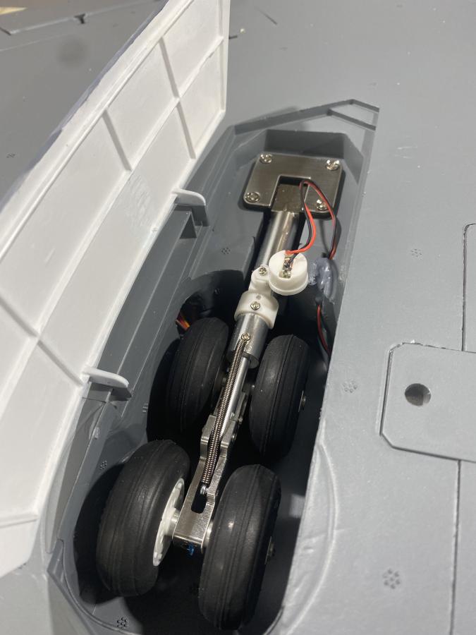

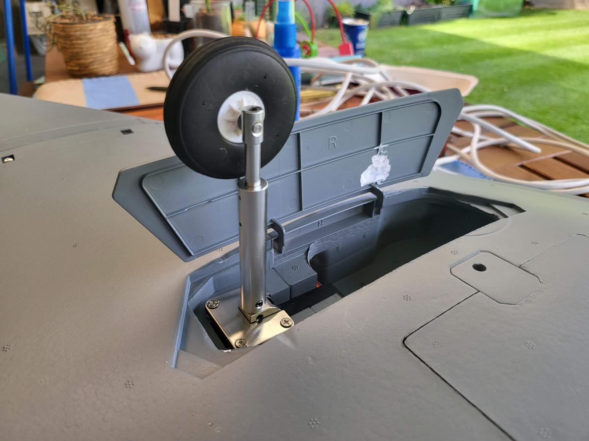

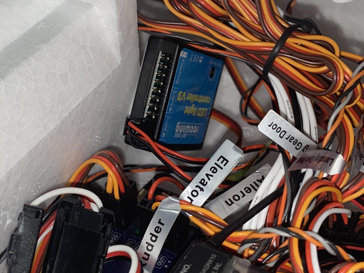

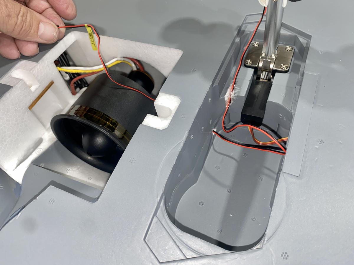

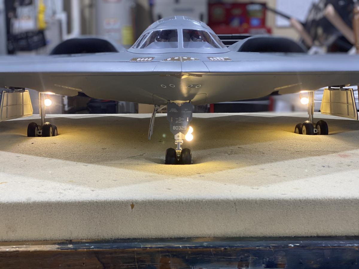

              • I was too windy to fly today, so I made a modification to my B-2 and I thought I’d share it in hopes that it can save you some time if you decide to do the same. I love lights and almost immediately decided that I was going to add landing lights to the main gear struts as soon as I purchased the B-2.
                Initially I bought and planned to use the same lights as on the B-2 nose gear, but that unit doesn’t fit the main struts properly, then I heard where avanti127 used the front gear landing lights from the Freewing PJ-50 and that worked very well with only a minor modification to get one side to mirror the other. They’re almost sized perfectly for the B-2 main struts and even include the machined screw needed to mount them and they’re only $4.29 each.
                ( https://www.motionrc.com/products/fr...41647263678649 )
                The trick was finding the best route to run the wires and I was able to do it by only making ONE hole through the side of the wheel well (only about 3/8” to get through the wall), then through the ducted fan area and up into the cabin following the motor wires where I connected the landing light leads to a Freewing light controller (from the F-15 90mm spar parts list;
                ( https://www.motionrc.com/products/fr...troller-v3-e02 )
                and set it up to be controlled on a spare channel. It would have been possible to use the B-2 control board, but I would have had to combine (solder) the connectors of two of the lights together to free up a connection port. I used the Freewing light controller because I also plan to add more lights later on.
                I’ll be happy to try to answer any questions. Now that I’ve done it once, the next one should go quite a bit faster. 😄

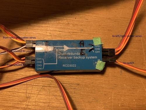

                • DRAG BRAKES .......................... Use of "buddy box" required to split rudder signal into two pathways. Need to splice into "red" wire of each ribbon cable bundle at control box. Drag brakes only for use during landing ground roll. Like thrust reverse, you DO NOT activate in the air. When drag brakes activated, drag rudders are defeated. Front steering is removed from control box and hooked up to Assan steering gyro.
                  Here is the "buddy box". Note that all leads may be 3-wired but only the signal wire is needed for splicing into the red signal rudder wire. The other two wires are simply cut short. The leads from the unused RX ports (can be AUX 1, 2, 3) use all 3 wires. One is assigned to any unused switch. The left/right rudder brakes are a mix: Switch X > AUX "a" and Switch X > AUX "b". Crank the throw as high as it will go as you watch the brakes open up.

                  • Originally posted by Mud Duck View Post
                    Initially I bought and planned to use the same lights as on the B-2 nose gear, but that unit doesn’t fit the main struts properly, then I heard about someone using the front gear landing lights from the Freewing PJ-50 and that worked very well with only a minor modification. They’re almost sized perfectly for the B-2 main struts and even include the machined screw needed to mount them and they’re only $4.99 each.
                    If you're at all handy you can make your own landing lights very inexpensively,
                    https://www.hobbysquawk.com/forum/rc...287#post344287
                    and I have a design and code for an Arduino landing light controller that is considerably less expensive than the FW controller, and which additionally will drive an afterburner too (not that the B-2 has afterburners).
                    https://www.rcgroups.com/forums/show...&postcount=592
                    • Originally posted by kallend View Post
                      Thanks! Your lights look amazing on your Mirage. 🏆
                      I can/could be “handy” and make my own, but I also like plug-n-play when it’s available, and in the grand scheme, I don’t see many of Motion R/C’s spare parts as being excessively expensive; certainly more reasonably priced than other R/C retailers. 😊
                      Maybe if I had my own 3D printer I’d be more inclined to fabricate these things myself; I’d have dual lights on the main struts instead of a single LED.
