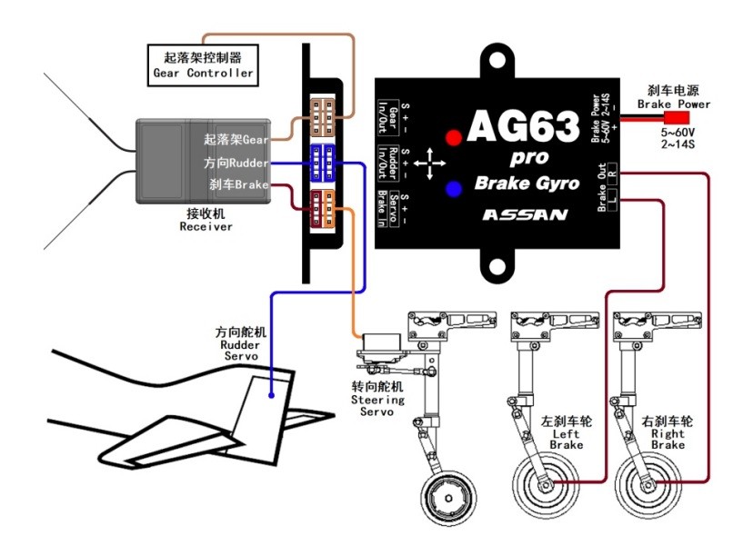

        AG63 - do you have brakes on the wheels?
        No brakes, just going to us the nose wheel steering output. I think the heading hold type AG63 will be better than the steering damping mode from the stock yaw gyro. I'll post pics of new wheels, repairs, and planned mods when I get them done. I will probably replace my current receiver with a Jeti Assist gyro receiver so I can independently adjust pitch roll and yaw gains. More mods TBD.

          AG61 has heading hold and costs less than the 63. The only advantage of the 63 is if you have differential brakes.

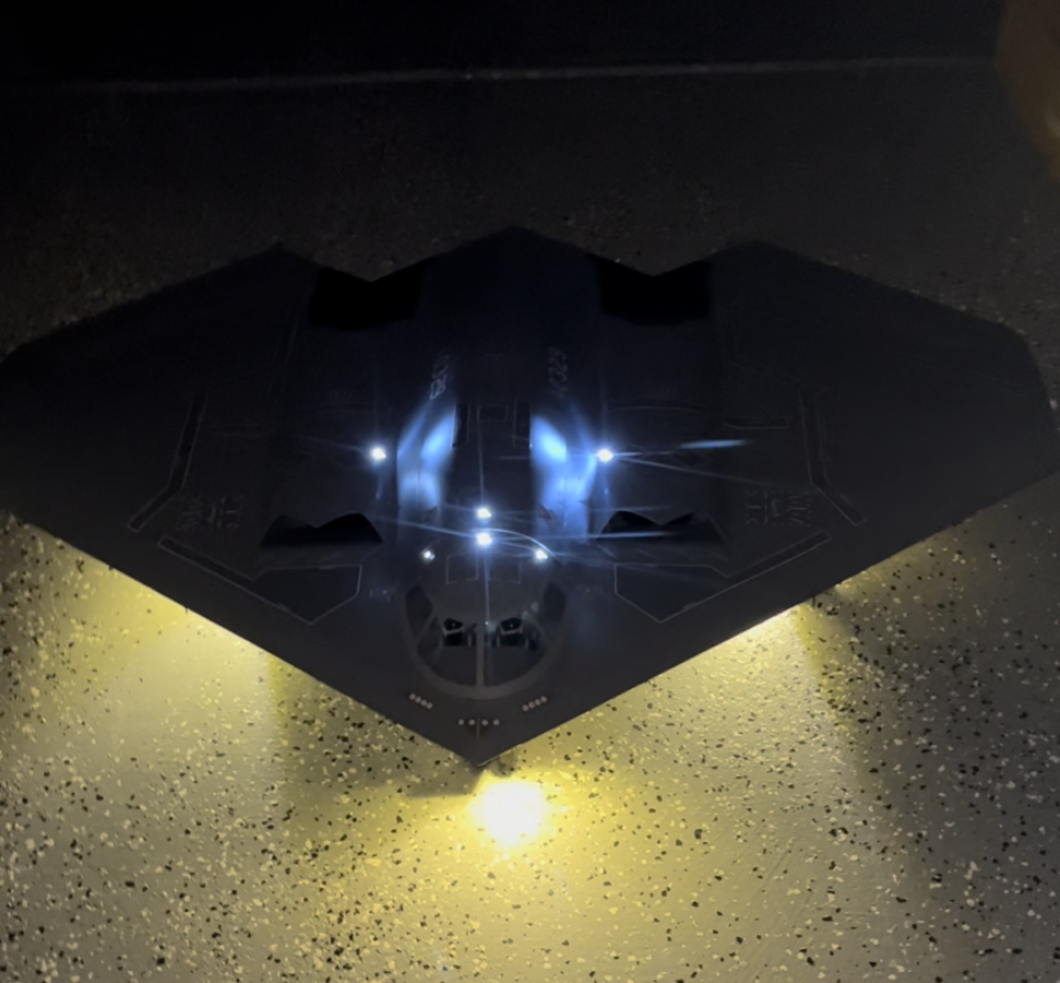

            In flight refueling lights. The real one and mine.
            Finally completed the mods I wanted to do so ready for test flying first nice non-wind day.
            Top lights are controlled via a separate channel so they can be turned on and off at will.

              Yep your correct. I've been using an AG63 in my F-16XL for a year now and it is great. I have another 63 here new and unused that I won as a door prize at a jet meet so I will just use the steering part of it in the B2. I drove out to the flying field today to get the leading edge corner of the left wing that got left at the crash site. Now I have all the parts back ready to glue back together and some 8mm carbon rod to replace the busted wing tube. Repairs starting tomorrow.

                    Love it! Looks awesome! Would be very interested in seeing how you did it. 👍🏆❤️

                      There are six lights on the B2 for refueling. I used six 3mm 3.2V LED in series, connected the power to a RC switch from 22.2 6S balance lead to drive them. I can supply a wiring diagram if needed.

                        I would really love to see a photo, especially of how you tipped the wires and mounted the PED’s. PM it to me if you prefer. No matter what, great job!
                        I was thinking of using 5mm bulbs on the forward part and two 8mm bulbs on the part that lights the fuselage. 🤷🏻‍♂️ Biggest concern is mounting them in a way that still looks good when not lit up. 🙂

                          5 & 8mm are to large and not necessary. The 3mm LED's have a lot of light as you can see.
                          I laid out my locations per the real plane and mark and drilled them from the outside in. Once I had the wiring completed I inserted them from the inside to the outside. The top of the bulb is just slightly above the surface and you can barely notice it and are really nicely hidden. From 4ft away you don't even see them until you flip the switch.
